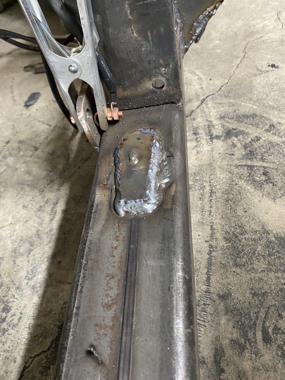

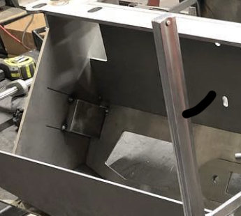

    Since it’s a tube, I just cut out a hole on the front and back of the tube. Welded it on each side. Then I added a 1/4” plate laterally and welded that all around just because I realllly don’t want this thing moving. It’s ugly but it’ll hold. Probably.
    For the front you pass it through on the corner, so that way you can weld it on the front side, and all around the perimeter on the inside.

    You sure about that? If you ever saw the video I saw, you might think twice. Dudes cab was bisected.

    Down the middle, vertically. I think it caught his ear too IIRC.

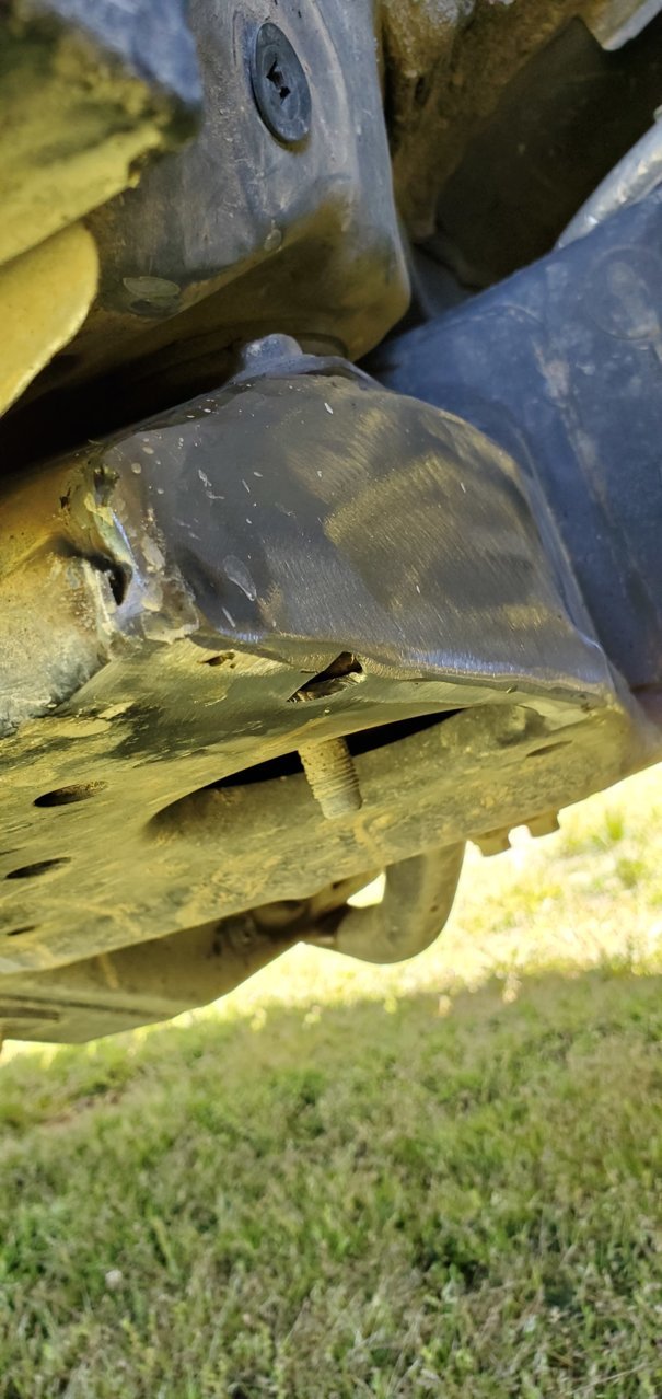

    You said, and i qoute "If you call me before you get stuck I will keep it from happening". Didnt say anything about once i am stuck.

    :rofl::rofl::rofl: based on the pic you showed me of one of your "adventures" you need an exorcism! :devil:

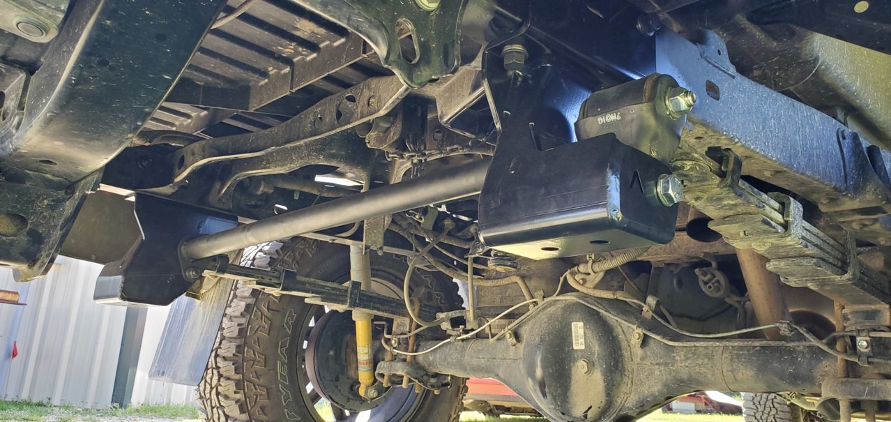

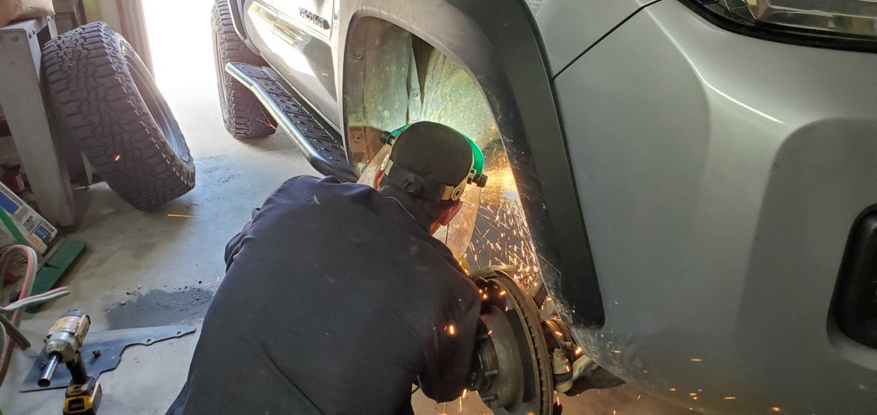

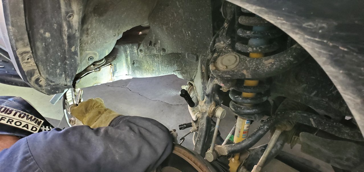

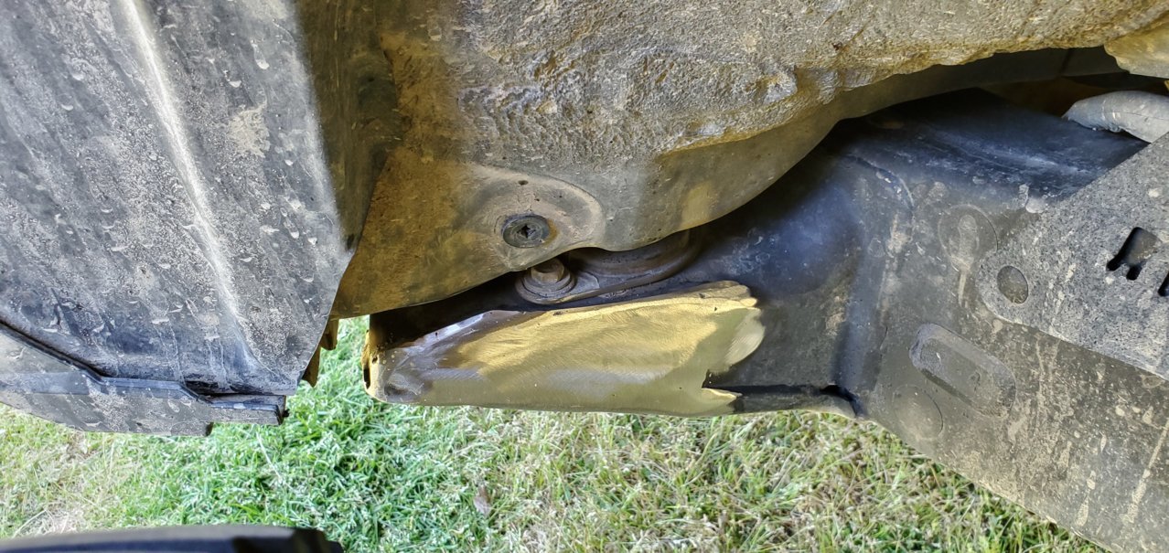

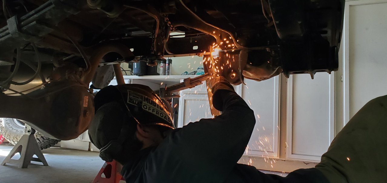

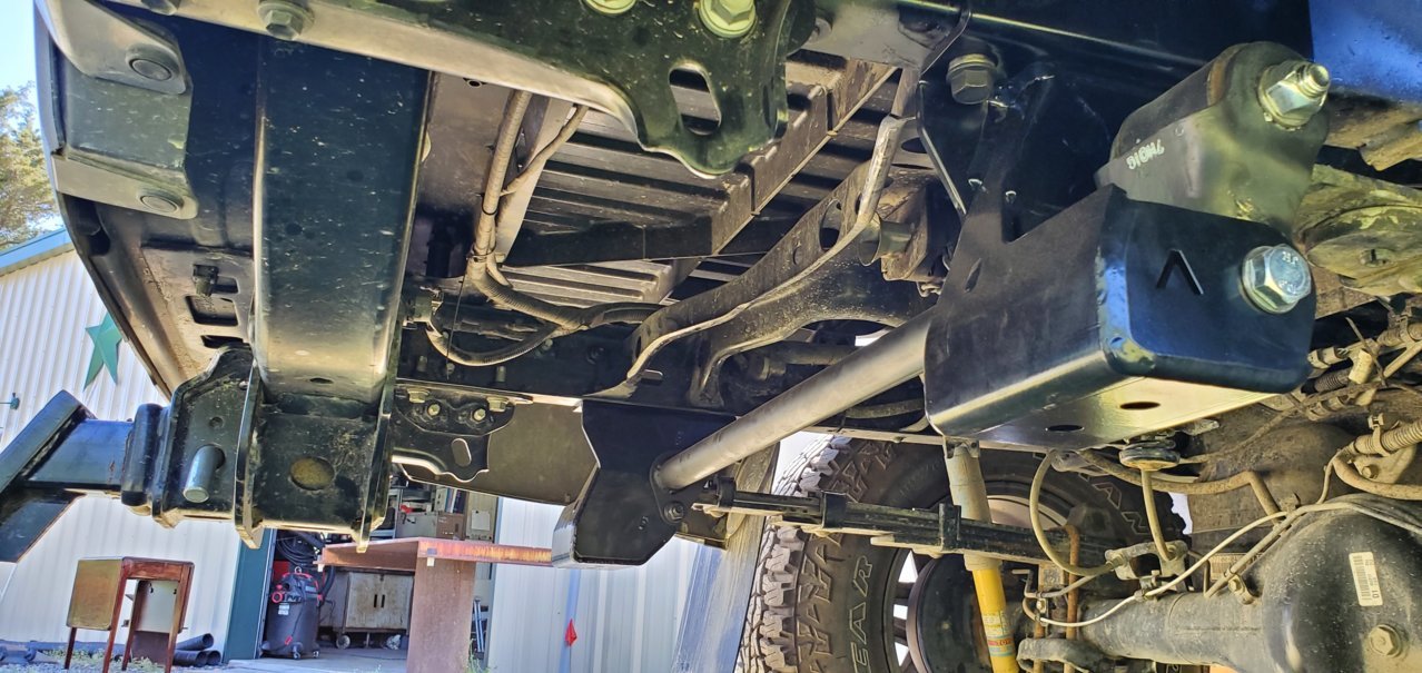

    #randyfab'd my taco today:
    CMC
    Archive Garage HH (stock shackle and leafs)
    ECGS bushing
    Edit Update:
    CMC with tapped hole for rok blockz anchor spot...paint job pending20200510_155454.jpg 20200510_155433.jpg 20200510_155407.jpg 20200510_155354.jpg
