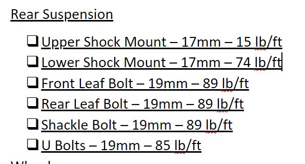

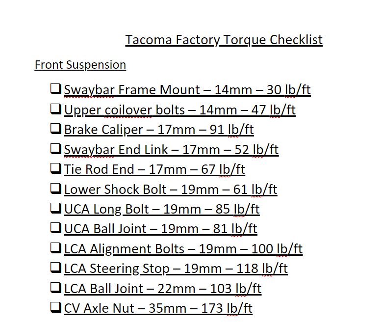

    It's been a hot minute since I've wrenched on a stock truck. Can anyone confirm these socket sizes?
    Ones I'm unsure about are
    • Tie Rod End
    • Lower Shock Bolt
    • UCA Balljoint
    • LCA Balljoint
    • Rear shock, upper mount

    19mm sounds right for the lower shock iirc.
    I want to say the UCA BJ is smaller but I can't remember. I want to swap my spindles out this weekend so maybe I'll remember to let you know.
    I want to say the LCA BJ is smaller too but again...
    17 sounds right for the rear shock.

    I ended up watching some install videos to figure it out.
    TRE - 19mm
    LCA BJ - 24mm
    Rear shock upper - 14mm
    Lower coilover - 19mm
    UCA BJ - 19mm
