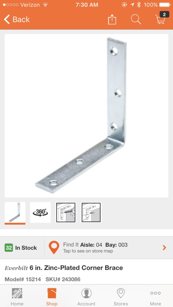

    After thinking it over, my design wouldn't work for you. Since the light bar won't be wedged into the valence, it'll probably shift side to side. Here's what I'd do instead.
    I would get two of these l brackets, and use two set tapping screws on each to attach it to the crash bar. Then I'd use a nut/bolt to attach the light bar to that.
    You'll just have to trim the bracket a little to get each edge the correct lengths, but that's not too hard.
    This is similar to what I did since I also just used self tapping screws, just modified a little.

    Much appreciated man!
    So if I attach it to the crash bar by itself...it will sit flush with the front bumper?

    You should be able to choose where you put it on the crash bar to determine how far back you want it sitting.
    I may also be full of shit, since it's been over two years since I've done it. I'd recommend taking my suggestion and going and poking your head behind the grille. Then you can see if it'll work or not, or if I'm totally off in my in head measurements.
