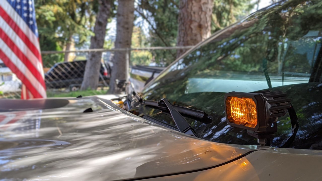

    Just got my ditch light brackets and now comes the part to decide what lights to run.
    I've got the Diode Dynamics SS3 Pro's in selective yellow for fogs and they have been nothing but stellar.
    Having said that I'm contemplating whether or not to go with a pair of SS3's or the new SSC2's. Goal is for clear lens on selective yellow variant for a warmer white.
    Also, what pattern would you choose?

    If you don't mind the look of the larger form factor on your A-pillar just go SS3! Or if you're dead set on the backlight function then SSC2.
    Driving pattern all day on the ditch light :thumbsup:

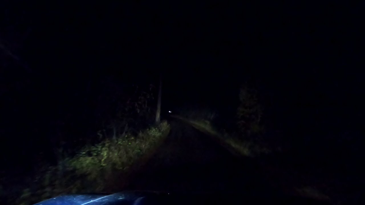

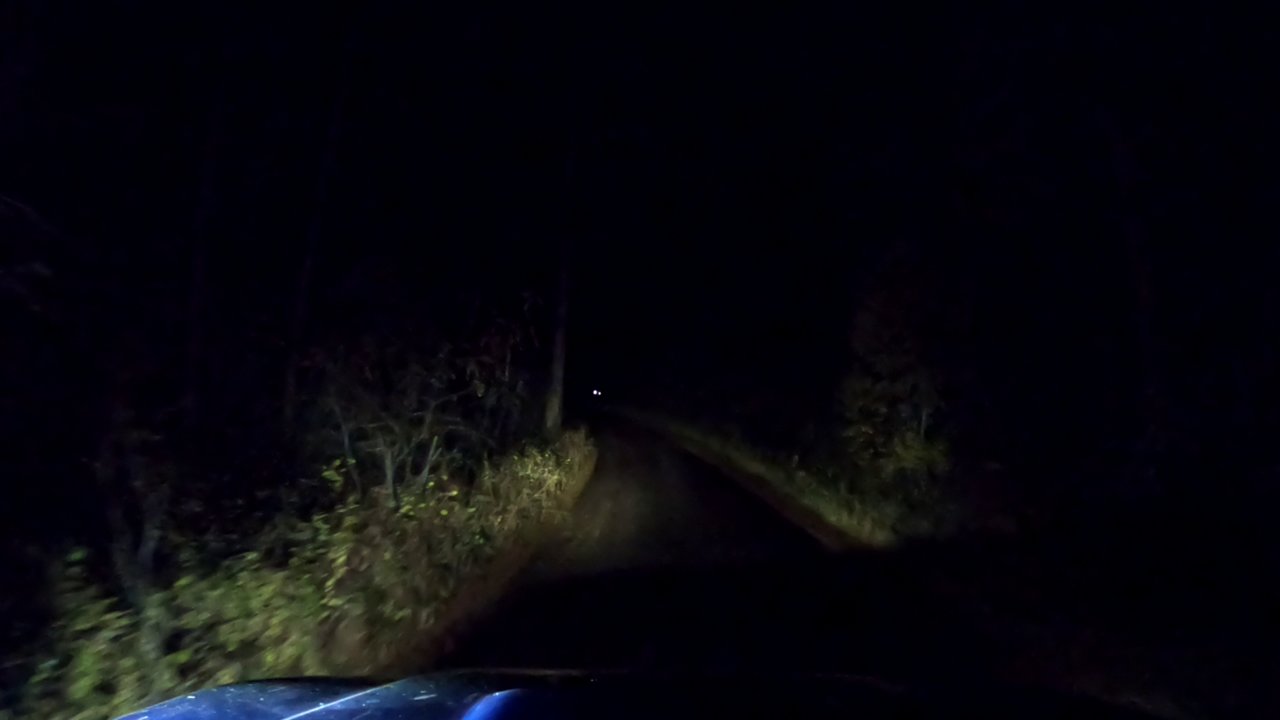

    Thanks brotha! I know I am slow to production, but I'm working diligently on all of it for y'all! Here's a sneak peek... Take into account that this was all filmed immediately after a rainstorm which soaks up a TON of reflected light that you'd normally notice off of the road and gives a bit of extra credit to the longer wavelength of the S2 Pros. The camera doesn't pick up the flood aspect of the SSC2s either (this was a combo pattern), but it was absolutely present in person. Take note of the distance that you are able to observe though for this snapshot.
    Here's a sneak peek :D BD's are the "warmer" light (driving/combo on these) in the bottom pic.
