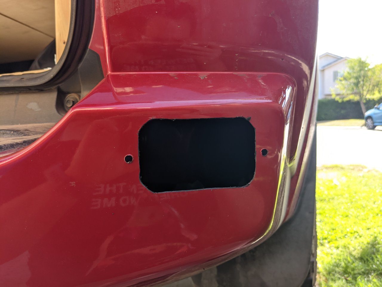

    Yeah I think so too. Cutting these out was a pain. PXL_20210910_164738127.jpg

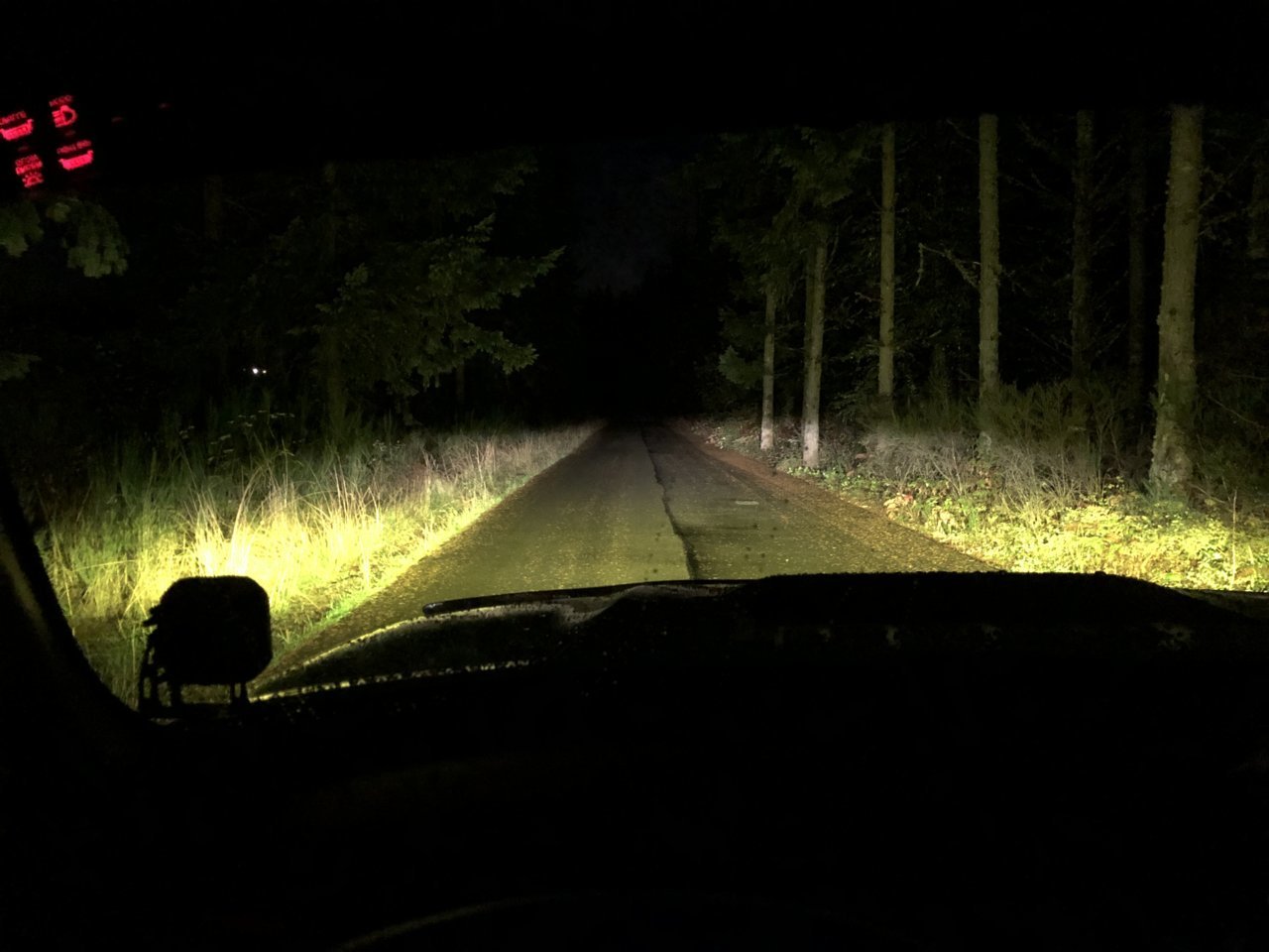

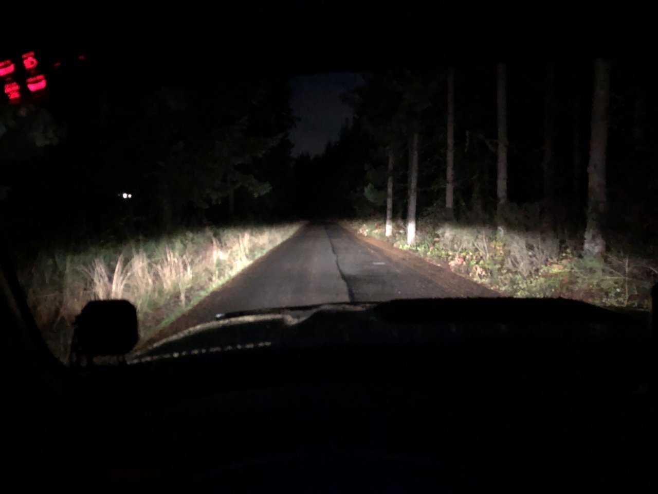

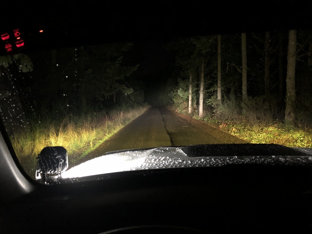

    Found a super dark area to somewhat showcase the H9 bulbs in low beams, SS3 MAX fogs, and Selective yellow SS3 Pro’s with clear driving lens.
    Perfect for backroads
    Keep in mind my iPhone X auto adjusted the ISO and most accurate representation is the 2nd picture for the low beams
    *Note: Hood glare is not as bad as shown*
