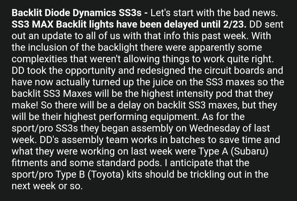

    Welp, who wants a pair of Pro's so I can get 4 of these? LOL
    I'm curious as to how bright the backlit modes are during the day for rearward facing options.

    Glad I opted for the regular SS3 yellow max's then. They're plenty bright. :cool:

    I have SSC2 sports (4000K) in the rear bumper with the amber backlights tied into the turn signals. They're bright enough to see but have a kind of checkered pattern on the wall behind them, it's not a smooth spread like the main chip in the flood optic. I'd consider it maybe as a dim area illumination, but barely adequate. The kind of lights you'd turn on if you were showing up late to a drive-in movie.
    Edit: I see you said " during the day". They're bright enough to see but certainly not focused enough to replace a turn signal light. I can definitely see my taillight signals further away than the backlights when I click my fob to lock the truck.
