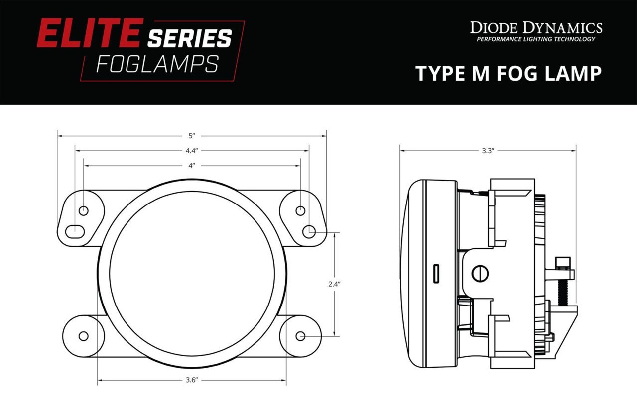

    Have you measured the clearance around the fog bucket on your slee surround? You might be able to use the elite type M if you're willing to put 4 mounting holes in it.
    492194A7-F2FB-4F23-93F3-A394C34D6427.jpg elite_series_type_m_fog_lamp_dimensional_drawing.jpg

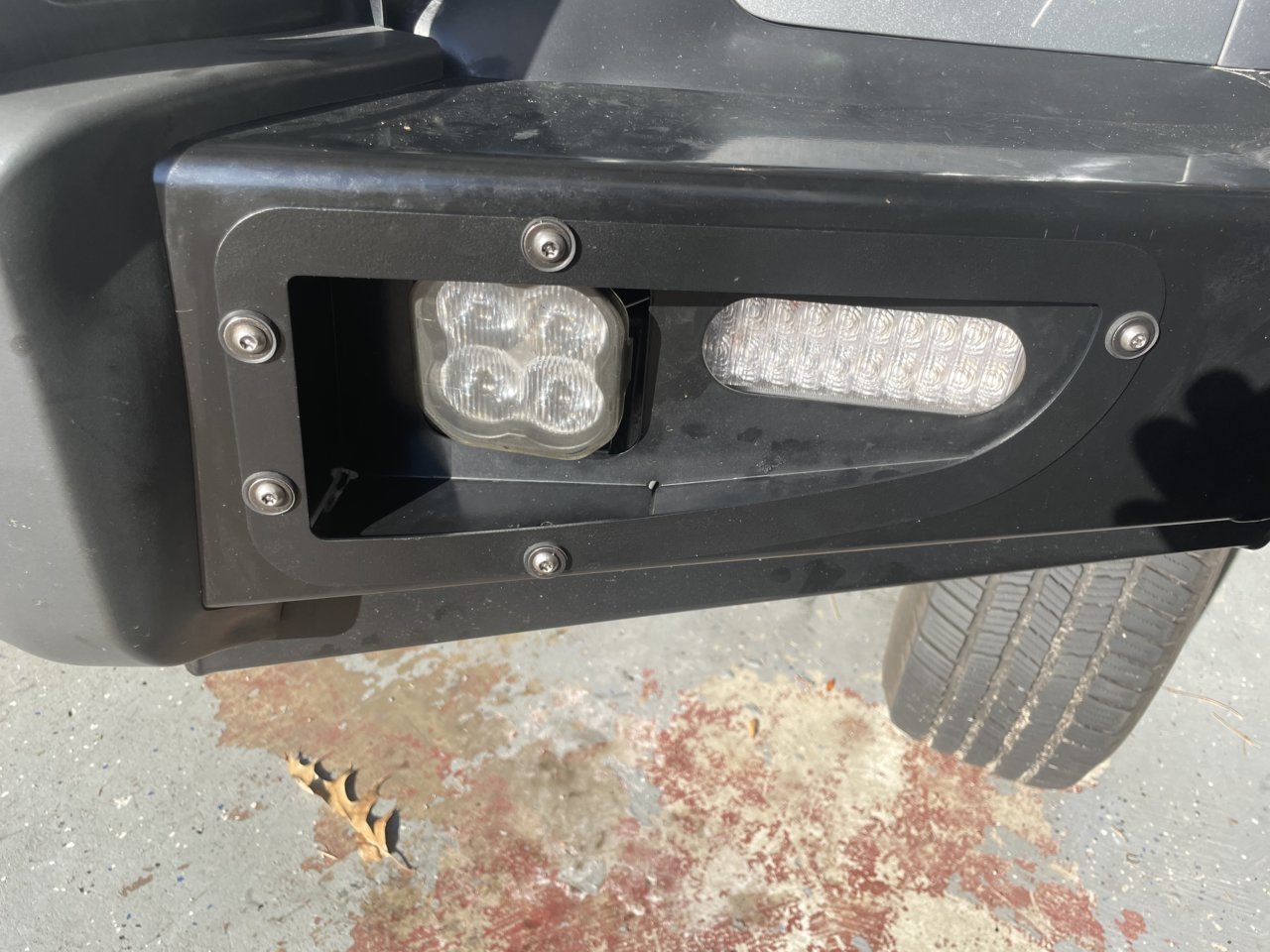

    It looks like I have about 4 1/4" vertical clearance total, so drilling holes for the Elite might be possible. It'll end up a little walleyed, with the fogs pointing outwards from the direction of travel, but I don't see that being a huge problem. The ability to easily fine-tune the elevation would be worth it alone.
    I need to revisit @crashnburn80's review to verify that the Elite fog lamps have a light intensity gradient, and not just a color temperature gradient.
    I know fog lights are meant for a specific purpose, but I have to agree that they work well for my needs too. I'll take whatever help I can get staying in my lane, and maybe lighting the way so adjacent drivers stay in theirs.
    It looks like these have been discontinued, just as every other aux low beam/SAE J582 product I've found. A shame, since I think there's still a valid case for their usage.

    What function is the other light in the surround? You might be able to use a snowplow light like JW speaker for a true low beam. But as much as I looked into the 9800 and 9900lp I couldn't find any output shots.

    It's a combination turn signal/side marker light. I have looked at other lights to use in that location, but have come up dry.

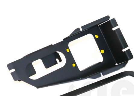

    I just took additional measurements for the fog light insert. The square cutout is 3.4" tall, which won't allow the 3.6" diameter Elite foglights to clear. Looks like those are off the table as a minimum-modification option.

    The Slee foglight surrounds I have in my ARB bumper are designed to accommodate a standard ~3x3" LED pod, mounted via a single bolt through a U-bracket. I'm willing to hack them up if I find a truly outstanding fog light that is otherwise not compatible, but I'd like to exhaust my LED pod options first. Link to Slee's product page:
    https://sleeoffroad.com/products/sok0049/
    An interesting idea that I'll certainly keep in mind, but it will be pretty far down my list of options due to the time- and cost-intensive nature of getting the work professionally done. I don't think I'll ever be brave/drunk enough to attempt a retrofit myself.
