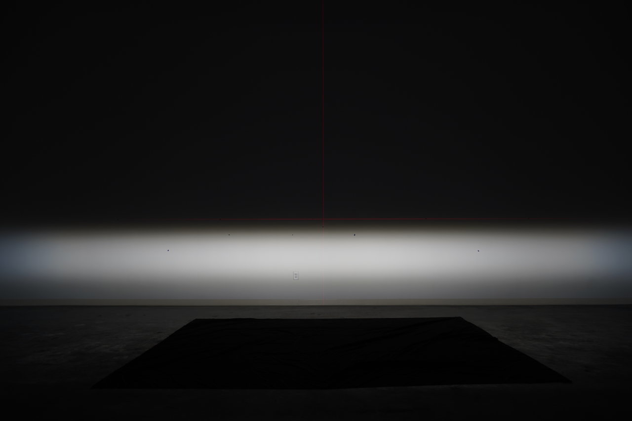

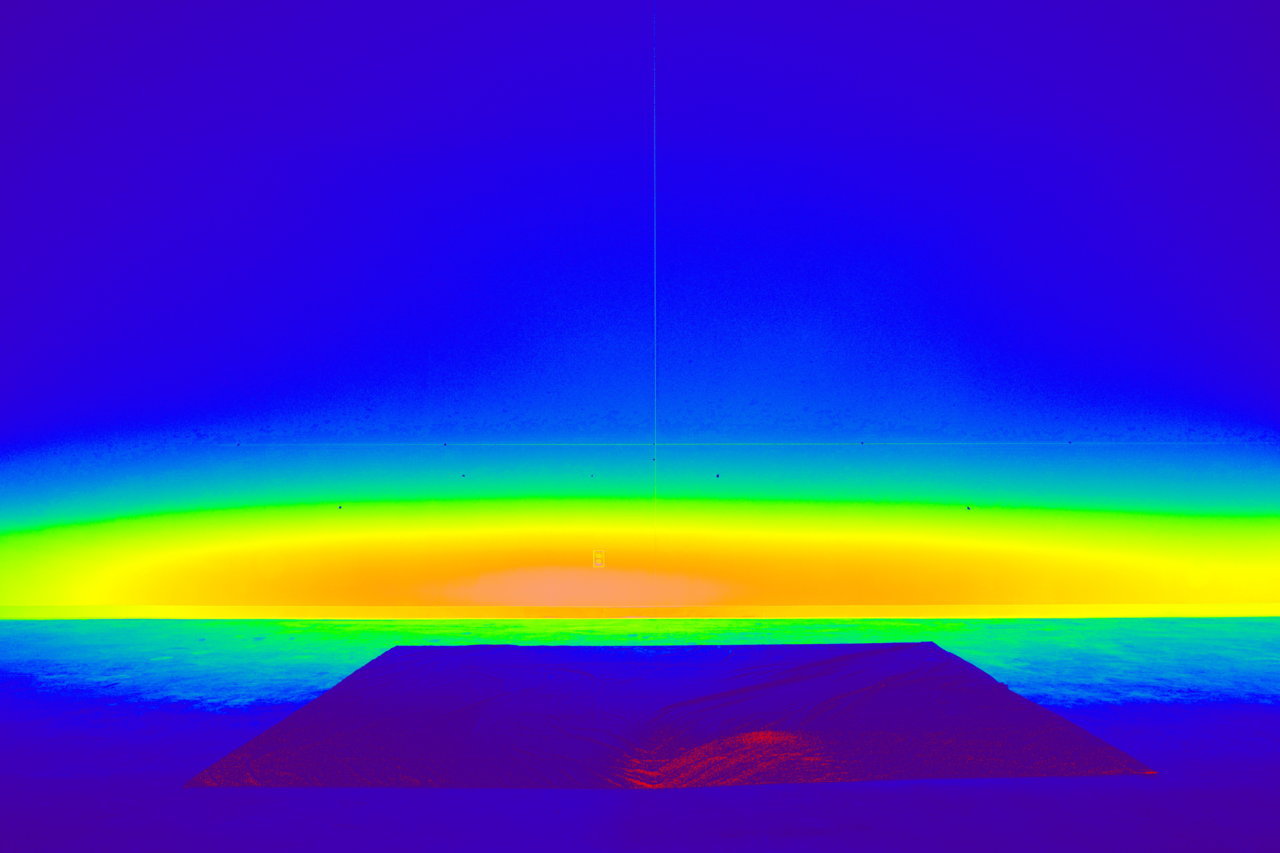

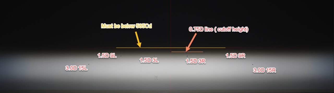

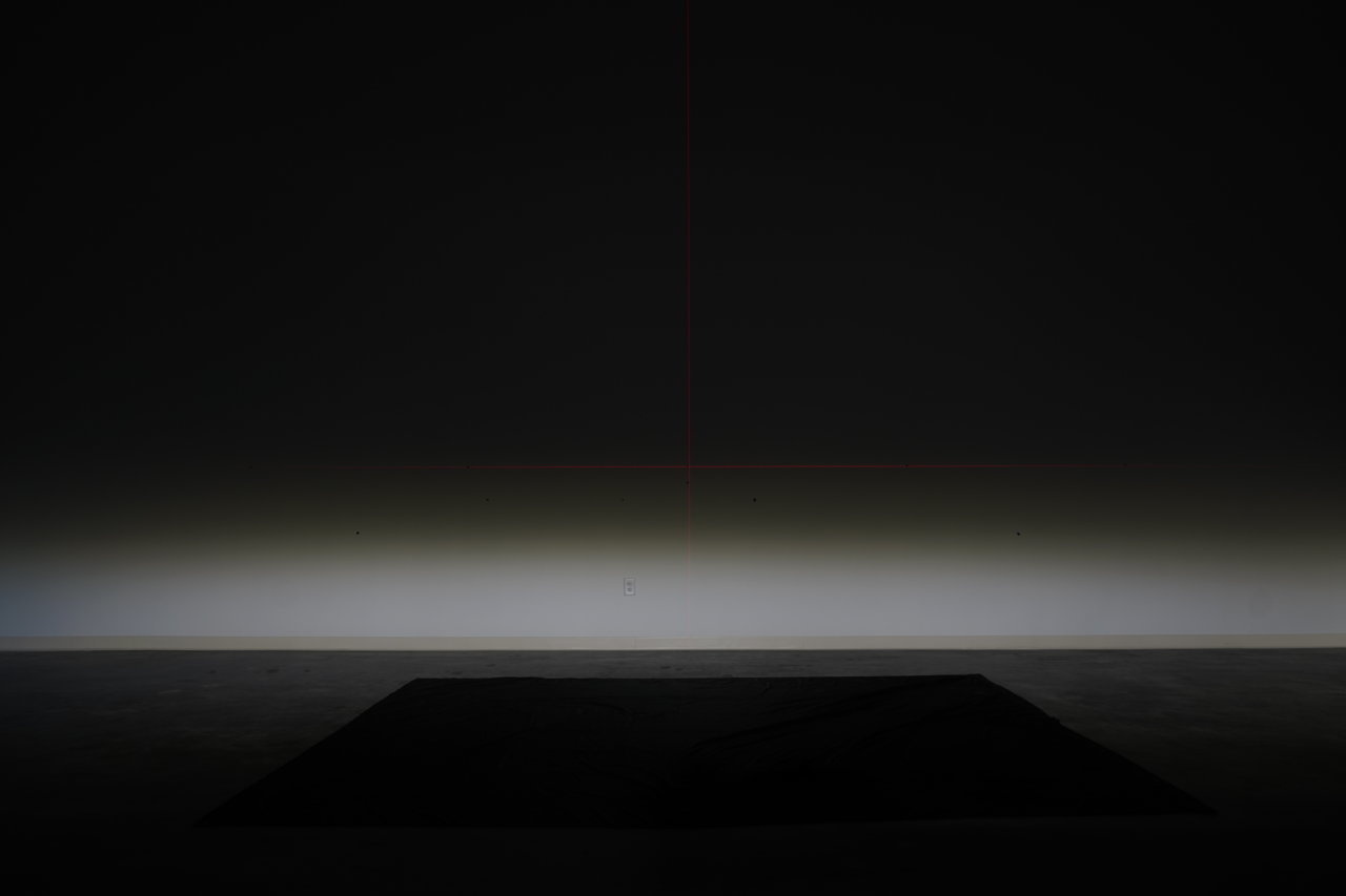

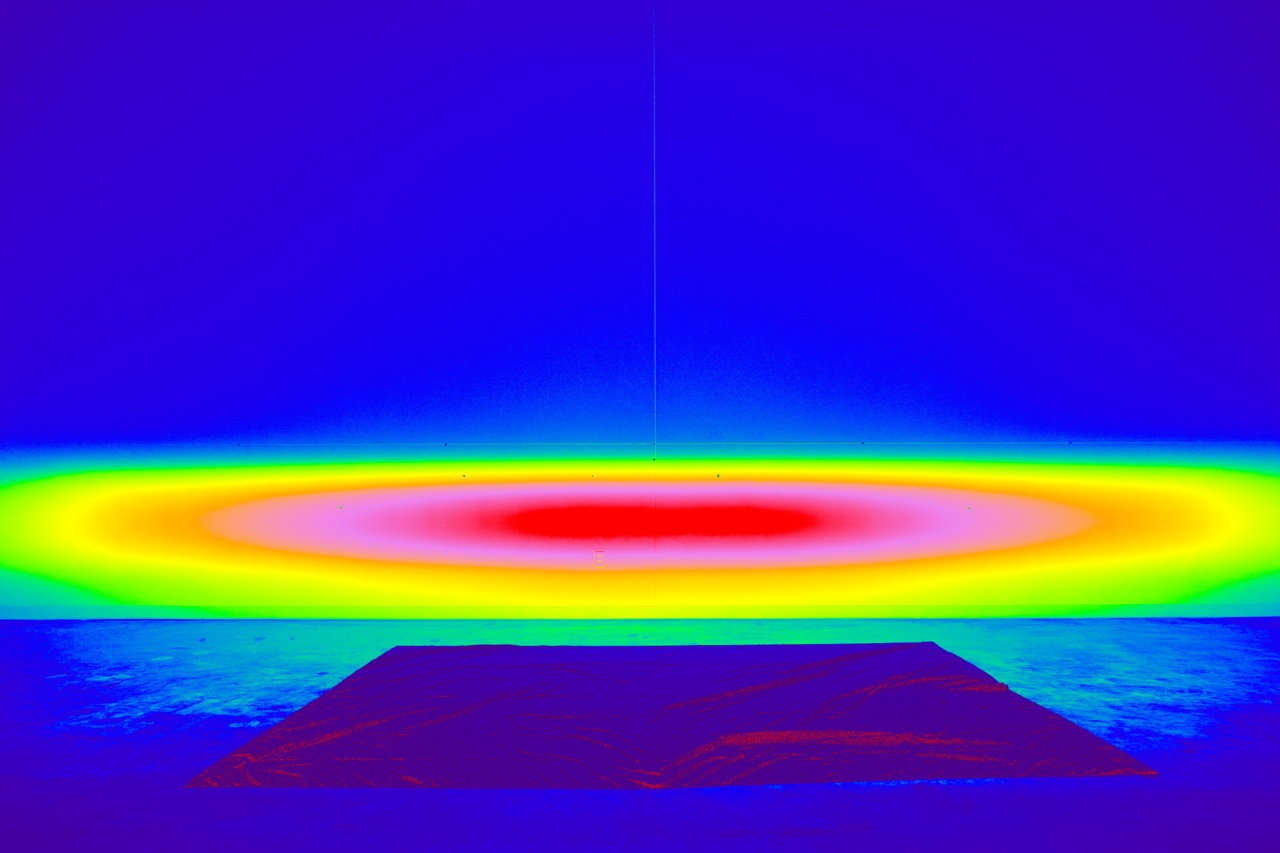

    2B HXB wide and C2 Pro Fog output have significant performance difference when used as fog lamp.
    1/2/4Banger wide beam isn't wide beam end to beam end on the wall, but it does carry meaningful reasonable beam width as SAE Fog lamp, where it contribute to driver near field width illuminance.
    I am not saying it has optimum width though!
    Personally, I still insisting to call 1/2/4 Banger wide beam, not fog.. Not sure how marketing will call it, but to me it still is wide beam that is capable of handling fog role.
    I made some improvement ( more like package size allowed bit more desirable config, slightly larger TIR optics and less reflector overlap) on questioning cutoff quality of 4Banger with 1 and 2 Banger this time for fog lamp usage purpose.
    Anyways,, When lamp are aimed properly as SAE, 2B HXB wide does have more meaningful width to my comprehension based on test points that has minimum requirements.
    This take some explanation, hope I can visualize well below.
    I think it's been so long, so many failed to understand proper SAE F function fog beam, people using fog lamp wrongly giving false impression of what is actual meaningful width as fog beam.
    I must also agree, it is not much benefit to have this regulation upper limit level of illuminance at peak, it is very much covered by low beam lower angle beam coverage.
    Point is,, I do feel like very important part of discussion is being dismissed for long time in this SAE thread, is G( Gradient max)= Cutoff criteria
    @Diode Dynamics
    Has it ever been officially checked G max criteria? Looking at beam, there is no way to tell where the cutoff line is. Particularly Pro was very poor.
    I did see SAE Fog lens now has angled exit source, so at straight aim when bezel front flat parallel to aiming wall, beam will naturally lower by few degree. Admiring attempt on this, this allows less downward aiming requirement compare to SS3
    Data sheet doesn't show G max, nor F function table. IsoCan is not aimed as J583 too, I am afraid C2 Pro may not be OK to label as F fog.
    Subject never got discussed enough to have any validation, unless I miss learning so. Please advise.
    Below isn't photometric test by official third party lab yet, but from my careful observation, reasonably fair comparison I have conducted. Review as individual level study.
    My study is strongly suggesting C2 Pro also will not likely satisfy SAE F function due to cutoff criteria, same as SS3 Pro, it must be aimed lower largely to use as fog lamp without glare limit to exceed
    And I have concern that this cause 1.5D 9L/R may not be not bright enough as J583 table itself.
    Essential 1.5D 9R/L point likely become very weak as fog lamp.
    This is T=30min mark comparison of 2B HXB Wide vs C2 Pro Fog
    2B HXB has improved cutoff quality and easier to aim per SAE gradient criteria of 0.75D aim.
    2B HXB Wide 0.75D ( aimed by Cutoff, H 10L-10R max 500Cd ish)
    Here is C2 Pro Fog ( No visual cutoff, aim is done so H 10L-10R won't exceed 585Cd per SAE F function requirement)
    beam center floor bounce are prevented by baffle board, measurement should be reasonably accurate.
    2B HXB Wide gradient mapping
    C2 Pro Fog gradient mapping
    These are the main basic point being assessed per SAE F function ( some upper angle limit is not drawn below)
    And,,, I am sorry, 1.5D 9R mark tape fell off!!!! but mirror the point from 9L
    Go back on wall shot image, and look at test points mark, this is what I meant by
    When aimed as fog lamp ( Pro couldn't be aimed by cutoff, so it's really not fog aim, but aimed in the way it won't cause glare to others), critical immediate road edge width illuminance zone is much weaker with C2 Pro Fog in my observation.
    This does NOT apply IF lamp are used as offroad wide beam. Wide beam usage, Pro's width provide high comfort.
    6inaRow and Toy_Runner like this.
