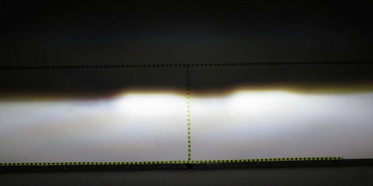

    Hey all - I wanted to share this video to the thread because it basically explains the progress of SAE Fog development over the last few years, and why various brands have traded off the "best performance" title. It comes down to simple technology advancements. I made this video because it's very difficult to find concise information about this online.
    To tell the story - previously, projector (JW Speaker) or hybrid (Rigid) optics were all the SAE Fogs that were available with the off-road style.
    Some brands promoted simple forward-facing reflectors for use in fog applications, but forward reflector optics by definition cannot focus all of the light coming out, so they inherently have glare. It is impossible to make an SAE forward-facing reflector LED pod.
    Some reflector pods like the KC G4 are half-bowl reflectors, to avoid that problem of glare. However, it's still difficult to control all of the light, and I believe that's why you haven't seen this style done with high-power (40W+) emitters.
    Finally, TIR optics, as we at Diode Dynamics pioneered for SAE fog applications, allow for greater efficiency than projector optics, with good cutoffs and beam patterns. However, they are more difficult to design and produce. The pattern may also not be quite as "pretty" as a projector-based system, with super razor-sharp cutoffs and homogenous spread, although TIRs continue to improve in this regard.
    Thanks for watching (or sharing), and happy to discuss or answer questions!
