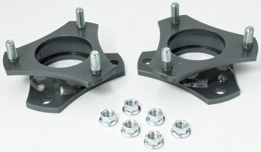

    • Spacer Lift:
    Spacer Lift - This is one of the cheapest and controversial ways of lifting the front end. Spacers mount between your strut and strut tower. They come in various sizes but usually the max for our trucks is a 1.5" spacer that gives you 2.75" of Lift. Most companies advertise their respective products as a 2.75" lift so don't be alarmed when the spacers that show up are only 1.5". There is also a true 3" lift sold by various sellers.
    https://youtu.be/7w_Hg8JoKLY
    Available Products:
    Fat Bobs: http://4x4.fatbobsgarage.com/toyota-tacoma-2wd-5-lug-275-front-lift-kit-2005-2017-p7630.aspx
    ReadyLift: https://www.readylift.com/2-75-sst-lift-kit-toyota-tacoma-5-lug-2005-2018.html
    Pro Comp: https://www.amazon.com/Pro-Comp-65660K-Suspension-Tacoma/dp/B005GDZQYQ
    True 3": https://www.ebay.com/itm/Steel-Front-3-Leveling-Lift-Kit-Toyota-Tacoma-5-Lug-2005-2017-2WD/332296074485?ssPageName=STRK:MEBIDX:IT&_trksid=p2060353.m2749.l2649&rmvSB=true
    Notes: You will need a spring compressor to install any front spacer lift. Most local auto stores will rent them out.

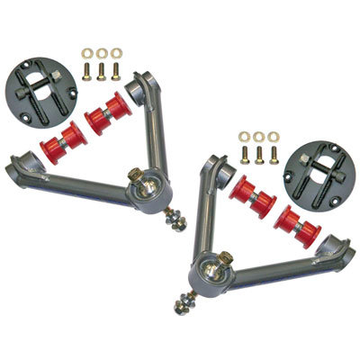

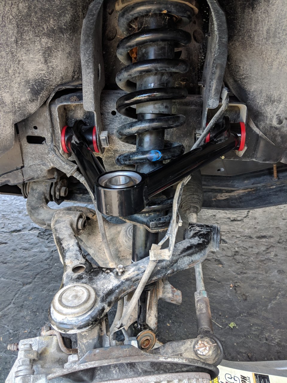

    Aftermarket Upper and Lower Control Arms:
    Total Chaos UCAs - The TC UCAs are now a rare find since being discontinued. If you manage to get your hands on this kit you can use these with aftermarket coil-overs to have more of a mid travel setup. Lift will vary.
    Notes: Icon Vehicle Dynamics 58605 2.5" Coilovers 0-2.5" lift are now discontinued so keep that in mind. This was the only coilover to be used with the TC setup. There is no current replacement to this coilover on the market.

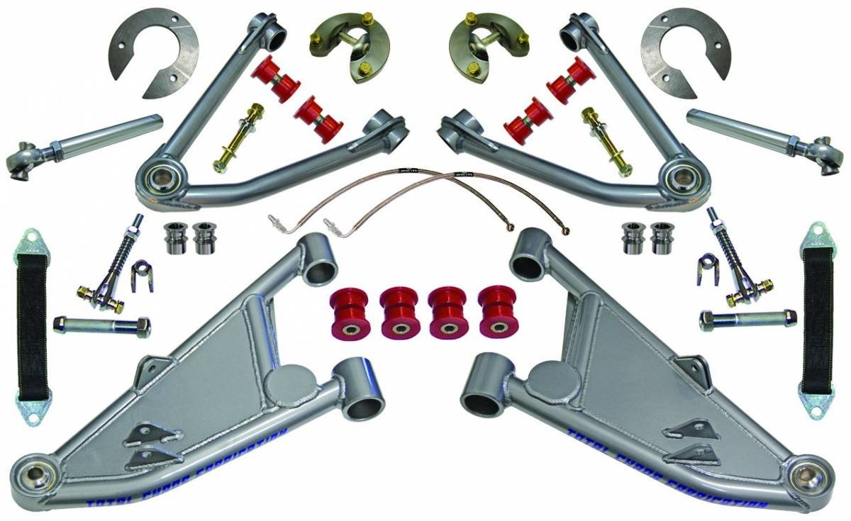

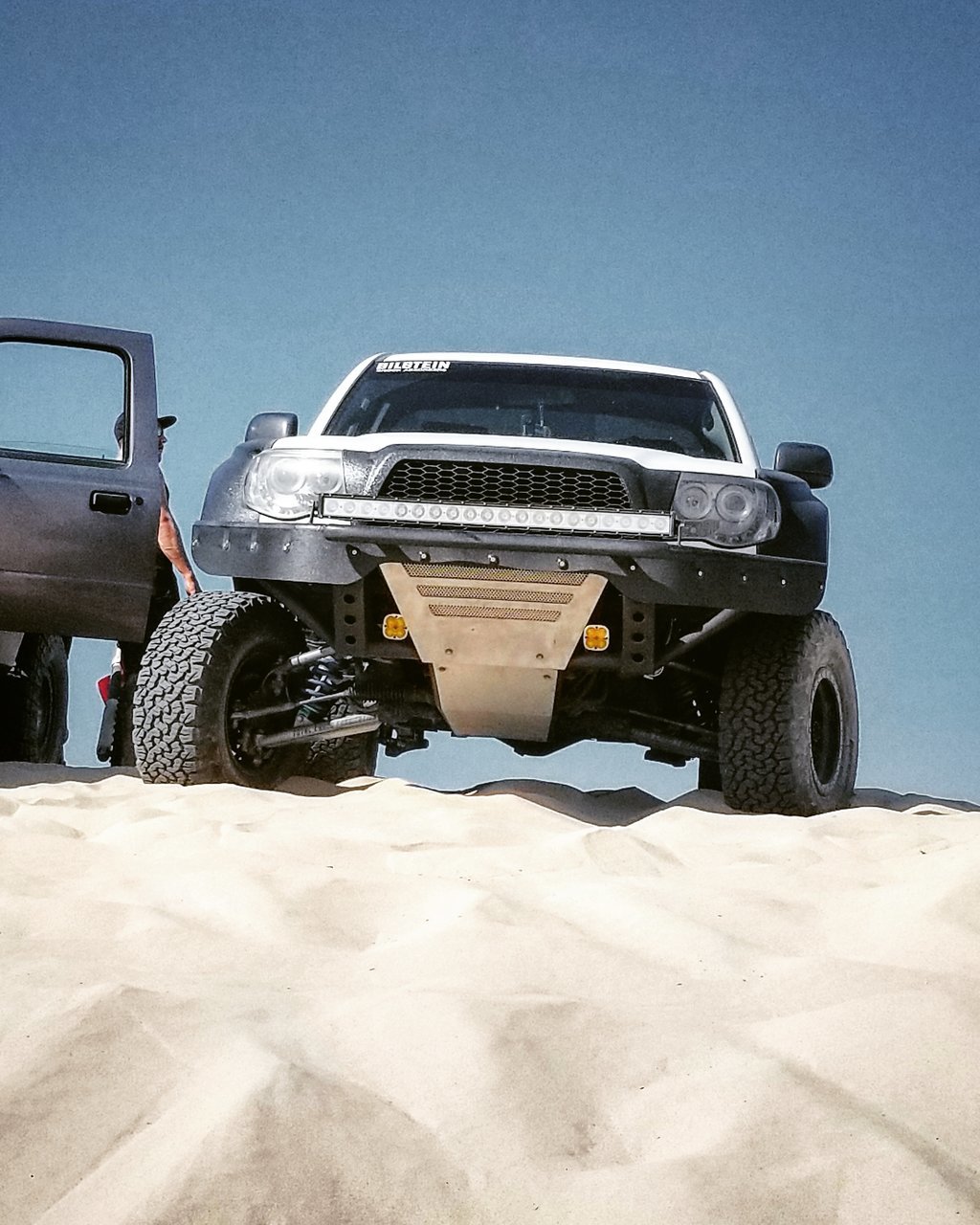

    Total Chaos Taquito Long Travel Kit - The holy grail of our 5lug models. At a price tag of $3k this kit will get you 13" where it counts. At this time, this is the farthest you can go without extensive fabrication.
    https://www.youtube.com/watch?v=50rwpVi_5rU
    https://offroadwarehouse.com/i-11651862-total-chaos-05-5lug-taquito-long-travel-kit-saw.html
    Photo Credit: stupid hurts.
    American Motorsports LT - The kit will get 18-20 inches of wheel travel depending on if you use a 10 inch or 12 inch coil overs also a bypass shock will fit right next to the coil overs inside the upper arm. The kit is 6 inches over stock and depending on your wheel offset it will put you around 90-93 inches wide. The kit includes 2-upper control arms, new upper control arm mounts, 2-lower controls arm, 2- spindles, full heim steering with clevis and all hardware needed to bolt the kit on. Coil overs/bypasses are not included with the kit. The kit cost $4000, new fox coil overs with coils $1450, new fox bypass shocks $1750 fox bump stops with cans $525.

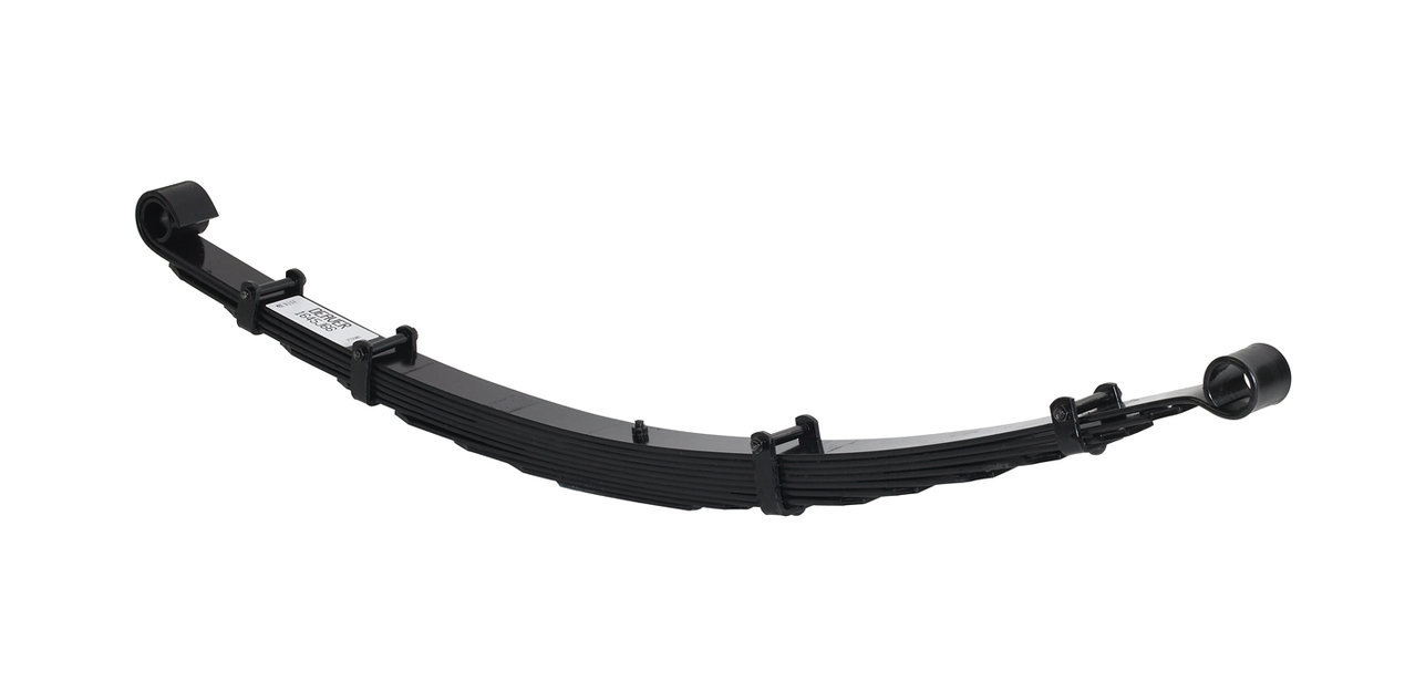

    • Add a Leaf/ Leaf Pack:
    AAL(Add a Leaf) - This requires you to add an overload leaf between the leafs in your leaf pack. There are various AALs out there so lift will vary depending on which you go for.
    Available Products:
    Fat Bobs: http://4x4.fatbobsgarage.com/toyota-tacoma-5-lug-rear-add-a-leaf-lift-kit-2wd-1995-2017-p7921.aspx
    Icon: https://offroadwarehouse.com/i-1016...urrent-toyota-tacoma-00-06-toyota-tundra.html
    Aftermarket Leaf Pack - This will replace your factory leaf pack on your truck and add lift depending on what product you go with. This can increase your load rating as an added benefit.

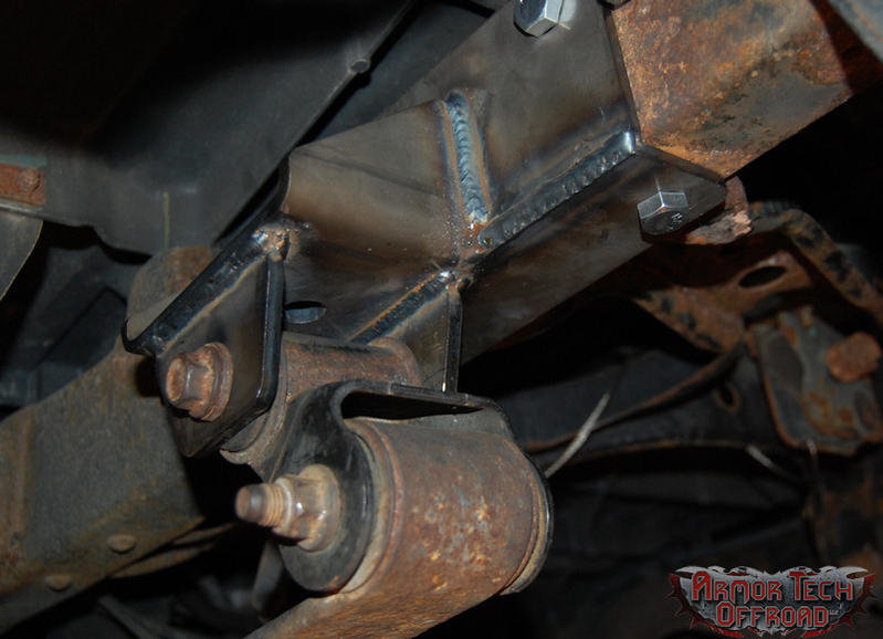

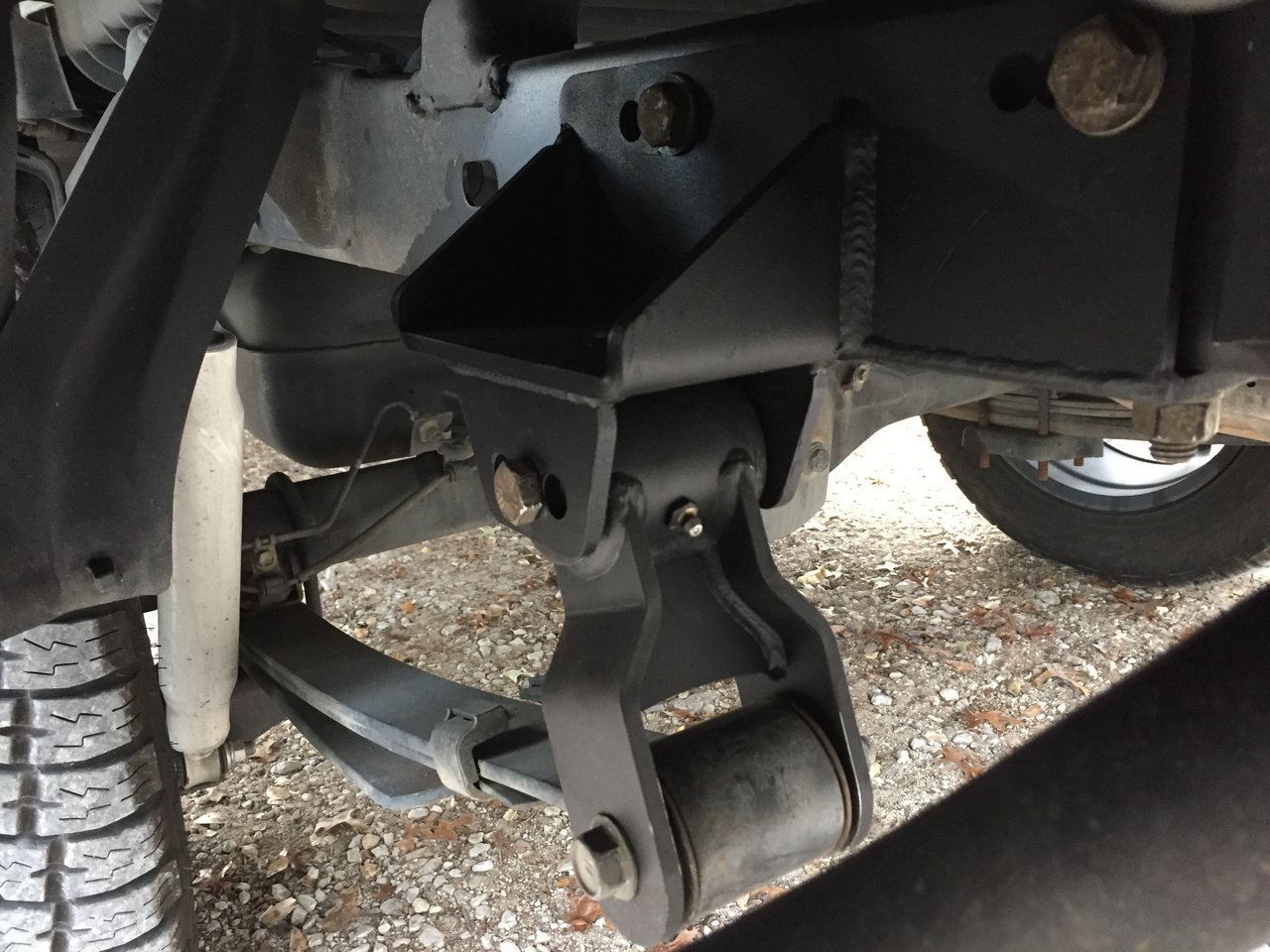

    • Shackle Flip Kits/Shackles:
    Shackle Flip Kits - This will give you roughly 1" of lift and most kits will require you to remove the existing shackle mounts.
    Available Products:
    ArmorTechOffroad: http://www.armortechoffroad.com/2005--2015-Tacoma-Universal-Shackle-Flip-Kit_p_334.html
    Install Write-up:
    https://www.tacomaworld.com/threads/armor-tech-offroad-2005-2015-tacoma-universal-shackle-flip-kit-install.521459/
    Aftermarket Shackle - These can get you up to 1.25" of lift but can only be used with shackle flip kits.

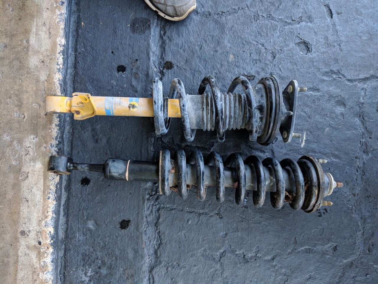

    Since you got lift options I'll do shocks
    We just really need a mod to make one of these a sticky thread @tcBob (please give us 5 lugs a little love...we know you had one :anonymous:)
    Added 7/26/18

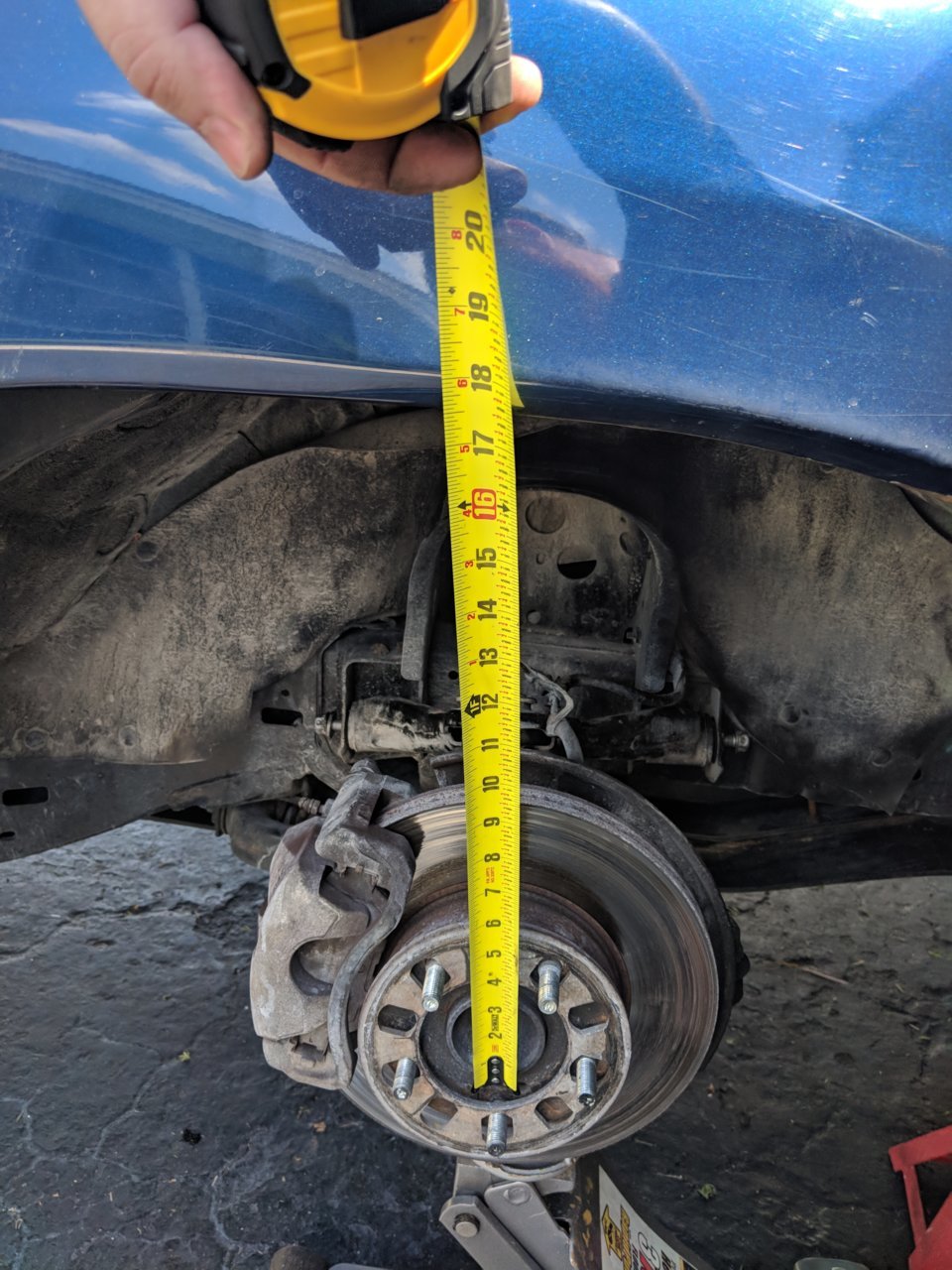

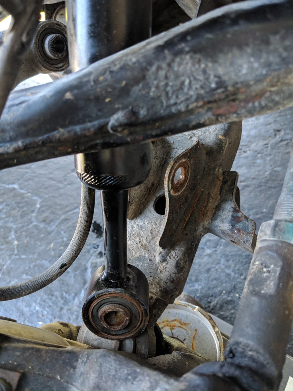

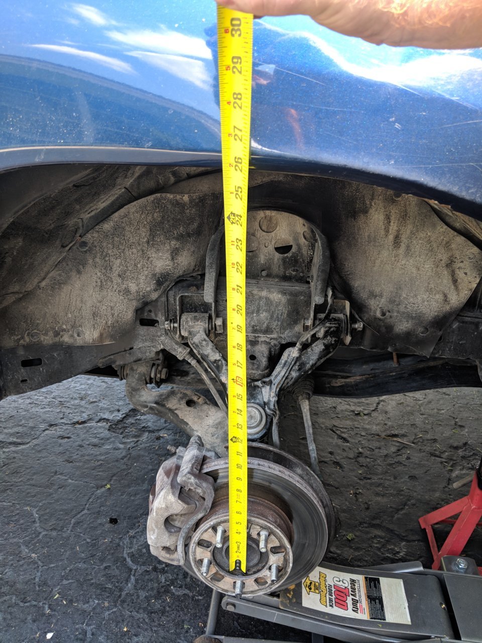

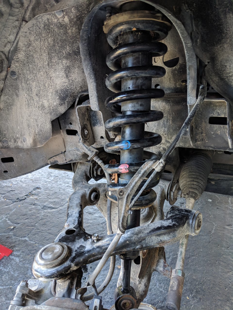

    So here's the reason we can't use 2nd 6 lug shocks up front (probably one of the most asked questions). It's mainly because of the extra inches in the bottom of the shocks. It's runmored that 1st gen shocks might work but it has not been test. One day I hope to get ahold of some blown shocks to test fit.
    Also please note this is the Bilstien 4600 hd shock with a 3 in spacer and still isn't close
    Also for giggles hers the travel numbers for stock suspension (I think) I calculated 8". I'm going to remeasure once I get my uppers installed to compare.
    Up
    And now down

    Vehicle Modifications: TACOMA 2007 FRONT TOTAL CHAOS 5LUG ,LONG TRAVEL KIT 13" OF TRAVEL KING COIL OVER (550 POUND SPRING RATE) (18 INCH COIL) REAR BED CAGE 16" SMOOTH BODY FOX SHOCKS 2.5 2.0 / 2.5 BUMP STOPS FOX ICON ADD LEAF PACK WITH OEM SPRING 11" OF TRAVEL TRUCK COMES SPRING UNDER BY MANUFACTURE TOYOTA REGEAR TO 4.0 WITH AUBURN UNIT ENGINE 2TR-FE WITH AFE COLD AIR IN TAKE DOUG THORLEY HEADER MAGNAFLOW EXHAUST TIRE S NEW KO2 32/11.5 METHOD RIM 15" WITH -20MM OFF SET
