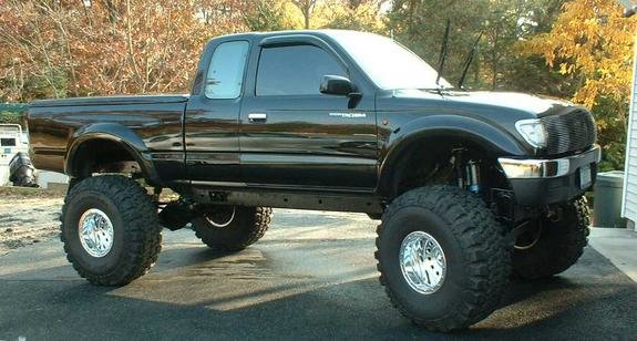

    4602190003_large.jpg is this where im going end up (height) with body/spacer/lift coil?

    No lol thats a 6 lug with like a 10 inch lift. We need like 5-6 inch lift to even hit the stock 6 lug height. Spindles will make u poke like 3 inches a side i think, not too dramatic.
    U can keep ur current lift and go bigger tires for more lift like 31s? What size tires do u have rn?

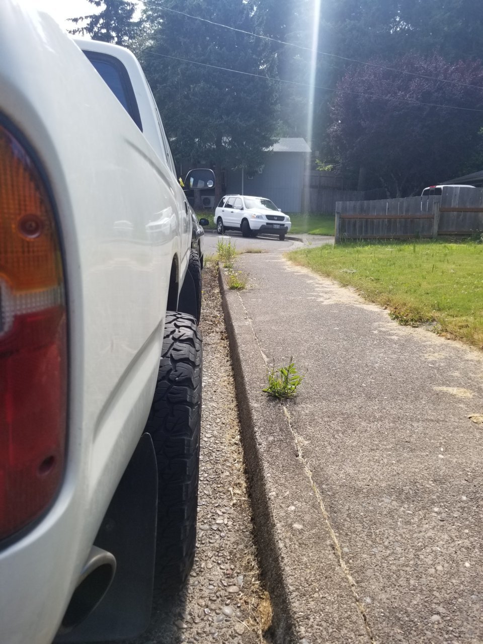

    This is how they poke right now stock.
    I'm not opposed to more lift just deciding if I want to add the spindles when I do uca and lift coil, and wondering where I'll end up with 9" of lift. dont want it looking like a damn jack in the box

    U on stock gearing with the 31s? No u wont look crazy with adding the spindle on top of what u have
