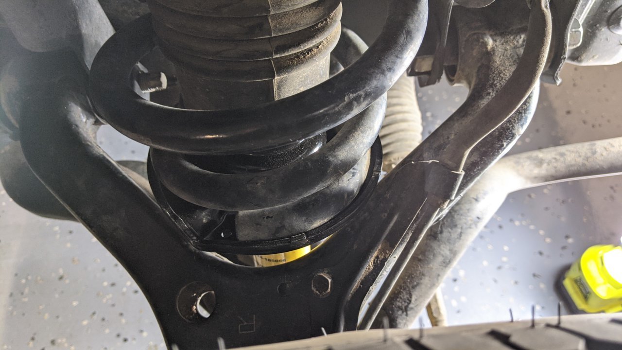

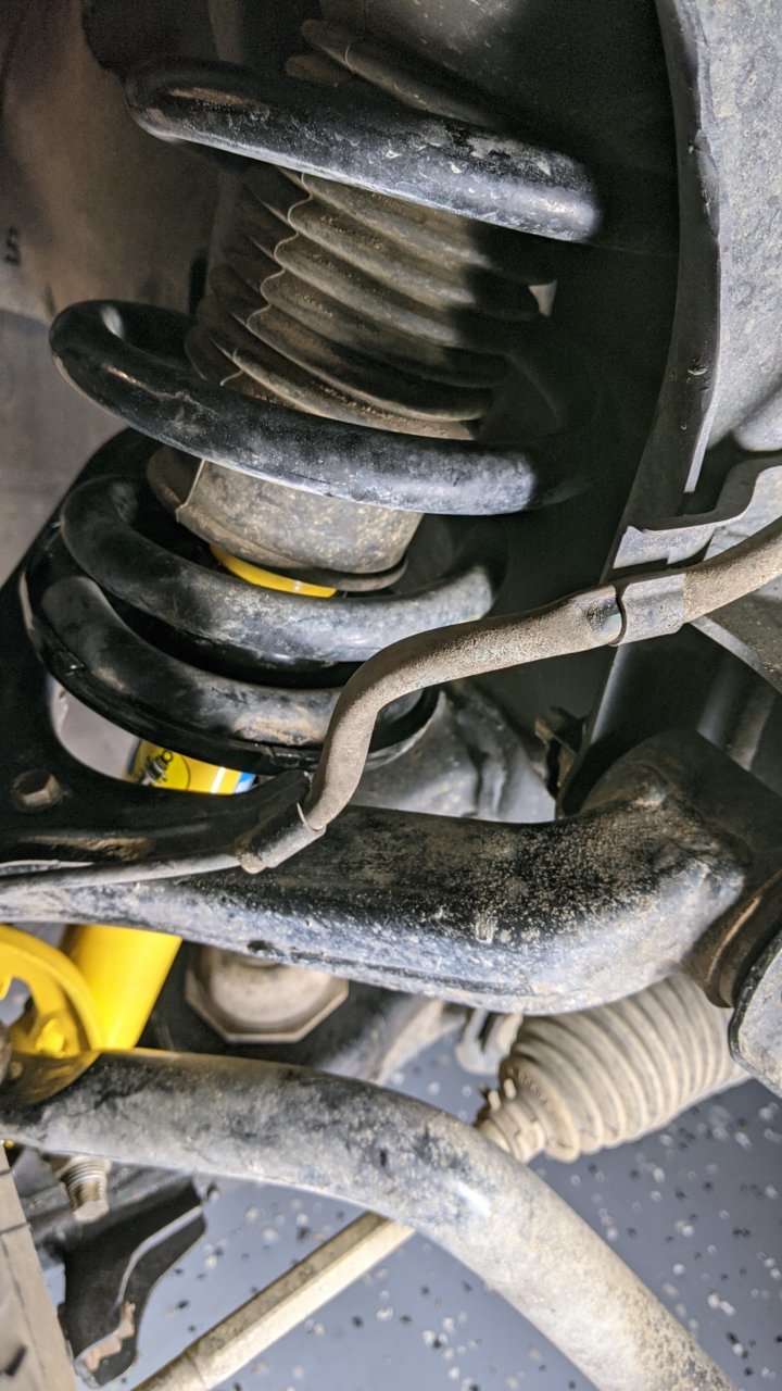

    Can anyone confirm with the spacer lift that the UCA is supposed to be below the spring perch? Seems off to me, maybe it's not supposed to be above the springs. Much appreciated...

    Are you on the ground? At full droop it can look like that.

    Yep, on the ground... Even called pro-comp and they said it's normal.

    I almost wander if I need to rotate the spring and perch to clear the UCA...

    Yeah it needs to be rotated because on the ground it sits higher than that right now it's kinda binding.

    No worries it's pretty common and a pain because it took us a while to figure it out.
