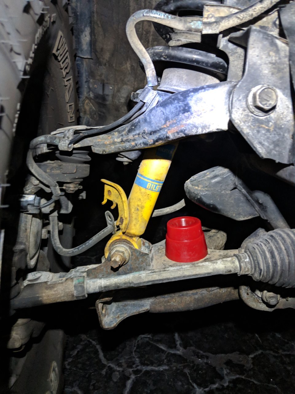

    Seems to be a little better - but I'm hesitant..
    I wander if the alignment will help once I'm done.

    Is that back on the ground now? It'll still look like that drooped. Also fuck that sway bar. With new shocks I would take it off and see if you like it, if not then put it back on.

    No, that was with a jack under it. It's definitely better than before, but I guess it's as good as its get. There's really no reason the UCA will go above the perch for a truck that's not going off-road.

    You'd be surprised. Highway speeds and speed bump can make it happen. As long as you don't see anything touching then you'll be good. It'll be close but shouldn't touch.
    Here's what mine looked like with an eBay 3" spacer.
    Now with my kings, my new upper control arms, and the weight of my v8, It finally sits close to level.
