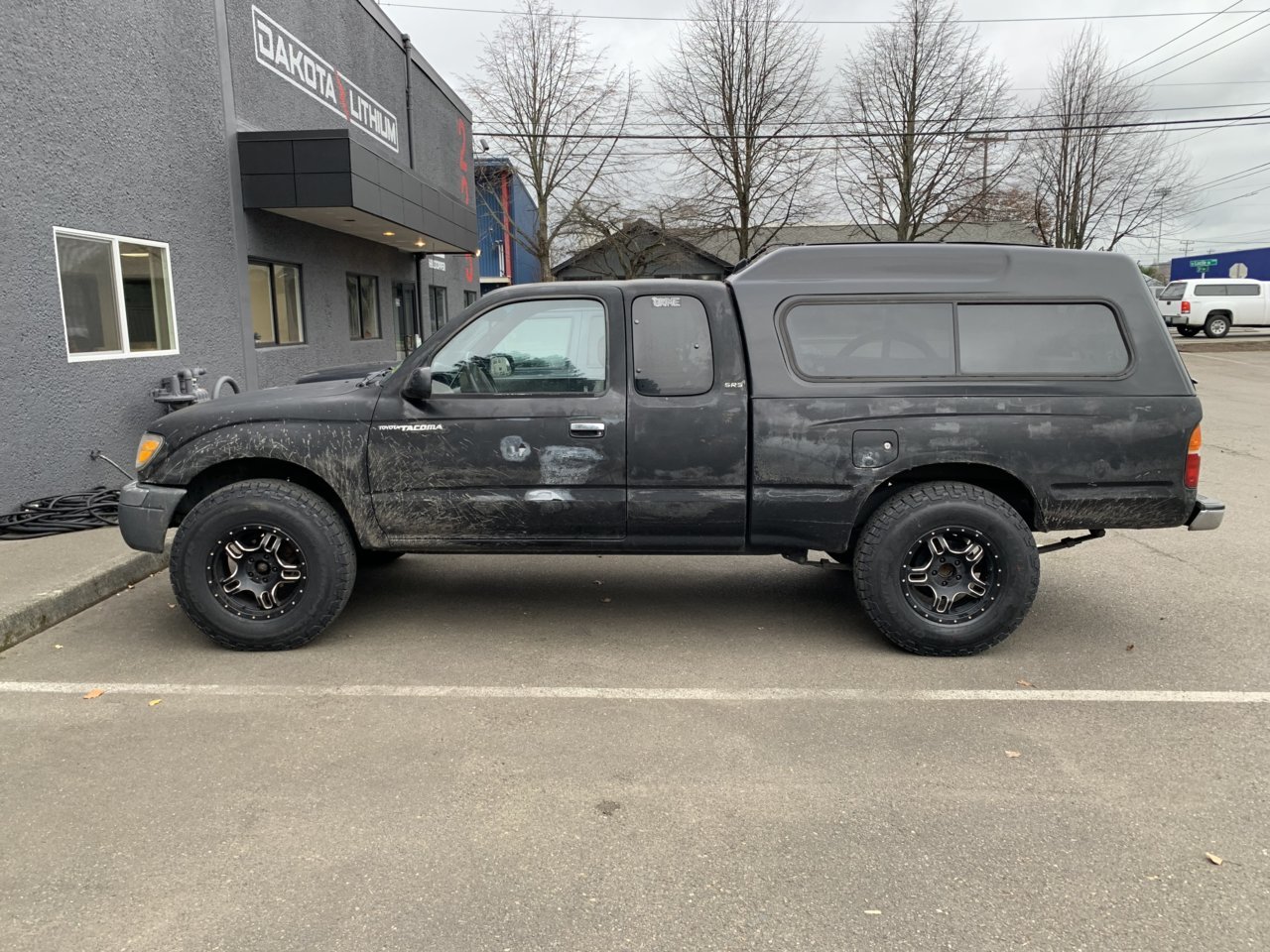

    DBD6B82A-826F-48DD-9522-BA3435A704C7.jpg A5FE5F07-8A0A-424D-951B-921D7A67C461.jpg
    I can confirm this kit works great. I installed it a couple months ago. Pretty straightforward install. The only thing I don’t love about it is that it makes the front wheels poke out about 1.5” more than the rears.
    I got 31” tires to fit with minimal rub at full lock(weirdly only an issue on the passenger side).
    Others have also done the Daystar spacers and V6 coils to give it a little more lift. Once I figure out how to get more in the rear I think I’ll go for it.

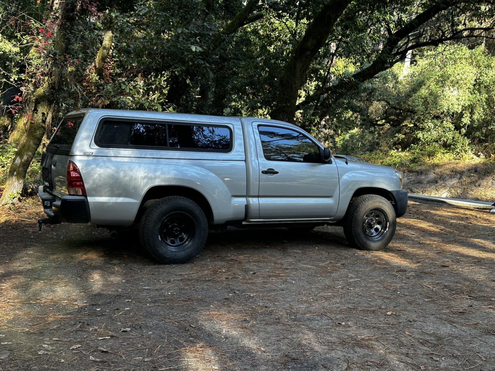

    Hi all, figuring a few things out prior to my ReadyLift install. I’ve got a base 06 5lug with an A.R.E. camper on it with no helper springs or AAL.
    Put some love into the cab and wheels, tires and spacer recently. It’s running well but I’ve got a ReadyLift kit waiting to go in (2.75 front spacer/1.75 rear AAL).
    Currently stock with the front sitting at about 33.5-33.75” and the rear at ~34” unloaded with the A.R.E. shell on.
    With those numbers, installing the ReadyLift kit is going to have me sitting high up front with about ~1” squat in the rear.
    My question: how much should I expect the ReadyLift AAL to settle by (with camper on). Just determining the size of the additional AAL I’m going to put in when I do the ReadyLift.
    Pics for attention and thanks for any input y’all can provide.

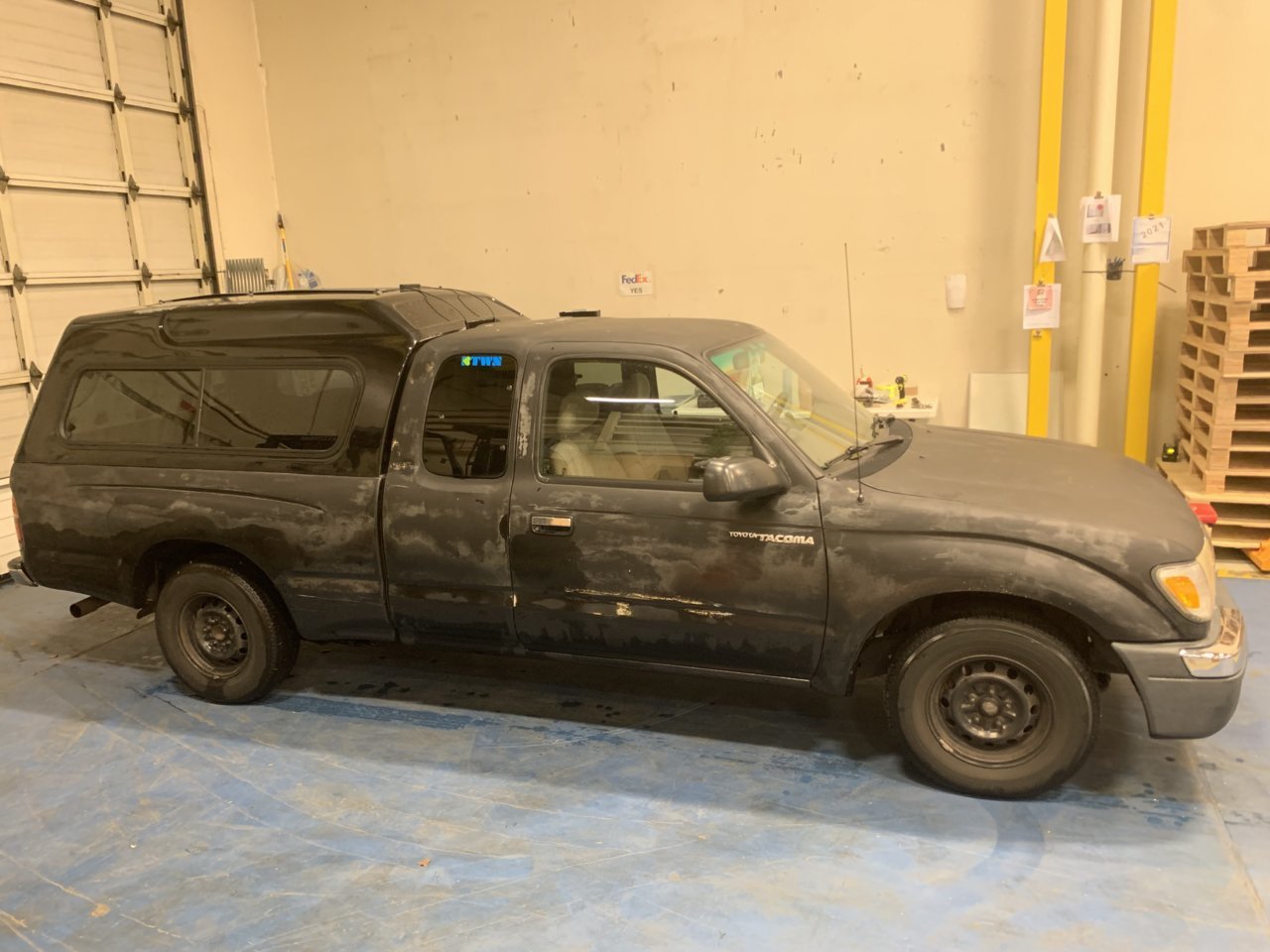

    I just got my first tacoma and ready for a new suspension and lift. Im currently running a stock strut and shock. I have a 2WD 5 lug tacoma, and don't know where to start with the lift. I know there isn't really a suspension kit for 5 lugs. Ive been searching and I can't find anything to help me with. What I do plan on buying is the Bilstein 4600 Front and Rear Shocks, while also doing a 1.5'' front poly spacer leveling kit and the 1.5" Front 2" Rear Shackle Lift Kit. Hopefully this can be a small lift for the moment until I plan on getting the readyLift kit. If anyone could help me I would gladly appreciate it!
