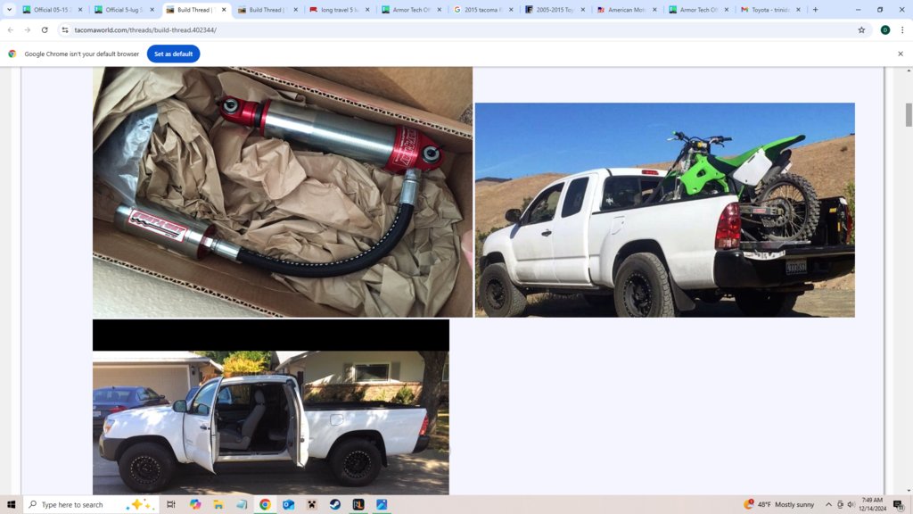

    i know the orignal post here states that the icon 2.5 coilovers were the only ones to be used with the total chaos mid travel upper control arms but ive been trying to read everything i can about these little trucks and it looks like this guy found another way, curios if anyone can tell me any more about this set up with the sway away coilovers? not sure what a heims spacer is, i know its a long shot to find the control arms, but im curios, if was able to find a pair of the ucas, would these sway away and heims parts needed to run what this guys got still be available? im sure if it were so easy id see more pics of trucks set up like this? any thoughts?
