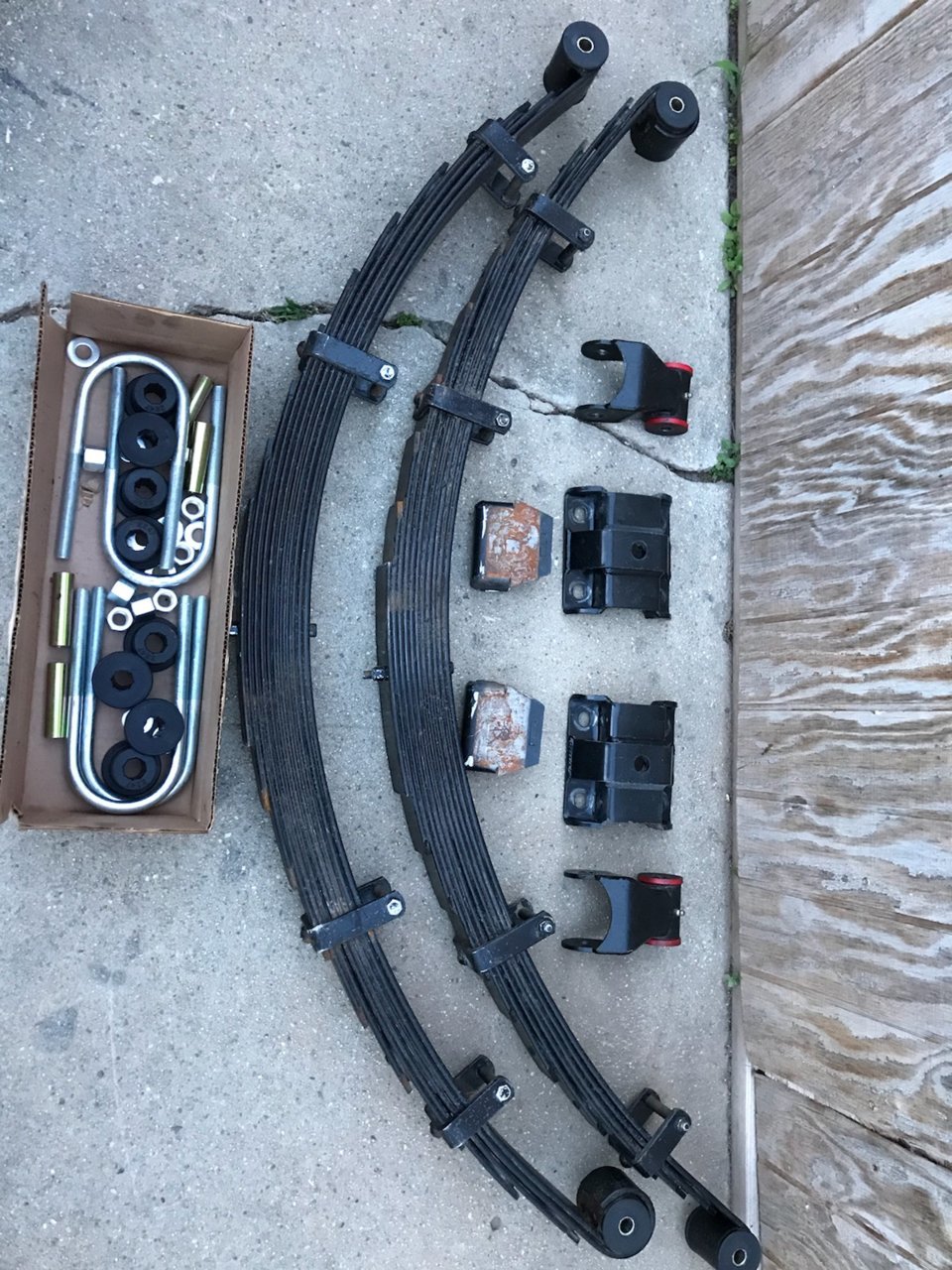

    Vehicle Modifications: TACOMA 2007 FRONT TOTAL CHAOS 5LUG ,LONG TRAVEL KIT 13" OF TRAVEL KING COIL OVER (550 POUND SPRING RATE) (18 INCH COIL) REAR BED CAGE 16" SMOOTH BODY FOX SHOCKS 2.5 2.0 / 2.5 BUMP STOPS FOX ICON ADD LEAF PACK WITH OEM SPRING 11" OF TRAVEL TRUCK COMES SPRING UNDER BY MANUFACTURE TOYOTA REGEAR TO 4.0 WITH AUBURN UNIT ENGINE 2TR-FE WITH AFE COLD AIR IN TAKE DOUG THORLEY HEADER MAGNAFLOW EXHAUST TIRE S NEW KO2 32/11.5 METHOD RIM 15" WITH -20MM OFF SET
    picking up this kit this weekend i will let you guy know if it bolts right in it should but we will see
    this guy is a 5lug running the define engineering LT
