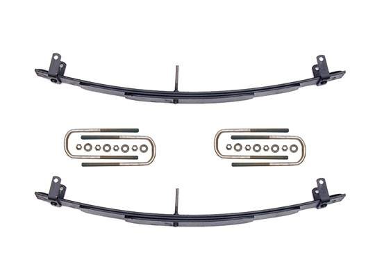

  12. May 10, 2018 at 2:12 PM
    #92
    dillonk1602
    dillonk1602 Well-Known Member
    Apr 2, 2013
    #101176
    1,026
    dillon
    san diego
    tacoma 5 lug
    Vehicle Modifications: TACOMA 2007 FRONT TOTAL CHAOS 5LUG ,LONG TRAVEL KIT 13" OF TRAVEL KING COIL OVER (550 POUND SPRING RATE) (18 INCH COIL) REAR BED CAGE 16" SMOOTH BODY FOX SHOCKS 2.5 2.0 / 2.5 BUMP STOPS FOX ICON ADD LEAF PACK WITH OEM SPRING 11" OF TRAVEL TRUCK COMES SPRING UNDER BY MANUFACTURE TOYOTA REGEAR TO 4.0 WITH AUBURN UNIT ENGINE 2TR-FE WITH AFE COLD AIR IN TAKE DOUG THORLEY HEADER MAGNAFLOW EXHAUST TIRE S NEW KO2 32/11.5 METHOD RIM 15" WITH -20MM OFF SET
    icon add leaf better $214

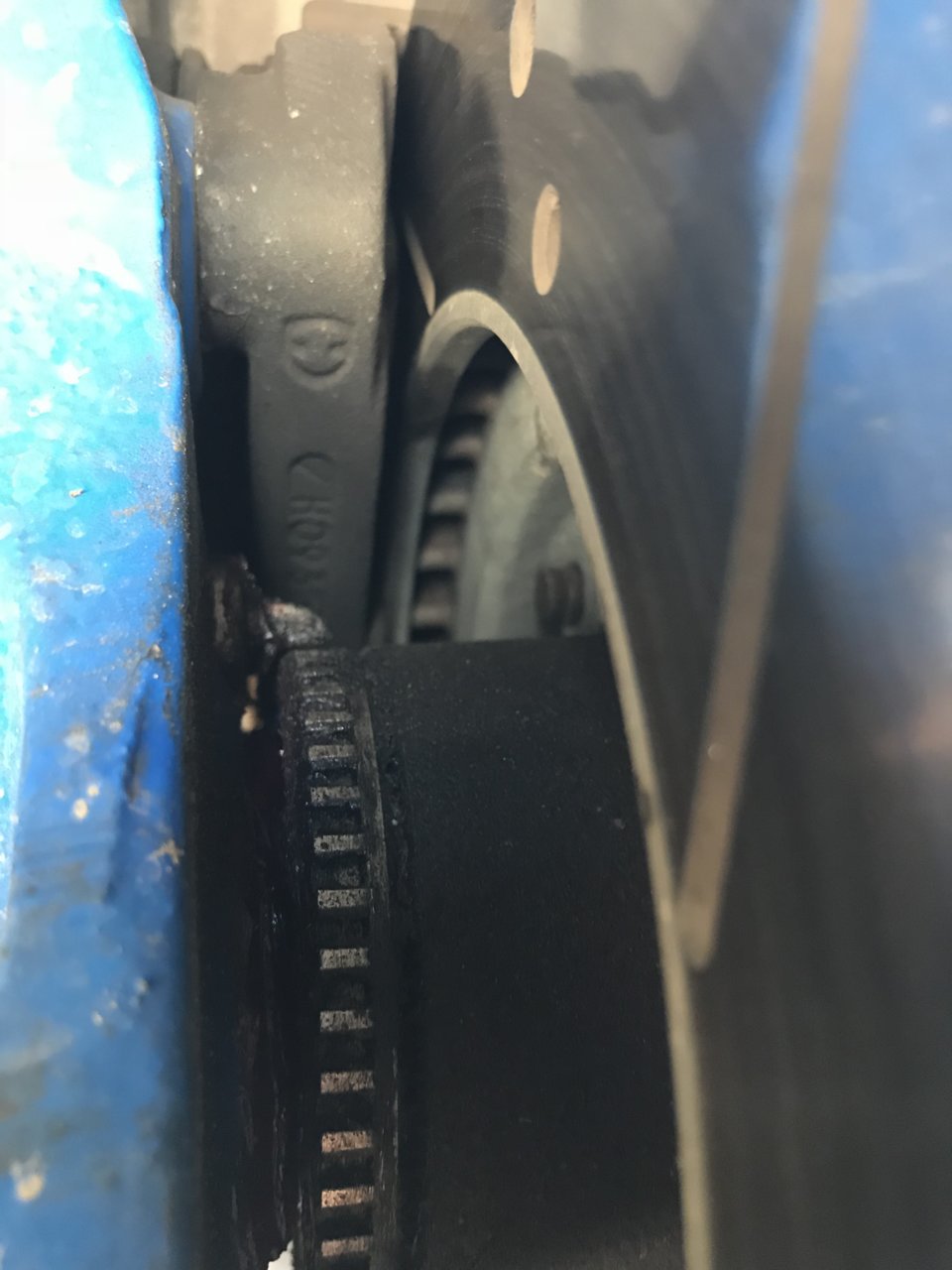

    Did anyone have an issue with the roller bearing seating on the Fabtech 3" spindle incorrectly?
  15. Jun 2, 2018 at 11:36 AM
    #95
    Sperrunner
    Sperrunner UA342
    Feb 23, 2018
    #245334
    50,969
    Miguel
    El Cerrito, Ca
    2023 Ford F250
    Its the company truck
    No. What is it hitting?

    2
    Joel
    1997 tacoma 5lug v6
    My mechanic is saying from my understanding that the bearing is not seating all the way back on the spindle?
  17. Jun 2, 2018 at 12:08 PM
    #97
    Sperrunner
    Sperrunner UA342
    Feb 23, 2018
    #245334
    50,969
    Miguel
    El Cerrito, Ca
    2023 Ford F250
    Its not gunna sit flush, there is a gap for abs for trucks with abs

  18. Jun 2, 2018 at 12:38 PM
    #98
    Sperrunner
    Sperrunner UA342
    Feb 23, 2018
    #245334
    50,969
    Miguel
    El Cerrito, Ca
    2023 Ford F250
    Let me see if i can get a pic for you
