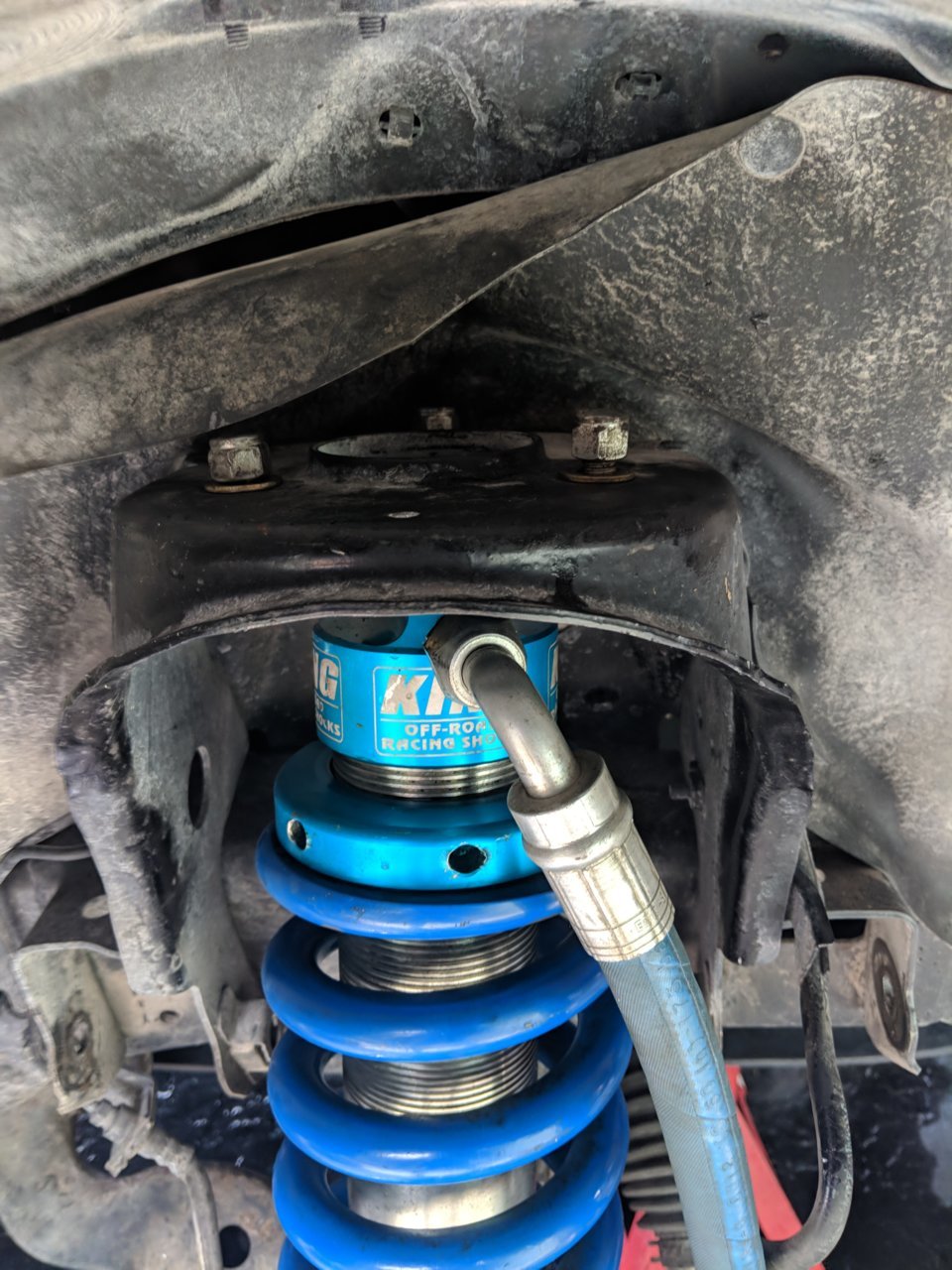

    Do youe stock uppers rub on the coil?? Because i don’t really see any difference with a 3” spacer vs a 3” lifted coil overs, unless they are wider and rub.

    Yeah, it'll rub on stock uppers. The uniball aftermarket uppers give it's room inside to fit the coilovers.

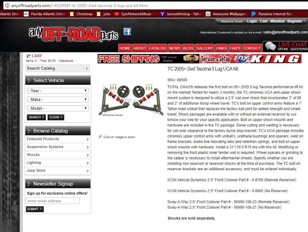

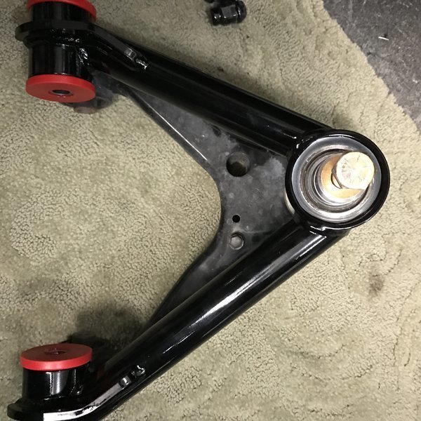

    Those icons are for 6 lugs the ones we need dont have the extra 3 in at the bottom. The main reason we need better uppers is the oems are so fat and take up way more space than tubed ones. Be careful when looking at "Does this fit you vehicle" because there are plenty of 2.7L 6 Lug 2wd out there.

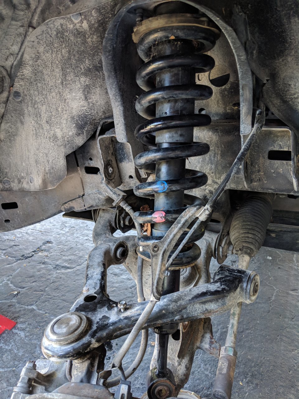

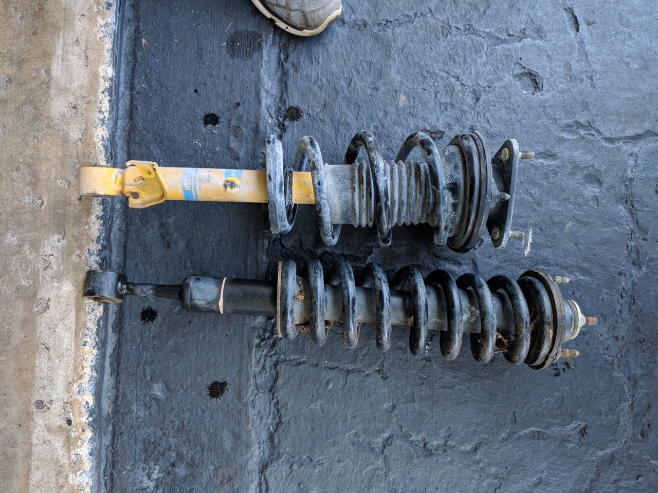

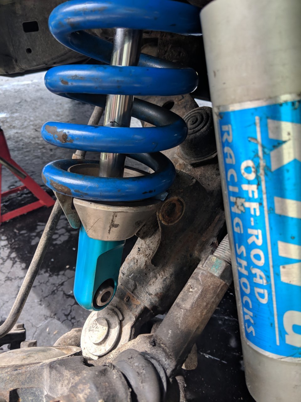

    Here's a picture to illustrate why lol
    And that's with a 3 in spacer already on.
    It just won't fit because I believe the coil bucket is shorter.
    HackD and the macf[QUOTED] like this.

    Thanks for that @5 Lug Fury . Really puts it in to perspective now.

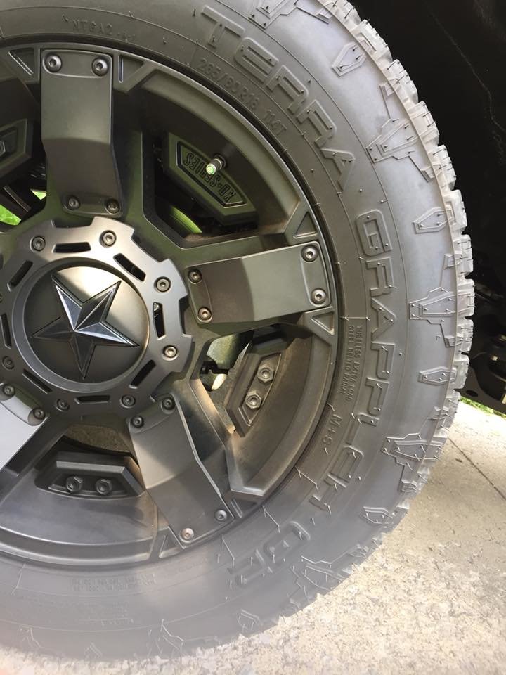

    I found a 2WD 2015 and bought it. It has been lifted, so I am going against the grain and will be returning to something closer to stock.
    It came with Terra Grappler G2's on all 4 corners mounted on 18 x 9's. I'll be losing those soon. Too much noise for all my road miles.

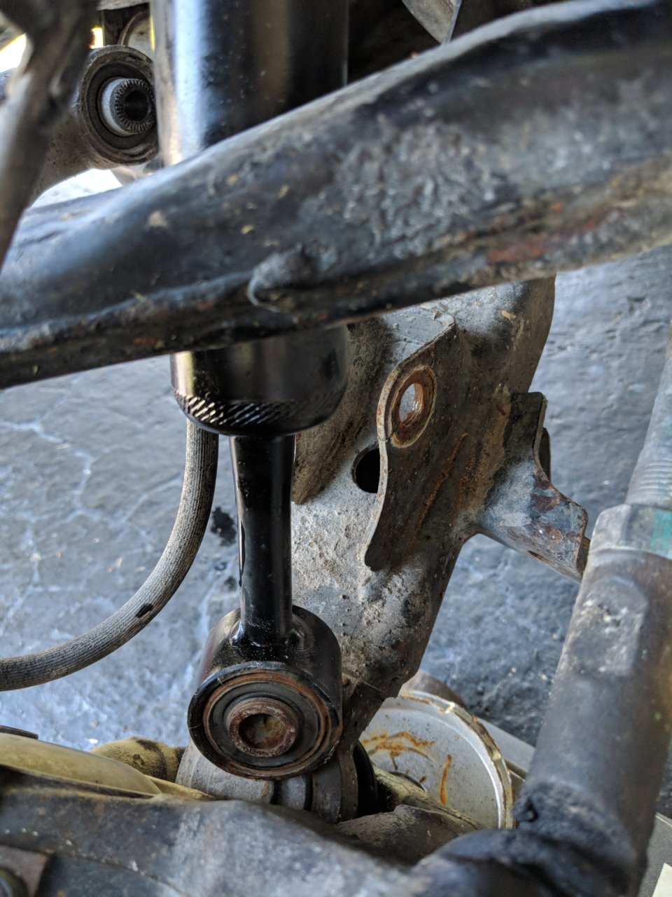

    WOAH WOAH WOAH.... What is the deal with the coil over x runner adapter plate... please explain the function as the website doesn't explain at all.

    33" 07 5 Lug
    All of Themz
    DAWG... I tried to tell you... Youll have to recreate the LCA's... The only way youll get anything to fit in there is if its the right shock... The 5 lug shock doesnt have the extended loop at the bottom where it connects to the LCA
