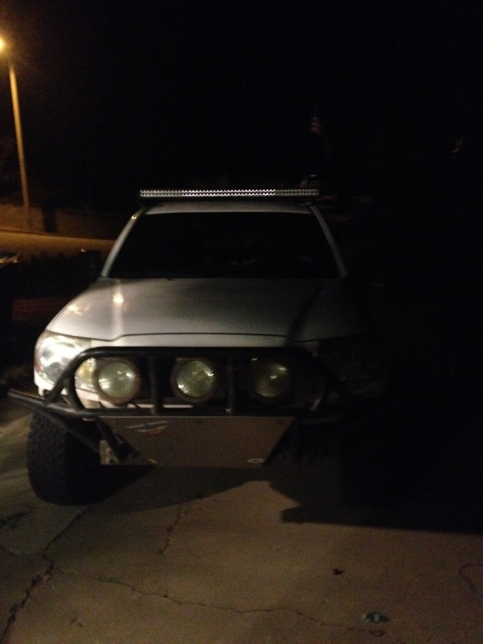

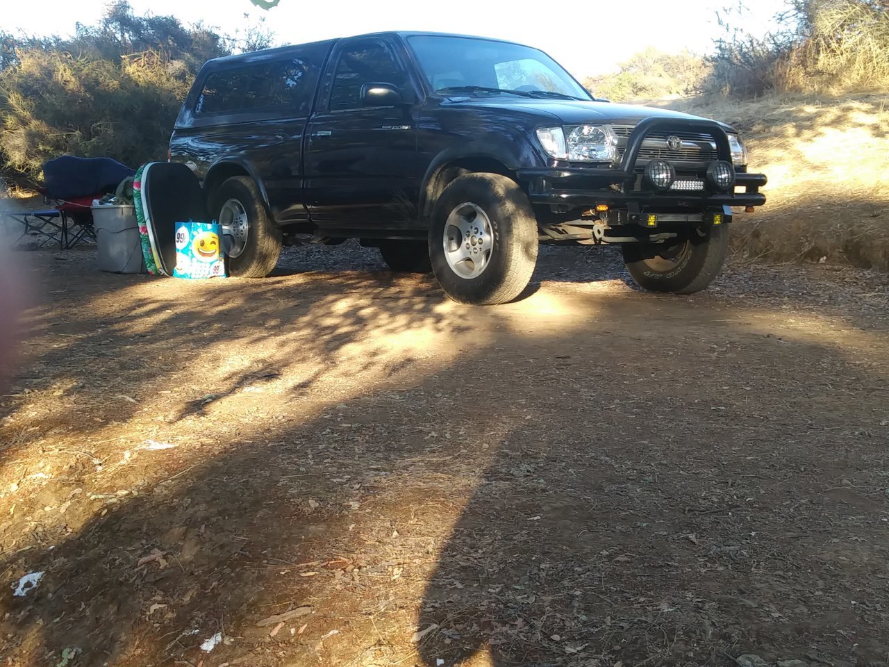

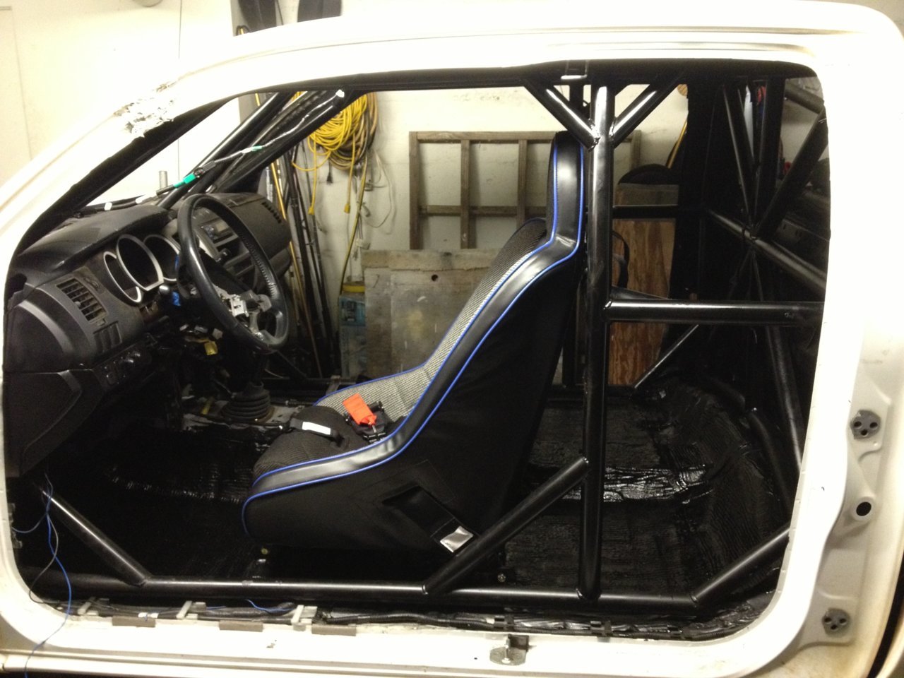

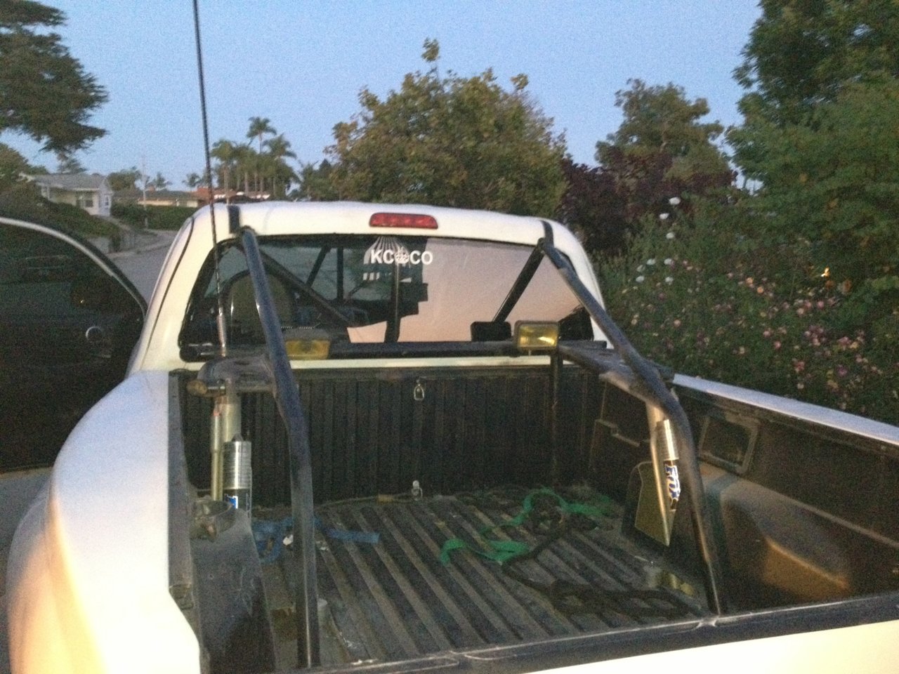

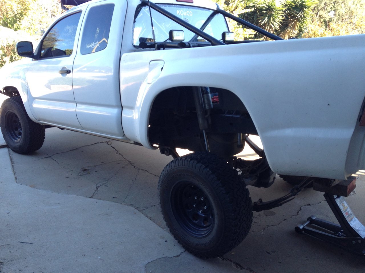

    My old 5 lug. Did all the work myself. Wish I never would have sold it....

    That looks sharp. Unfortunately I totalled my truck. Ended up moving up to a 2002 extended cab prerunner with the 3.4. Absolutely love it!

    What was your front setup?
