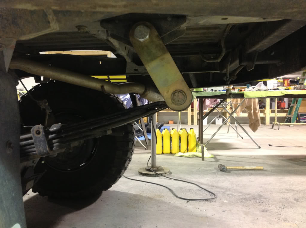

    Hey man I can't remember ifi posted this in my build. But here ya go anyways

    Hmmm... that's pretty similar to mine right now. I'm working with Alcan to get my new spring built and I was thinking about going 1.5" longer on the main leaf. That would put my shackle angle at 48* (on the back side obviously). Do you think I should stick with that plan, or go 1" longer with a 53* angle? BTW, I'm currently at a 62.5* angle so either would be an improvement.

    Ya that's unloaded for me too. It goes down a bit with some stuff back there.
    Just make sure they keep the front the same length. Like front mount to center hole. Only extend the rear. Otherwise your axle will move back .5-.75" and you'll get serious rubbing issues.
    I'd if it's worth the trouble for "perfect" shackle angles.

    Yeah, if that's unloaded, you'll probably be at around the 48* angle with it loaded. Also, you are right, I told Bill (at Alcan) I wanted all of the additional length to be added aft of the center pin, simply to get my shackle angle right. He said that he could build the new main/support leafs to my original spec and just add the 1.5" to the end. He'd just make the springs to the same arch as my original pack, when it was new. I figured, if they flattened out a bit, it's not big deal.
