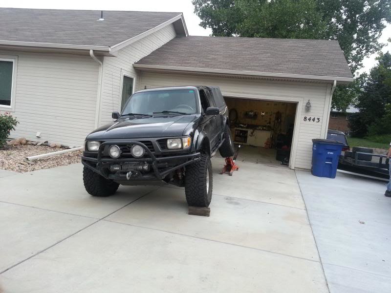

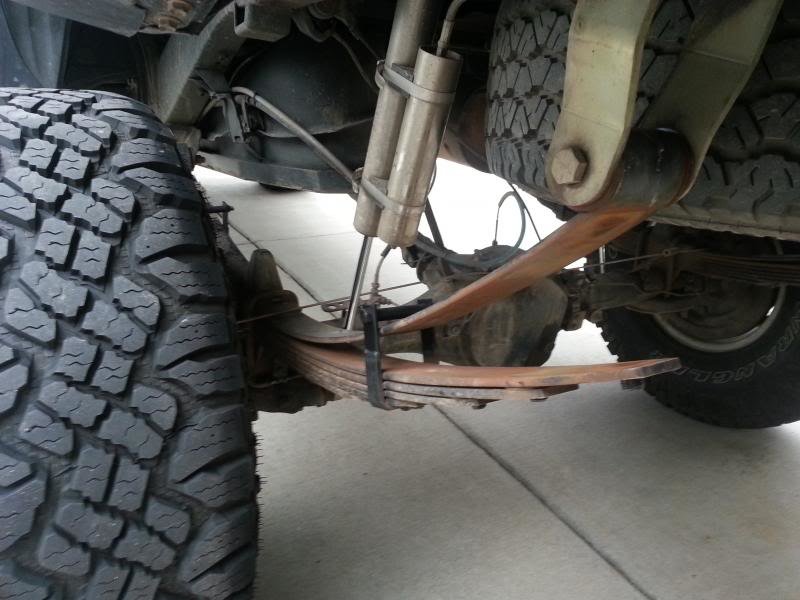

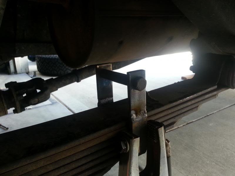

    Here's a quick driveway test.
    Lifted the back tire: Not anywhere near flexed out
    I'm starting to see significant spring separation if the back tire is lifted. If the front tire is lifted, the spring still binds like before. (I'm hoping Orbit Eyes solve this problem)
    Does this seem like too much separation? I'm considering shortening the keeper a bit.

    holy shit! haha yea id guess thats a tad too much..mine don't do that..and i have no keepers at all..haha

    ^Haha! Yeah, I jacked the truck up and was pretty surprised by what I saw back there! I talked with Bill, from Alcan, today. He said that I should cut that separation in half for safety's sake. So, I think I'll drill a hole about half way down my extension and see how that goes.

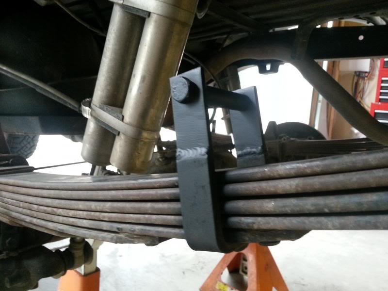

    Small Update: I drilled my spring keeper's about half way up my extension and put the through bolt in there. Hopefully this will limit me enough to keep me from breaking the main leaf. I'll get some pics when I get time.

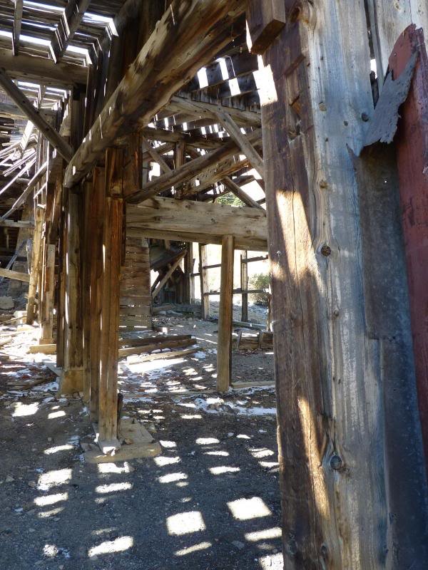

    Some quick pics from Mosquito Pass, altitude 13,186.
    My Jeep buddy needed a little help
    And... (I'm on the other end of the strap)

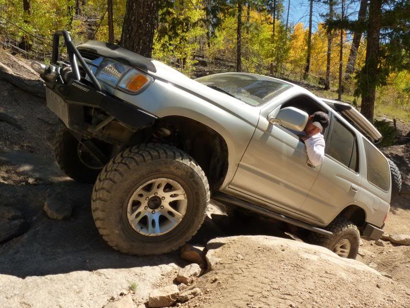

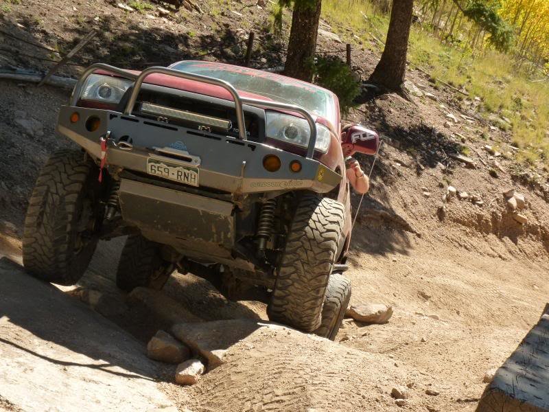

    Mine Pictures:

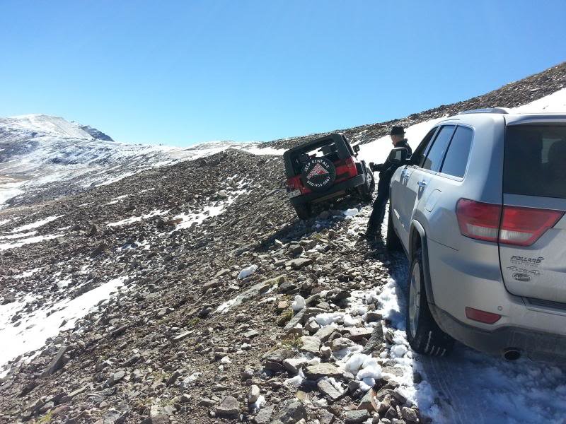

    Here's a rental jeep that slid off the trail a bit. A couple inches more and he would have fallen at least 150 feet.
    He had a "tow" on the way. I took this picture from a half mile away a few hours later:

    Nice trip. You are right, looks like less snow than I ran into a bit west.
    Although this looks like driver error, this is why I am not afraid to call it and turn around if shit is getting sketchy, falling off the side of a mountain miles from everywhere is not a good place to be!

    You are right on both counts. The jeep was a rental and it seemed like the driver was from out of state and totally inexperienced in wheeling. The rental company told him that the pass was easy so he went for it.
    And I totally agree on turning around without regret. I could have passed this jeep, but decided it wasn't worth the risk. Better to live to wheel another day!

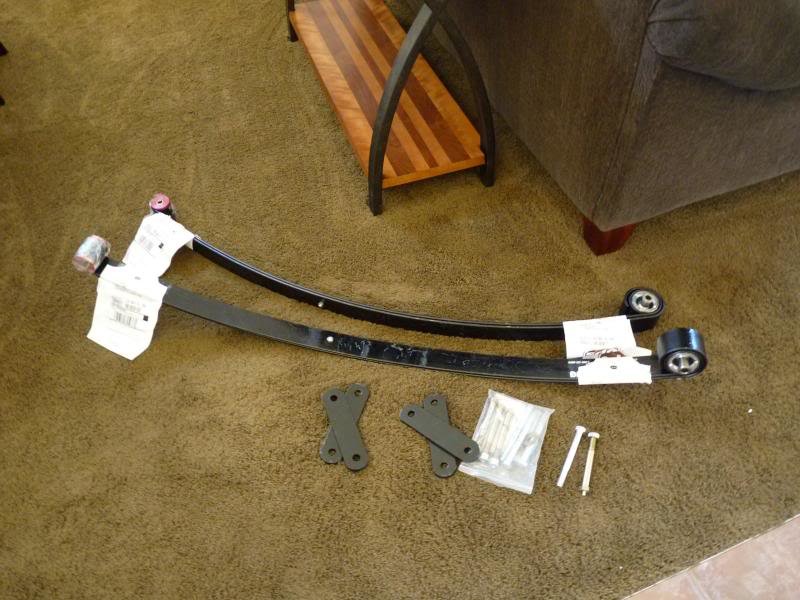

    In other news, I got my orbit eye leafs in yesterday... they made them to the wrong lengths... again!:mad: Hopefully, we get this sorted out today so I can, eventually, get more flex out of my rear. Frustrating.:annoyed:

    Hopefully, the springs will be picked up from my front door today. Once Alcan gets them, they'll make me a new set. For my trouble, they are giving me new u-bolts and centering pins.

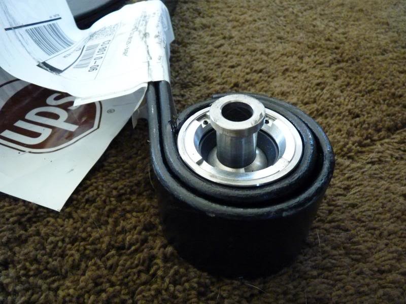

    So, in case anyone is interested, here's what the Orbit Eye setup looks like. Still waiting for them to fab me up a set that actually fits.
    Here's a close up of the Orbit Eye itself. The bushings are really really tight in there

    Did you have to get them pressed in?

    They came from Alcan already installed in the leafs, so I'm not exactly sure. It looks like they install the spherical portion and the associated teflon-like bushings first, then use a lock ring on the outside to seat everything.
    Now that I think of it, I really should ask Alcan how that all works! I don't even know if I can service them at home or not. MapleMoose, you may have saved me a LOT of trouble in the future!
