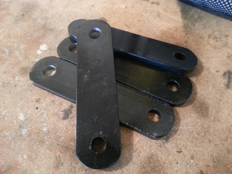

    Shackles are done! (and they should actually fit!)

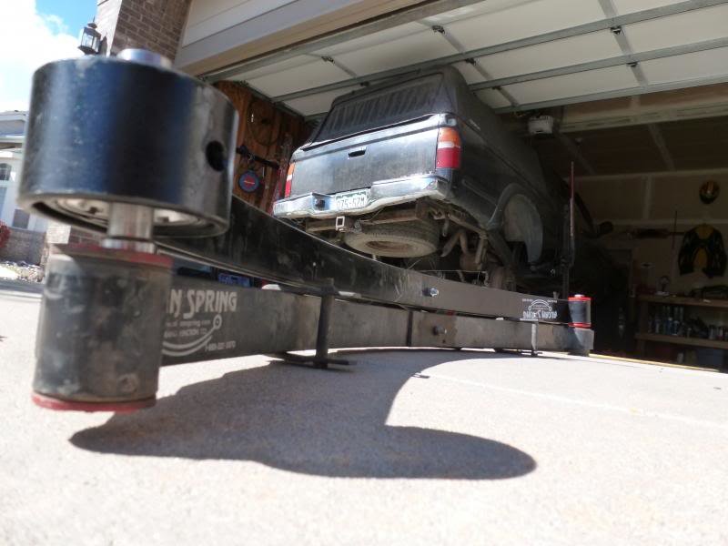

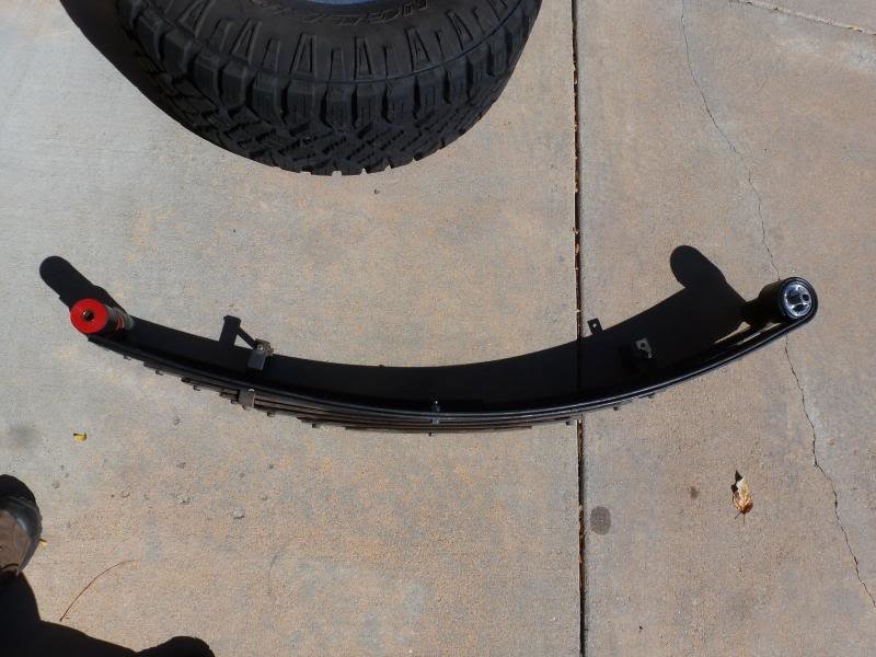

    Well, I didn't think I could get skunked 3 times in a row on these springs BUT:
    Where is my extra 1.5" of spring after the centering pin!?!?!:mad:
    So, I'm sending them back...

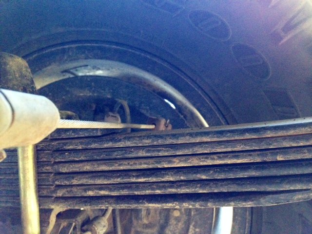

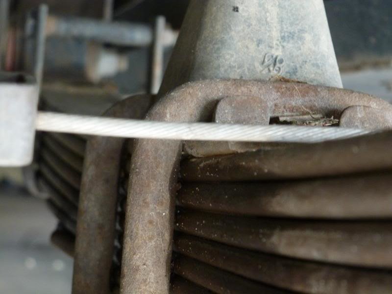

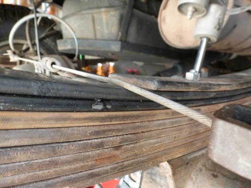

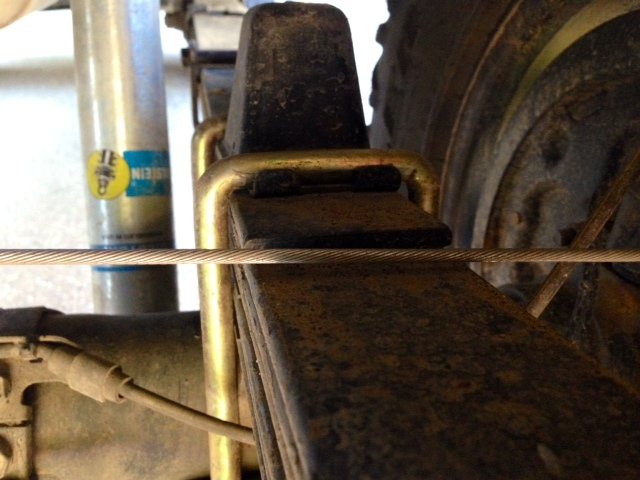

    Plus, I discovered that my e-brake cable is going to interfere with the new spring setup. Is there an easy fix for this????
    Long story short... another disappointing day.

    :facepalm:
    Good god. Alcan is not doing good..haha
    My leafs do that a bit too. Not quite as that much bust still some. Think I saw a fix somewhere..

    Mine was almost in the same boat...

    ^So mine look like yours on my current set, SeattleCoug.
    Is the cable rubbing no big deal, or do you guys think I should raise it up?

    At this point you should drive the truck to Grand Junction and have Alcan install the springs while you watch!

    Toytec 16" coilovers with Tundra Bilstein 5100s, Light Racing UCAs, Alcan Leafs with Orbit Eyes, 12" Bilstein 7100 short Bodies, ARB rear locker, 33x12.5 Duratracs, CBI sliders, Bushwacker fender flares, self made front bumper, M8000, Vision X 6.7" Hi/Lo Beam HIDs, full skids, Inchworm dual case setup - 15º clocking
    ^At this point, I'd be worried that they'd get installed wrong! I'm going to call this setup the nightmare pack...

    I'd probably just leave it as long as the wire isn't touching the top leaf at full draw on the emergency brake handle. When flexing it won't matter cause that doesn't happen for very long and the brake wire has (some) slack to it

    I wouldn't worry too much. Mine is close to yours(7leafs) and no big issues

    Thanks for the info SeattleCoug and Blackdawg. I think I'll just install them and run the brake cable as is for a while. If something seems to be a problem, I'll deal with it from there.
    So, I talked with Bill Ford (Owner of Alcan Spring). It looks like what happened is he basically got confused when building to my spec. He took the length of a stock spec tacoma rear, added 1.5" to it and built it for a 3" lift. The problem is when you arch your spring for a 3" lift, it takes an additional 1.5" of length to get the eyes to line up. So, he's going to add that extra 1.5" per my spec and everything should be good. He felt really bad about screwing up my springs so many times. He also feels bad that all his profit is now thrown out the window. Long story short, this might be his last set of custom springs. I hope they work...
