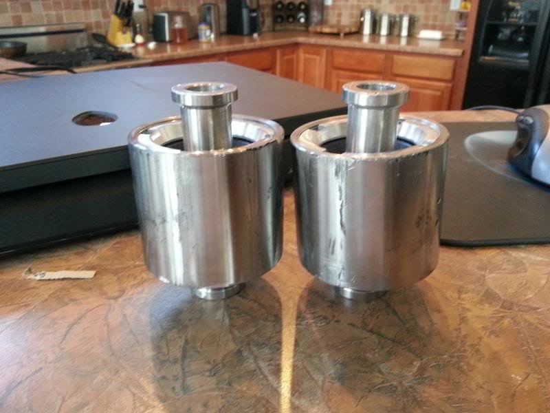

    so here is a thought i just had..
    i take it the hole those squeez into is much bigger then a normal polly bushing..yes? maybe?
    So..if you have to uncurl your new leaf and wrap more steel around them..won't the leafs not be 1.5'' longer now..
    or they about the same size?

    Yeah, the body of the orbit eye is almost twice as big as the poly bushing. I bet it takes close to 1.5" more steel to wrap around it. Also, on the last set, Alcan forgot to account for the extra length needed for 3" lift springs... which is about 1.5" as well.
    SO... I'm on round #4 now! I think the spring length is actually right this time. Tomorrow, I'll press the bushings in and weld tack weld them to prevent them from coming out. I might get to installing one side's spring tomorrow as well. Then, the rest will get done on Saturday!

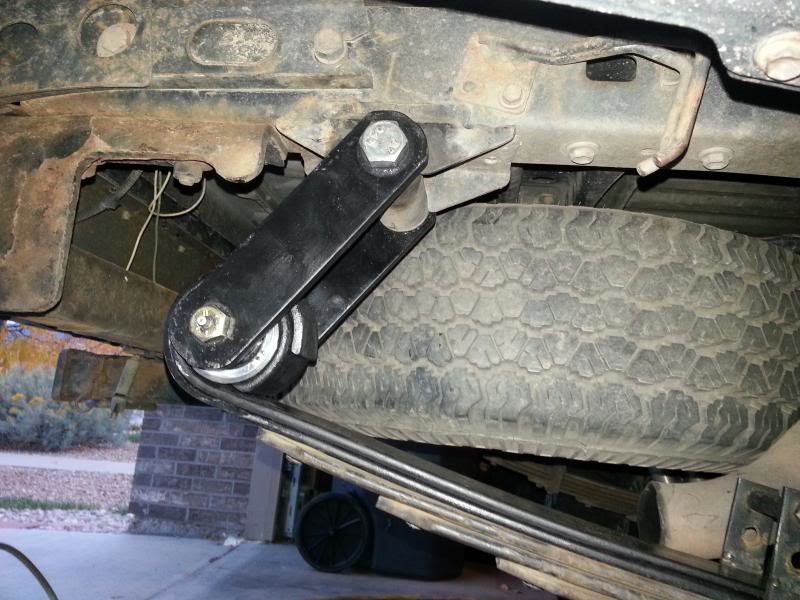

    One side is done. Here is the new shackle angle:

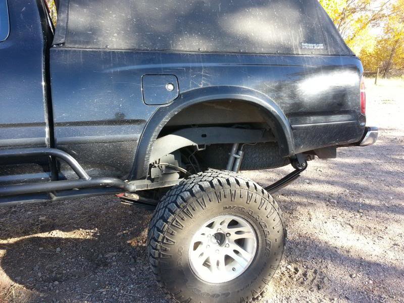

    Suspension is finally in! I haven't gotten much chance to play with it yet, but I think I've already got a solid 3" of additional extension out of it. The springs and bushings need to be broken in, so I think I can get another in or two out of the setup. Here's a couple of pics. Final measurement on the shock was 27"... a big improvement over the previous 23" measurement.

    Still can't believe you needed all this extra work for that haha almost below the slider! I hope it goes a bit more..

    extra inch? pshh should be 2'' extra! i expect some massive droop shots tomorrow :cool:
