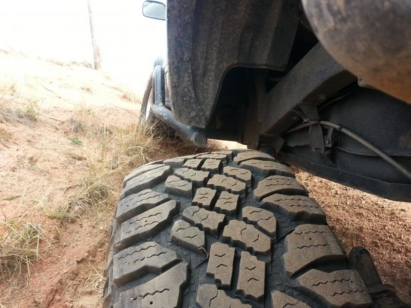

    The springs are breaking in a bit. Blackdawg: Here's a pic at full flex, like I promised.
    I took this directly behind the slider, so you can see the clearance. I think I'll get a little over an inch more as the system loosens up.
  12. Nov 1, 2013 at 1:23 PM
    #432

    now dats flex!!!
    :cool:
    looks killer man :thumbsup:
    only took you like what..2 months? :p haha

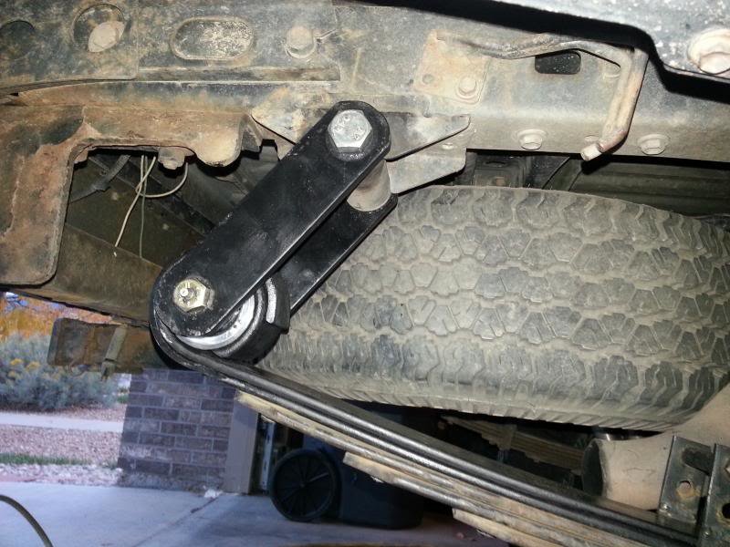

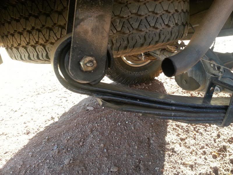

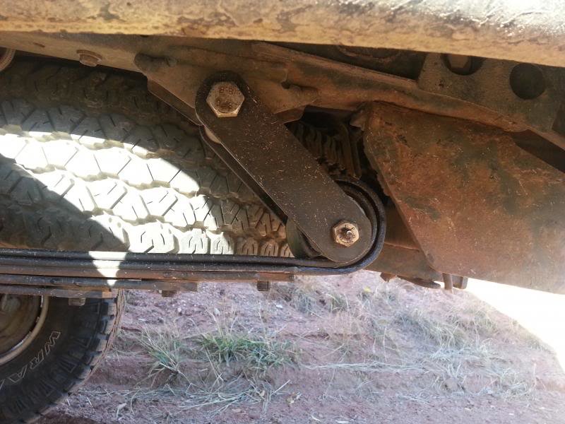

    Shackle angle pics, for me to reference in the future
    sitting level
    full compression:
    full extension:
