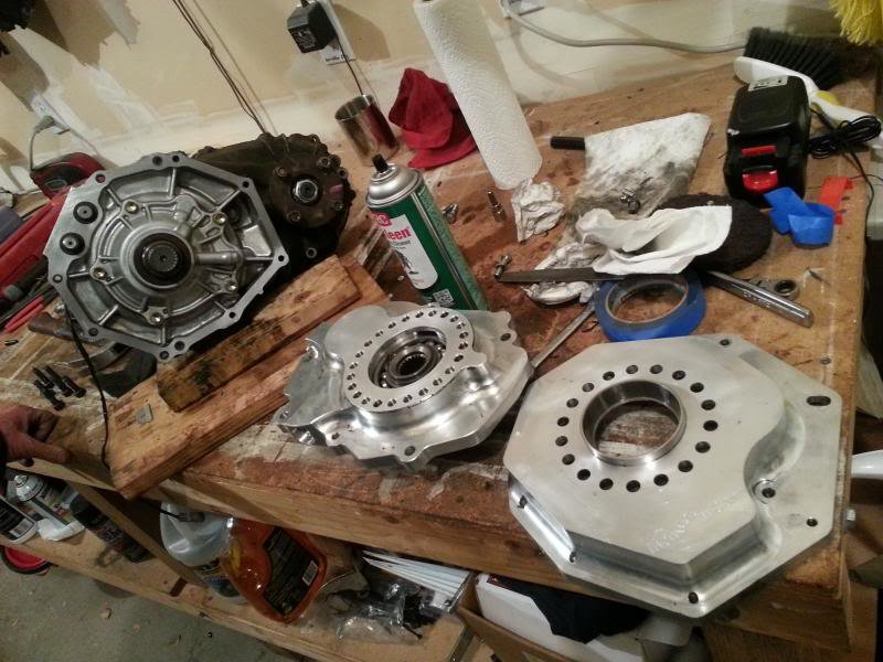

    So, I just drained both t cases... both are totally clean. I'll really get into the job tomorrow.

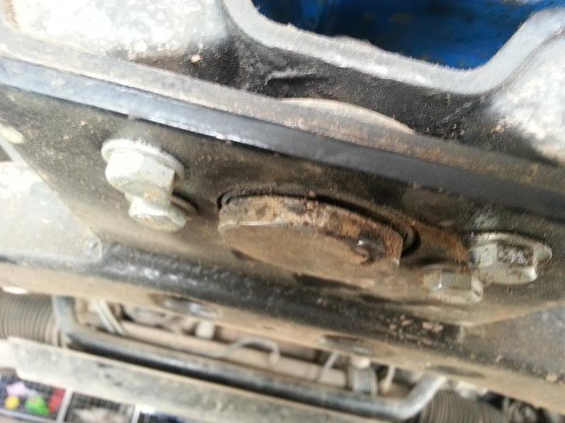

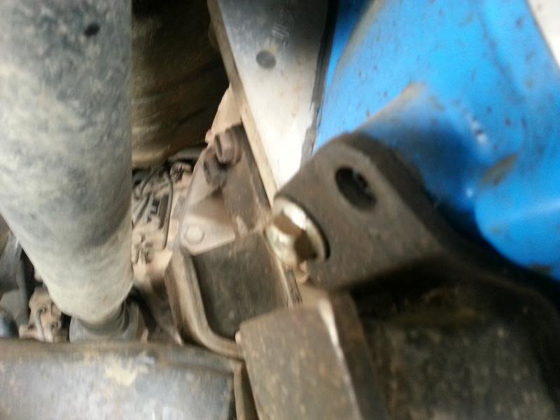

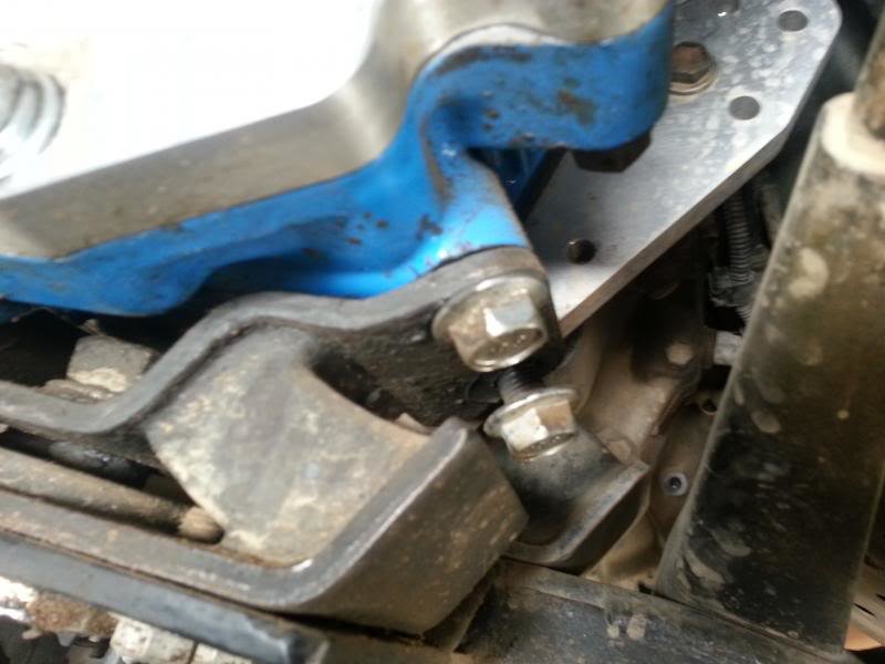

    I found my first issue today. Out of the 4 bolts on my crawl box mount, 3 were loose and 1 was missing. Pics:
    The bottom lug is loose too
    Do you think my rattles could be coming from here!?

    hmm..coulda been i guess..

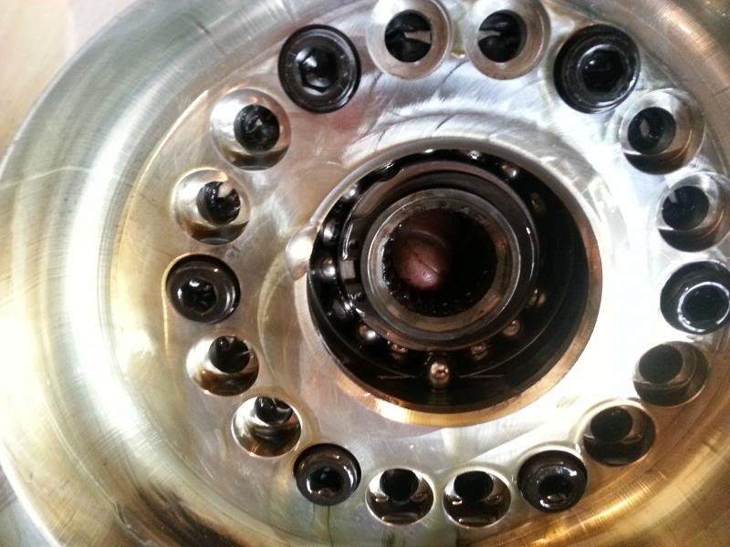

    Smoking Gun: See where the ball bearing escaped?
    So, had to tear the whole system down, press out the old bearing, replace and reassemble... what a day!
    Tomorrow I'll fill the cases and go for a test. I hope I put everything together correctly.

    Damn!
    thats odd..what causes that?

    I dunno. But it's the same thing that happened to Dylan... maybe a bad batch of bearings?
