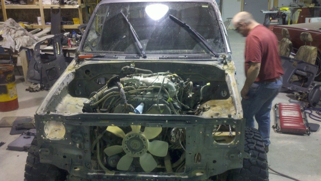

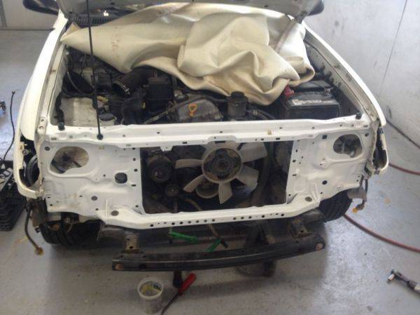

    So, help me figure this out, you guys...
    Check out this thread. Do you think he straightened out the core support, or cut and welded in a straight one? Man, I want to talk to this guy...

    I put a new one in a 01-04 5 lug and it wasn't a bad job, just grind out the spot welds that hold it in and reweld with a new core support.
    The truck i did hit a deer and wasn't to hard to straighten where the fenders and core support match up.
    Pic

    I think you guys are on the right track... it looks like he cut and replaced his core support. Here's a quote I found:
    "I hopefully will get the passenger A-pillar thing worked out next week, then get the core support changed over to the 97, then i can start bolting stuff back together.... I don't really have the time either... it's just 30 mins here and there... "
