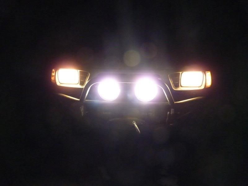

    Now, here are some outside shots
    Headlights on LOW
    Headlights and HIDs on LOW
    Glare: Standing a couple feet in front of the truck
    Glare: Standing about 10 feet in front of the truck
    So the beam spread is aimed lower than my headlights, but these things are BRIGHT. I'm not sure if they blind people or not... I'll do more testing to see.

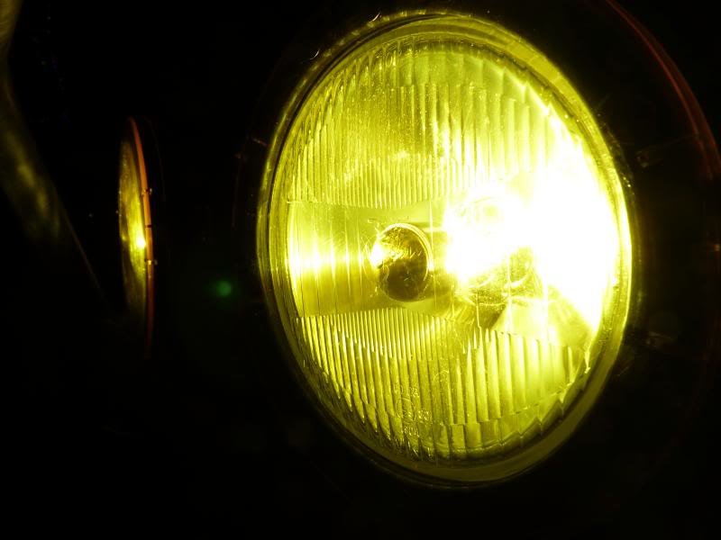

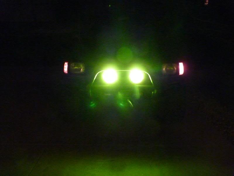

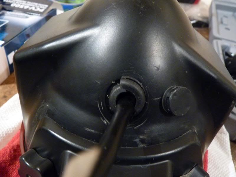

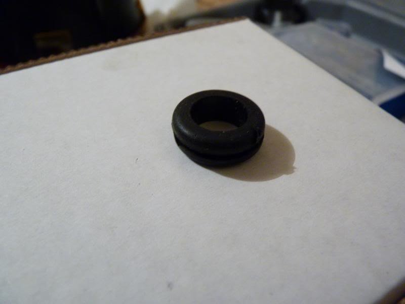

    So, I completed the finish work on my HID setup.

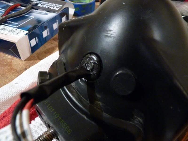

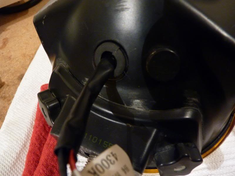

    I figured out how to seal up the pass through on the back of the housings.
    First, I got a couple of grommets from Ace Hardware:
    Then, I fit them into the hole and cut them down to size
    Then, I used "The Right Stuff" to fill in the gap and waterproof the pass through. I think this should work out pretty well!

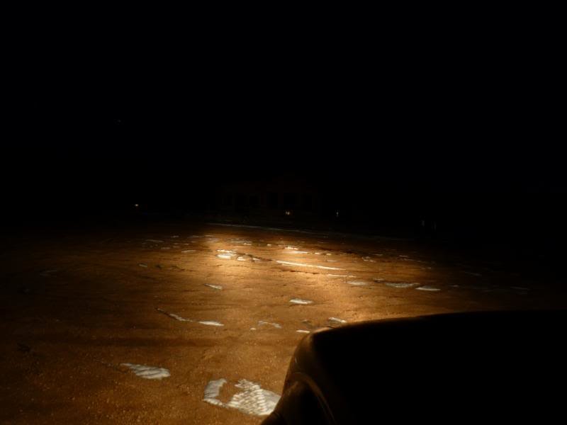

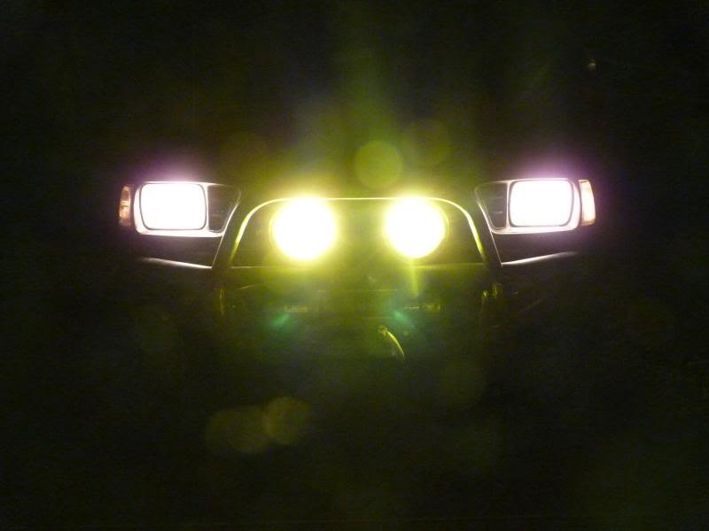

    Also, here are a couple of pics of the yellow filters on the HIDs.
    When they warm up, the light is green:
    But, after a little while, it is a pure yellow. I like it and can't wait to see how they perform when snow is falling!

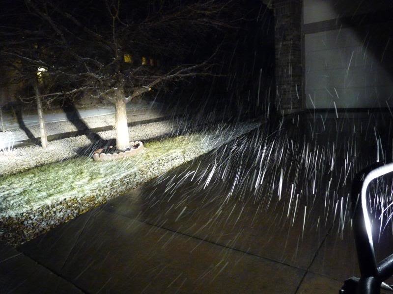

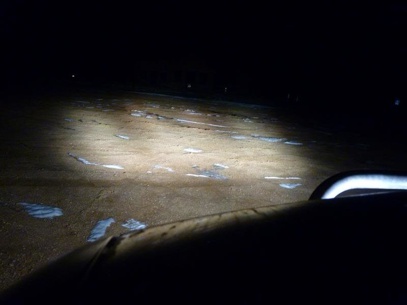

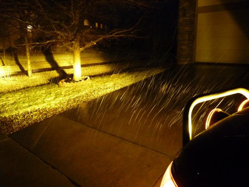

    I grabbed a couple pics when it was snowing last night, to show how well the yellow filters work. So, the pictures don't really show the true difference, but you can kind of get the idea.
    First off, no yellow filter: (my camera did some sort of digital glare reduction on here... there was more show than shows up)
    Same shot with yellow filter (this is pretty accurate)
    Here's the view from inside the cab:
    Overall, I'm pretty happy!

    Glad the lights worked out man. Even the low beams look too bright to drive with oncoming traffic tho IMO. Are they?

    So, I've got them pointed WAY low right now. The hi beam on my HIDs hits my low beams on the headlights. I followed my buddy for a while and he said that the HIDS are just a little brighter than my headlights (which are really dim) So, for now, I'm safe. I'm going to run it this way for a while, then gradually aim the HIDs higher until the low beam is just below my headlights and the hi beam is just above. (unless they start to flash people of course) Even where they are, they are awesome on the street! I can't even tell if my headlights are on or off!

    Hey Blackdawg, here's another pic showing glare for you. It's really not that bad
