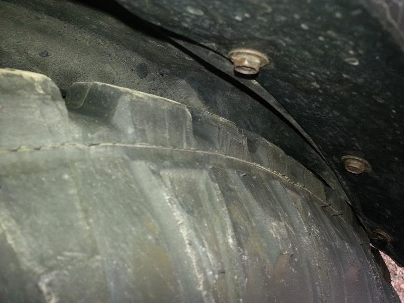

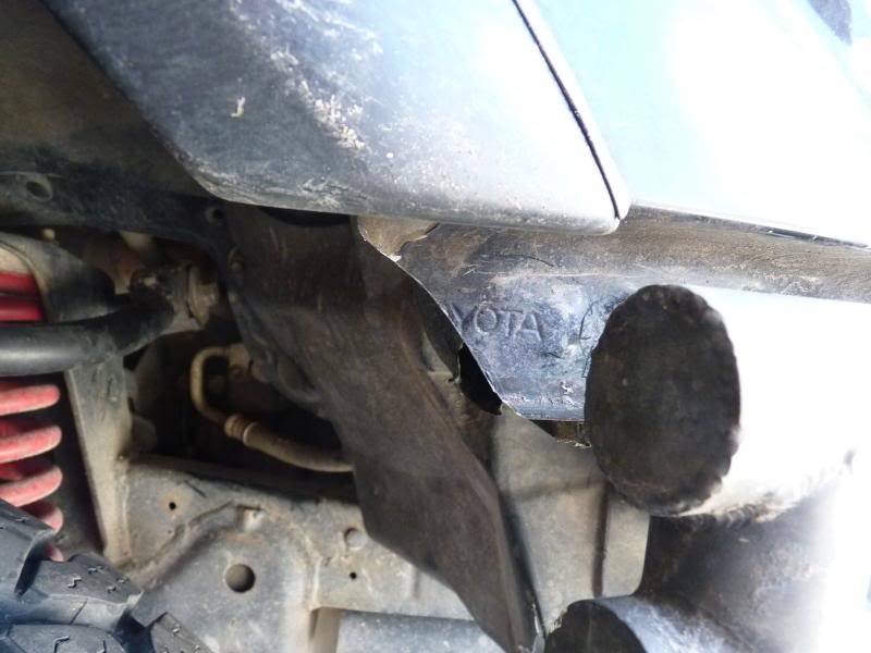

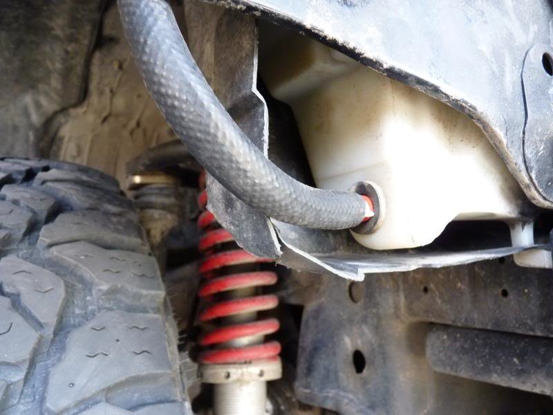

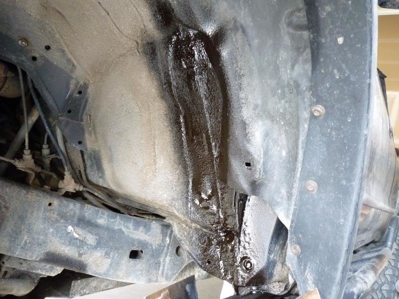

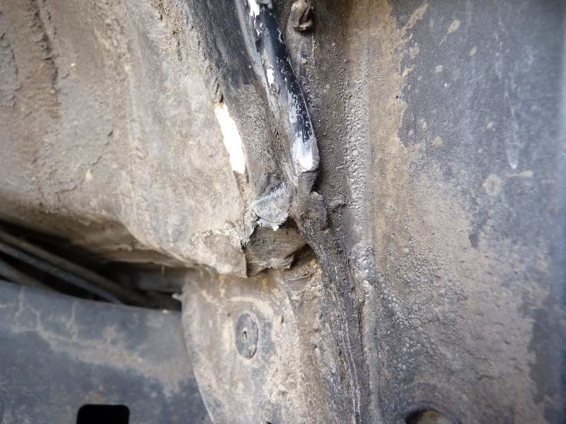

    So... I relocated my windshield washer reservoir pump to get me a little more clearance:
    Then I trimmed this guy:
    down to this:
    And I pounded my rear wheel well down a bit:
    And undercoated it:
    I'll head out tomorrow and see how I did!

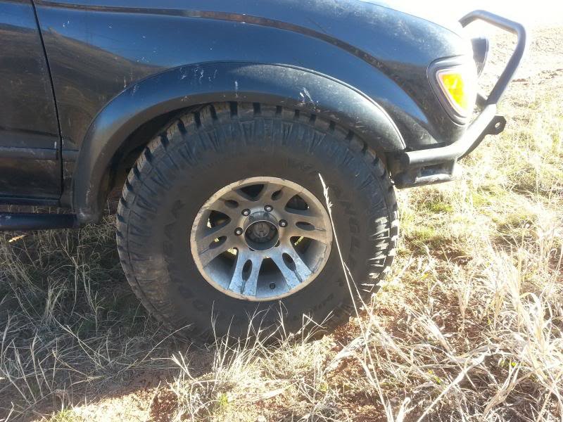

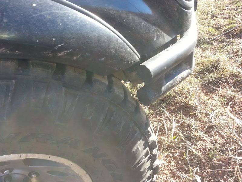

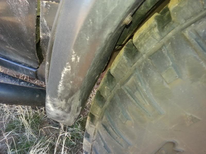

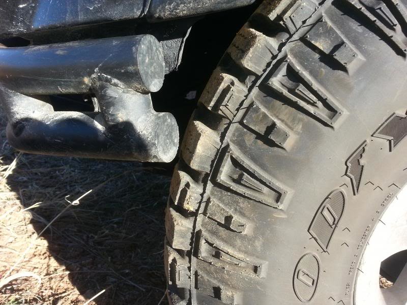

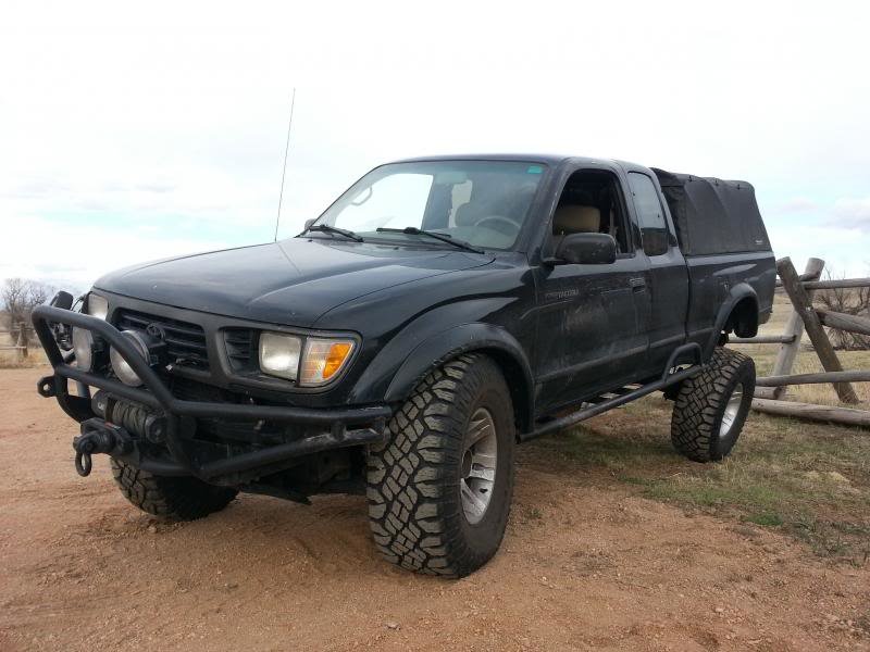

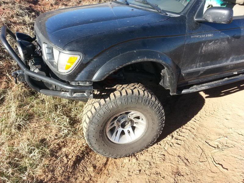

    Tested out my clearancing and it looks like I'm really close to being done.
    Here's the passenger side under full compression at the worst angles:
    Driver's side, full compression, worst angles:
    Here's a shot from farther away. Full compression fits a 33 pretty nicely!
    This isn't full extension. I'm pretty happy with how the front is flexing!
