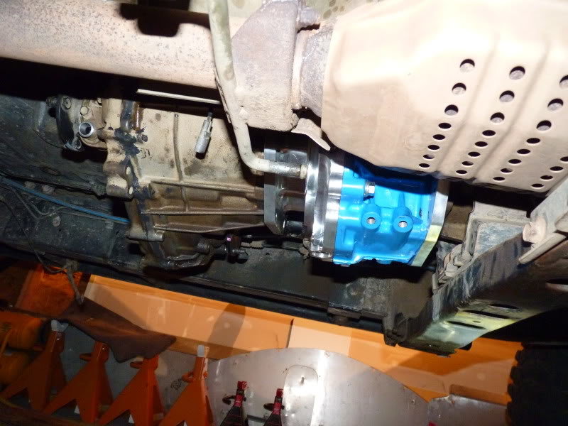

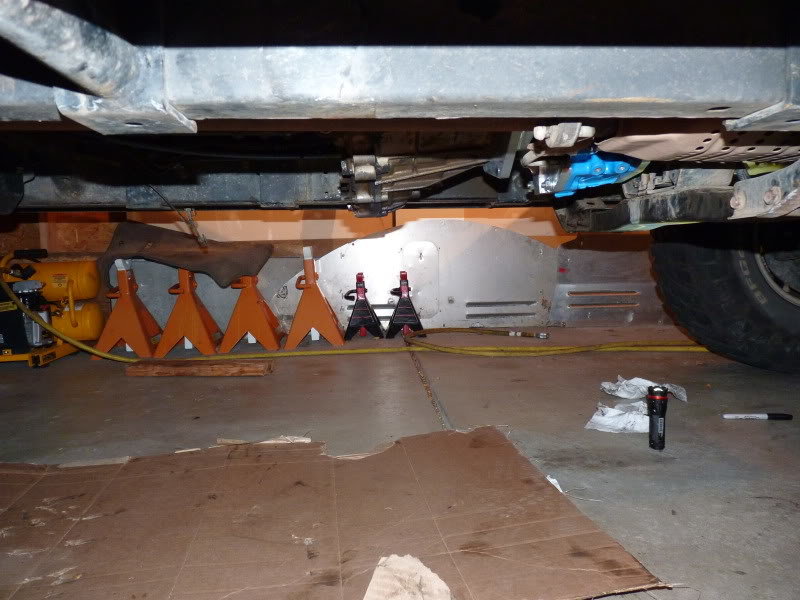

    Lump clockng your case at 15° does it clear the rails all the way?

    Hey Paul,
    So, the bottom of my case ALMOST clears... there is one bolt location that barely hangs under. I figured that it was enough to make a nice flat belly and not ruin my underbody too much Here are some pics:

    Thanks for the pictures. Mine hangs down lower than that. I'll post pictures on my build
