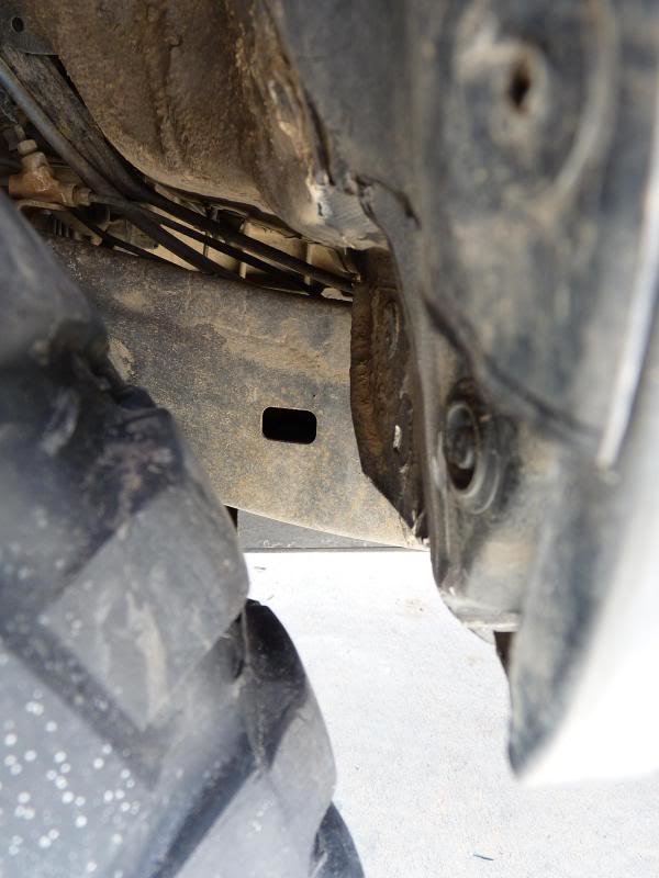

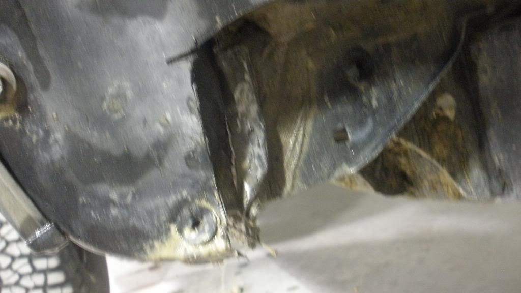

    Here are a couple basic shots... just trimmed the pinch weld back
    Before:
    After:
    How much more trimming to you guys think I'll need to fit 33x12.5s. (I have 4" backspace wheels... I think)

    My wheels are 4" BS and they aren't far enough. Will rub on the frame at full lock.
    So I added spacers. I had my old 1.5" ones left over. But some Borja .75" would be better. The farther out the tire gets pushed the more fender and pinch weld you have to cut/hammer.
    I had to cut a lot on stock fenders. And even my glass ones I had to cut. If you don't want to 33x10.5s would fit no problem with how you have it trimmed.

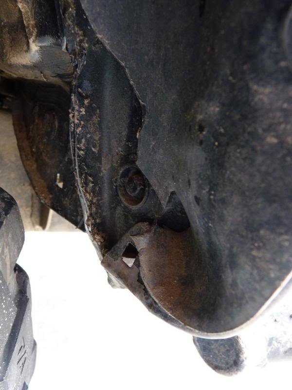

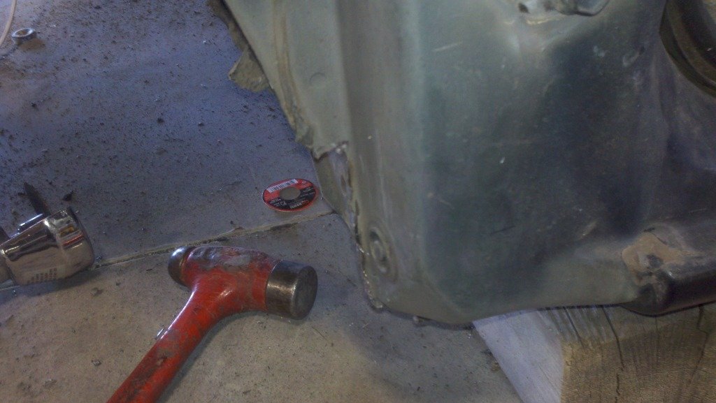

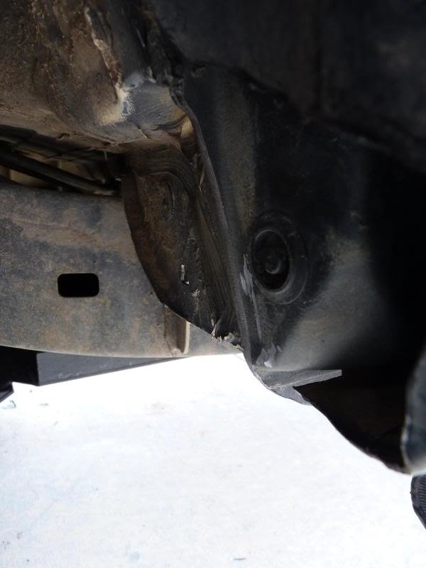

    here are some photos..can't remember which phase of cutting i was at..i had to go back 4 times.
    This was the old body..
    now the new body i litereally cut ALL the pinch weld out. Hammered it down and trimmed my glass fenders..no pics of fenders i think..
    Sorry i don't have as many pics as i thought..as ususal..:frusty: :eek:
