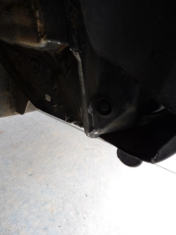

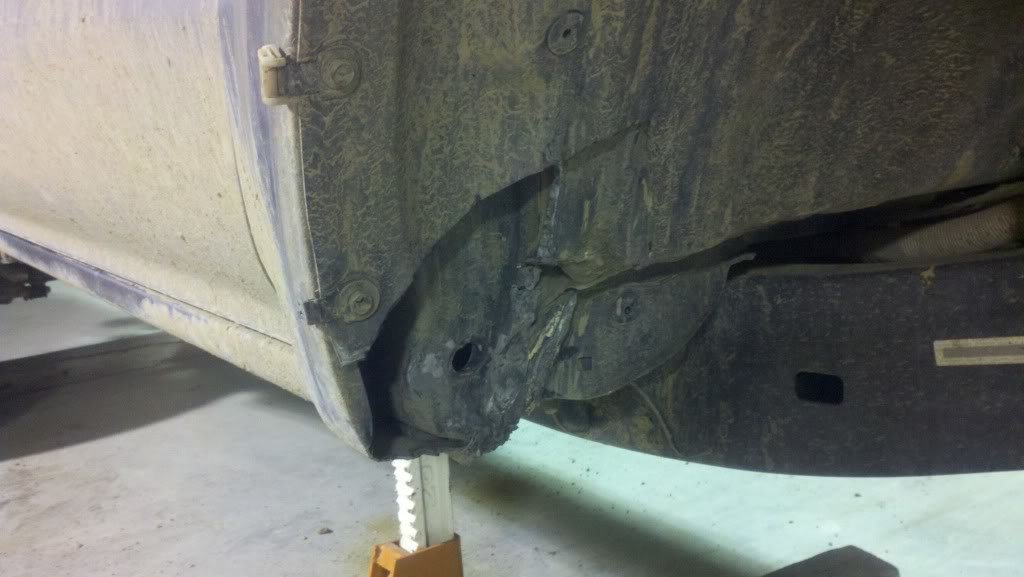

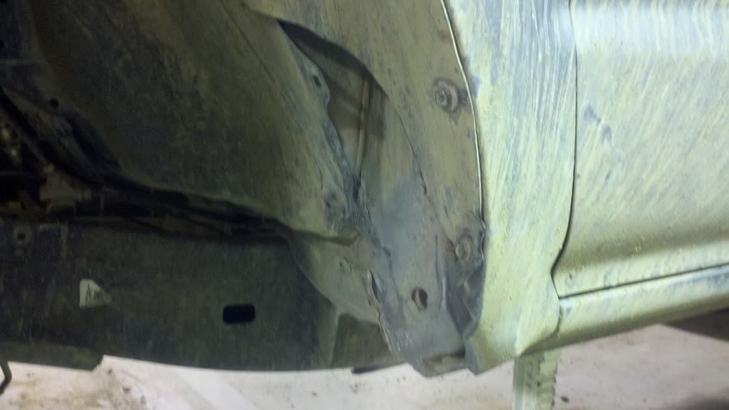

    Also, I found a couple more pics of your trimming job. Mine actually look pretty similar, I've already trimmed the fender at the very bottom... I just need to grind down what left of my pinch weld to make it flush, right?

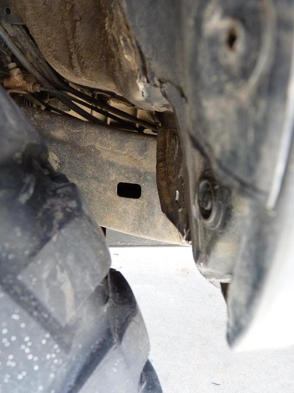

    Here's mine:
    You can see the body is trimmed straight out laterally from the firewall. You think it's enough?
    Here's how far I ground the pinch weld. Do you think it needs more?

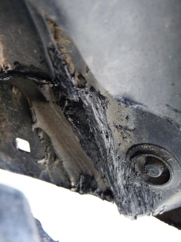

    Here's the final product, just as an FYI to readers

    Haha! Awesome you found em. And actually I end up cut more then just the bottom of the fender. I ended up cutout that whole bolt mount you can see and rolling the fender in on itself.
    BUT that is due to my outrageous BS. 2.5". If you got smaller spacers for the front like .75 I'd guess you are pretty close for 12.5s. But probably have to trim up the fender a bit
    For 10.5s I'd say you almost done.
