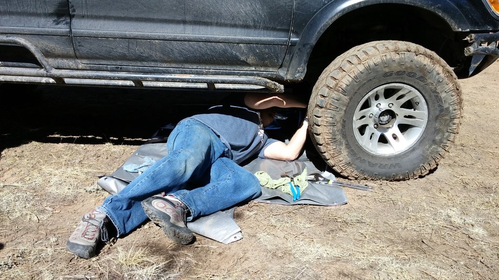

    Wheeled China Wall on Saturday with some friends and ended up blowing out the passenger side end of my steering rack. It looks like the "end cap" of the rack had slowly been unscrewing over the years and, when it was on it's last thread, it popped off. Fixed it on the trail and stole some PS fluid from each of my friends to get me home. Hasn't leaked so far but I think I might get another rack, just to be safe.

    Wow, glad you made it back ok. When the cap came off, does it just spew fluid, yet still allow armstrong type steering? Or is this something that leaves you with no steering?

    Yeah, it just spewed fluid and I "strong armed" the truck to a nice flat spot.
    FULL STORY (in case anyone is curious): I was lining up for another try at the rock in the video when my truck made a big "pop" noise and immediately started leaking a lot of fluid. We shut the truck down and inspected it, finding that the passenger side of my steering rack had popped it's "end cap" (don't know the real term) off. Upon closer inspection, it looks like that cap had slowly been unthreading itself and, once there was less than one thread still engaged, popped the cap off. The inner seal had moved outward about an inch as a result of being unrestrained by the cap. Using the combination of an adjustable wrench and a deep socket. I lightly tapped the end cap against the seal to drive it far enough back to engage the threads of the cap. With the cap threaded, I slowly drove the seal back into place, using the threads to draw everything together. So far, no leaks!

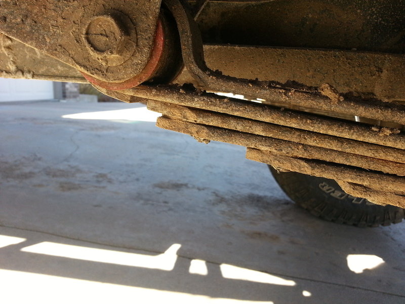

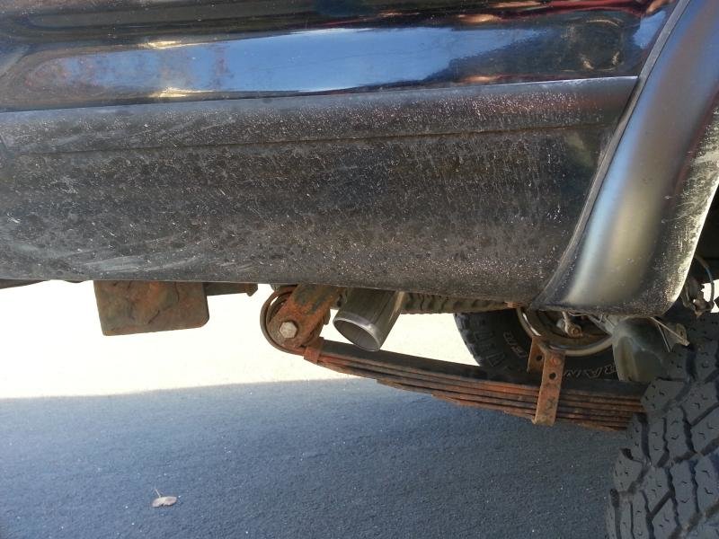

    In other news, I got to see my truck crawl from the outside this past weekend and discovered that my rear suspension is way stiffer than I thought. I think I might remove 1 or 2 leafs from the rear.
    My thought is removing the 3rd from the top leaf as it supports almost an identical area as the leafs above and below it. Any suggestions as to which leafs are best to remove vs keep?

    If you're gonna remove a leaf. Remove the one right under the main leaf.

    ^Yeah, that's what i'm thinking. The plan is to remove the first non-military wrapped leaf and then one more farther down the pack. I didn't think I should remove the one below the main, since it wraps around the main's ends and supports the orbit eyes.
    Any advice for which farther down leaf to remove?
