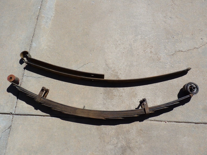

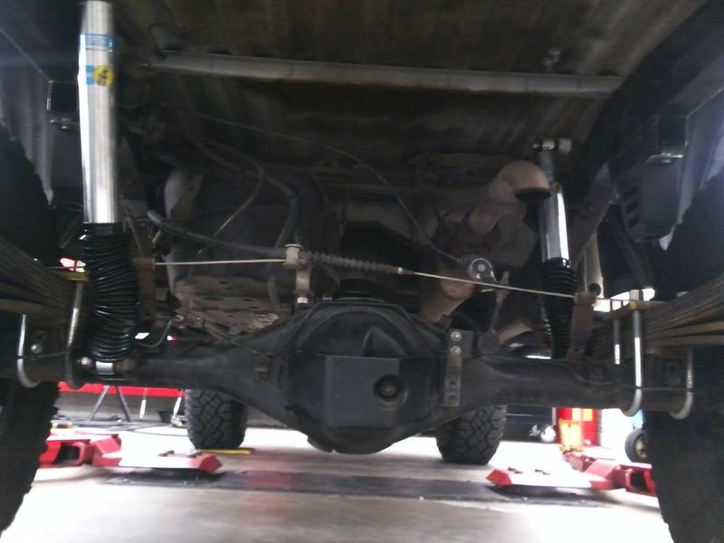

    I pulled two leafs out of my rear spring packs today. Because everything was crazy and unusually rusty, the job took me 7 hours! Thank, Rick, for stopping by and helping me. Long story short, my rear springs are much softer and way flexier now. Plus, my orbit eyes are actually working! I need to go to Glen's dock and test to see how much I gained, but my regular rock will not flex my truck out anymore. Overall, the travel numbers might not be too different, but the behavior within that travel feels WAY better. I think I'll be running a lot more obstacles open diff now.
    Pics:
    Springs removed:
    Basic flex shots... the suspension isn't flexed out here

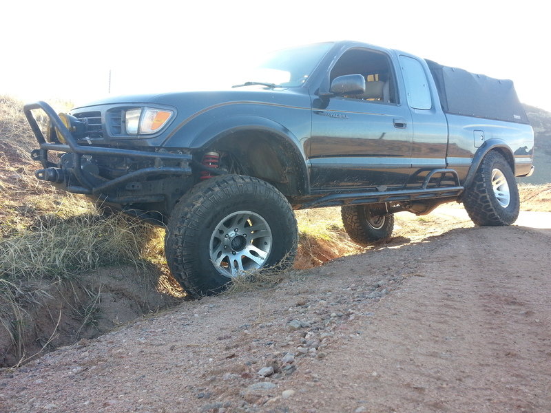

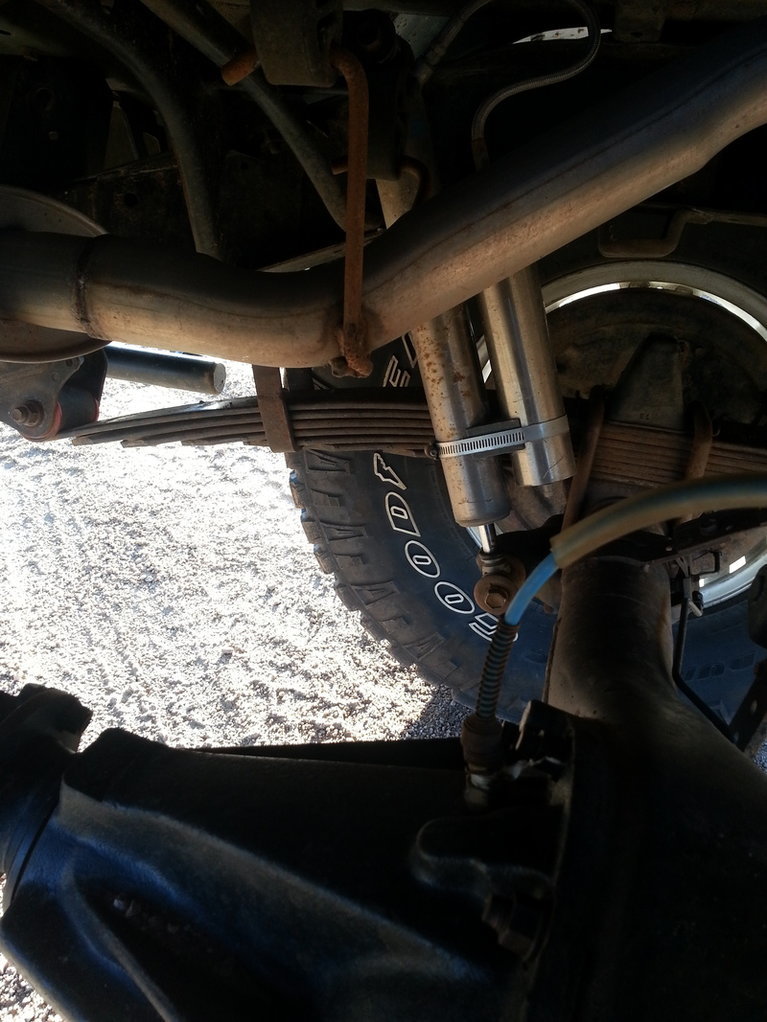

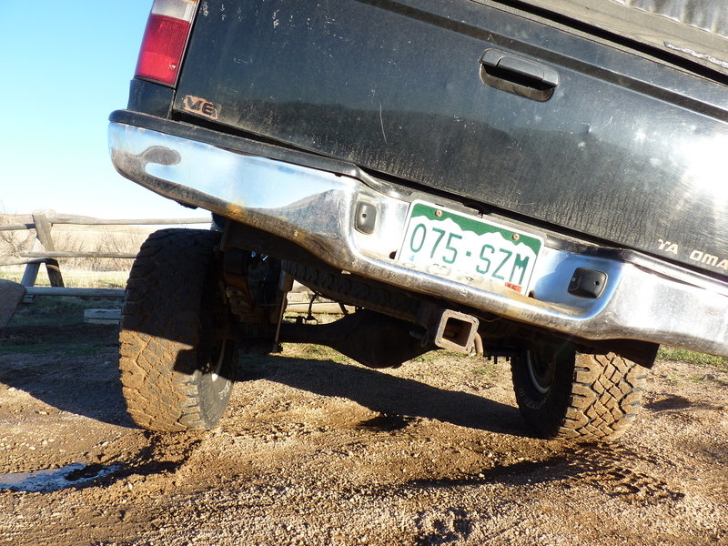

    Here are a couple more pics I took. It looks like I'm getting a bit of negative arch out of my springs now. I'll call Alcan and see if I need to install extended bump stops.
    The orbit eyes are stiff from lack of use, but they're working
    Negative arch

    So, what's everyone's opinion on negative arch? It looks like I'm getting about 2" of it on full compression... Is that too much for safety?

    In my opinion, no. Flex away. You'd be surprised how much bend they can take before snapping.

    Hey Brett,
    Thanks for your input! I called Bill, at Alcan, this morning and he agrees with you. He says that the springs "can bend both ways" and I shouldn't worry about it.

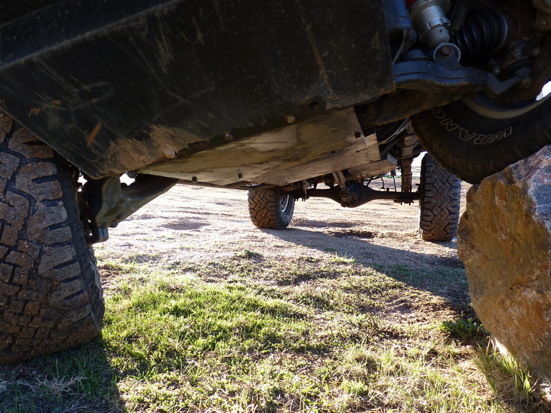

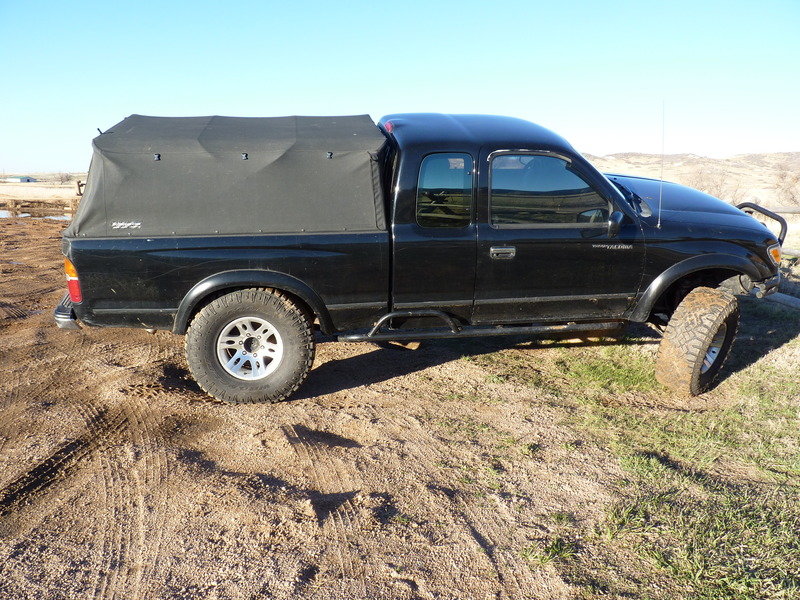

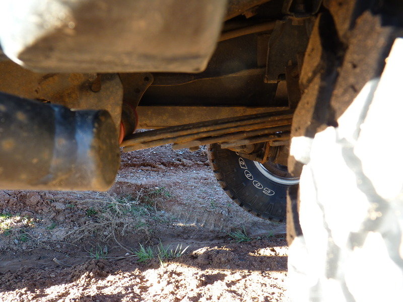

    As a reference, here's what I was seeing under the truck:

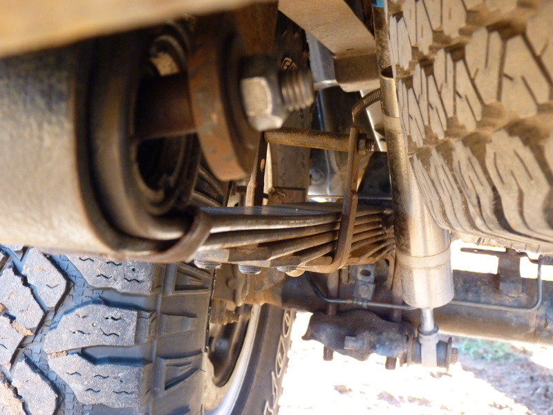

    Here's the tire when the spring is in negative arch:
    So, I guess I'll leave everything as it sits for now. I went to the loading docks to day and measured just under 27 vertical inches that I can climb before the back tire gets light. One more inch and I'll hit my goal.

    Yea I do t care about negative just don't let it stay like that for an extended period of time and your fine. Mine go negative all the time.

    I would agree with everyone else.... to an extent. My leaves go negative as well just like others have said theres do. I agree i dont think its a big deal as long as it doesnt sit there for a long time. They are springs, they return:)
    I took it one step further with mine though. In regards to bump stops, i moved my mount down, installed a u bolt flip kit and mounted a much taller and squishier bump facing down. I flexed it out til it lifted a tire and found the bump would be compresed about an inch. close enough:) for what i do....
    But the difference between your setup now and mine, is when you are cruising down a dirt road and miss that big dip, your springs will compress fully negative and rebound relying completely on the shocks.
    Mine will hit the bump stop and slow down the rate of compression, helping the shocks out and resulting in a smoother ride. I tell u what man, bump stops, even my cheaper rubber ones(dont need air) make a huge difference. Especially in the front.

    Thanks for the input, guys. I guess I'll leave everything as is and enjoy the new articulation. I only gained 1 vertical inch on the loading dock RTI ramp I use but the range of motion is a lot smoother and more usable.

    Im going to disagree. I wore out a set of 8leaf deavers running no real bump and going negative a lot. Looking at that last picture i would move the bump stops down until it goes just barely negative.
    Yes i know my shackle angle sucks lol.

    Eh. All springs are wear items. They all need replaced at some point. How you use them will dictate thier life.

    So are tires, but you still rotate them, ensure they have proper inflation and align your truck to extend their life and performance. Properly bump stopping your springs do the same thing. My rear suspension performs much better now that i have everything mostly sorted out and working as it should. Also i was either breaking a shock or a shock mount once evrey 5 wheeling trips and i attributed it to lack of proper bump stops since i drive like a grandma off road (200+:1 does that too ya lol).

    If your breaking shocks then you obviously have poorly setup shocks or need to put in bigger bumpers. As you did.
    But I'm going one 3 years of hard wheeling on my leafs and they still hold all 6000lbs of fat Frankenstein and still flex freaking good and go negative.
    Yes it'll extend their life. But I wouldn't really be worried about that if its a rig. Most leaf springs that get used and abused a lot won't last more then 3-5 years anyways.

    Good discussion. I'm going to keep a close eye on my leafs... If I see any sign of fatigue wear, I'll extend my bump stops.
