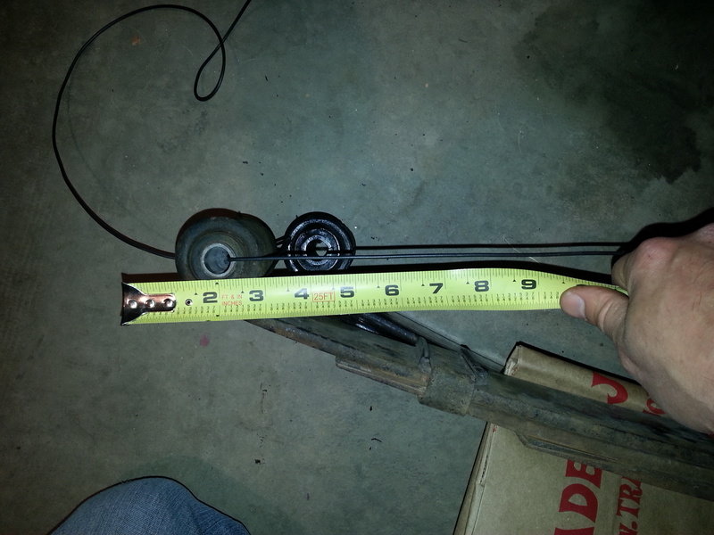

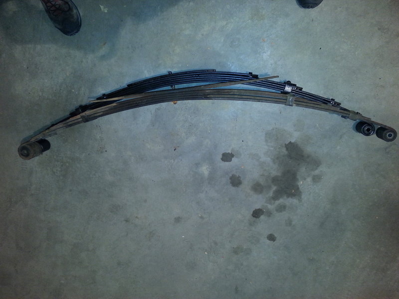

    So, mission Waggy Spring Install is a total failure. I argued with Alcan yesterday but, long story short, the springs are too short. (Sounds familiar doesn't it?) Alcan made a stock length spring, then arched it higher for 2" of lift. This made the eye to eye measurement too short. I will call them tomorrow and tell them that they can either make me new springs, to my spec, or they can take these back and refund my money. Has anyone else had trouble with Alcan lately? If you have post up... Bill says I'm a problem customer and everyone else is happy with the length of their springs. Long story short... I'm done with Alcan.

    That sucks. I hope Alcan saw those pics, those springs aren't even close. I'm surprised a company known for it's leaf springs doesn't understand the simple concept that lifted leafs are also longer leafs, has something to do with shackle angle and stuff :rolleyes:.
    As far as others being happy with their product, I have really only heard complaints from consumers using their product. Good luck, let us know how it unfolds.
