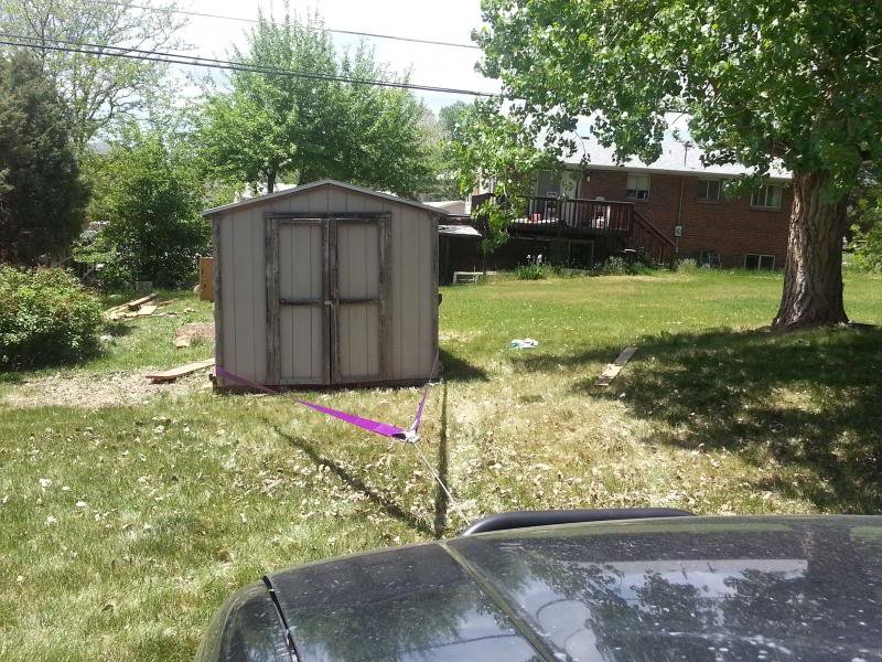

    I helped a buddy move a shed into his yard. He got it for free from his neighbor. We used the winch to spin it 180 degrees an just dragged it in. Worked out great, and was fun too!

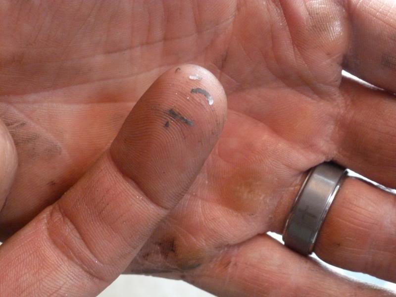

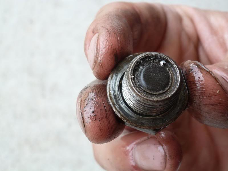

    Thanks for the info DavTopGun. The diff is draining now. PCBuilder14: Maybe the diff breather is more important than I thought...
    So, when I was draining my diff, I noticed that the oil looked a little "glittery". I looked closely at my fingers and saw that there were little silver metal speckles on it. I wiped the drain plug and saw more there.
    After I wiped the drain plug I saw this:
    It looks like larger metal shavings... I looked around and collected some of the larger shavings:
    Do you think this is poorly adjusted backlash? What do you think could cause this!?! Any help/expertise would be appreciated!

    Did you replace the gears when you did the locker? Some shavings are normal with new gears. If you're still using the old gears, I'm not sure if you're supposed to get some shavings or not.

    ^I didn't replace the gears, but you got me thinking... I broke the cage in my locker in Dec/Jan and rebuilt it. When the cage was broken, the locker would randomly engage/disengage. I wonder if some of those shavings are left over from that event. This is the first time I drained it since then.
    Plausible??

    So, I just refilled the diff and I'm going to run it as-is for a while. I a few thousand miles, I'll drain it again to take a look at the oil, looking for more shavings. If it comes out clean, maybe this is just left over from my locker carnage...

    That's a very good possibility.

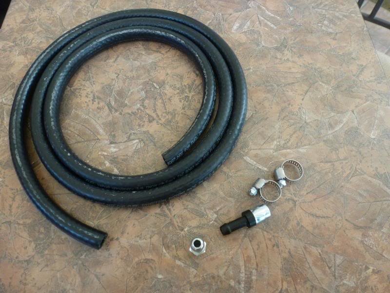

    Toytec 16" coilovers with Tundra Bilstein 5100s, Light Racing UCAs, Alcan Leafs with Orbit Eyes, 12" Bilstein 7100 short Bodies, ARB rear locker, 33x12.5 Duratracs, CBI sliders, Bushwacker fender flares, self made front bumper, M8000, Vision X 6.7" Hi/Lo Beam HIDs, full skids, Inchworm dual case setup - 15º clocking
    Got the parts ready for the rear diff breather extension:
