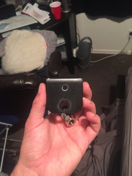

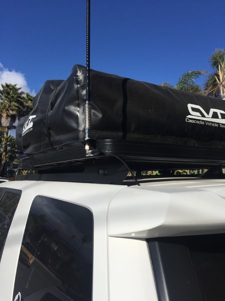

    I spent the last 2 days making an absolutely hideous CB antenna mount. I am proud of the result, but it is not pretty. Someday I will replace it with something nice.
    I started with a bottle opener that FrontRunner sells that fits into their rack and hangs off the side. I think you can see it hang off the side in this pic.
    Then I drilled a 3/8" hole in the top to allow for the antenna to pass through.
    After that, I needed to grind the bottle opener part to allow the coax connector to fit through. This is the ugly part. Original plan was to turn the hourglass shape into a square, but I needed more room so it is more like a fat batman symbol now.
    Finished product.

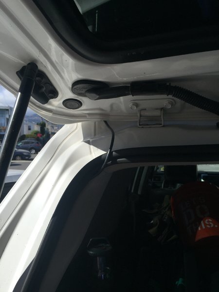

    Started the wiring. Actually much nicer than I thought. Excited to get it all hooked up next week.

    2008 dcsb trd offroad 4wd
    Did you make sure that the nylon washer shoulder fits in the hole?
  10. Apr 27, 2016 at 9:25 PM
    #550
    SixthSnail
    SixthSnail [OP] I have no idea what I'm doing
    Oct 3, 2014
    #139599
    13,289
    Los Angeles
    '14 Tacoma Sport
    See Build in Sig
    No. Is that a thing?
    Ya and it's super important. The stud cannot touch metal otherwise it grounds the antenna

    God dammit

    Is that the problem you were having?

    Can I just wrap the antenna in rubber?

    Now I'm gonna have to drill it bigger and repaint again...

    As long as the top of the stud inst grounded you are good
    No ):
    Just drill a 1/2" hole

    Lol I'll have to. I only had up to a 3/8 drill bit...

    I havea1/2" if you wanna borrow it

    I may take you up on that tomorrow or next week.
