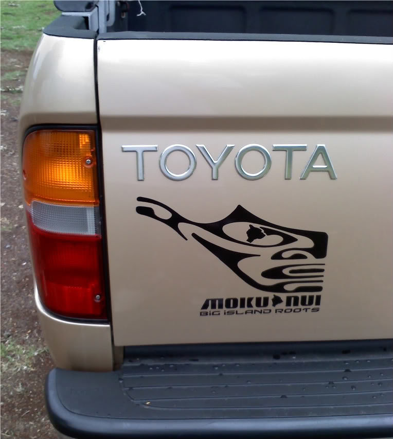

    various stickers for added torque, HP, and flex
    Sockmonkey vinyl retro hood stripes

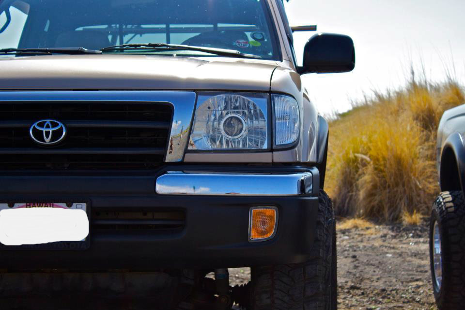

    Those headlight assemblies just weren't cutting it. They began to turn yellow no matter how much I kept them waxed and used Meguire's cleaner on em...

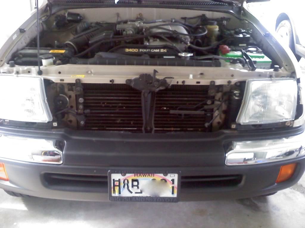

    Next mod- Diamond pattern clear headlight assemblies/ Clear corner / clear turn sigs.
    Before
    During
    After

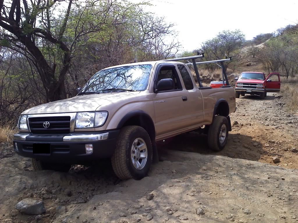

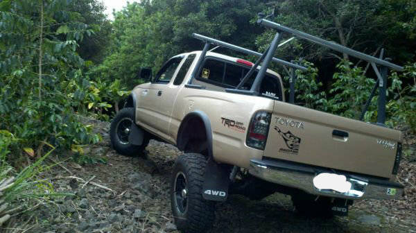

    Stock wheeling. Makalawena trail on the Big Island.

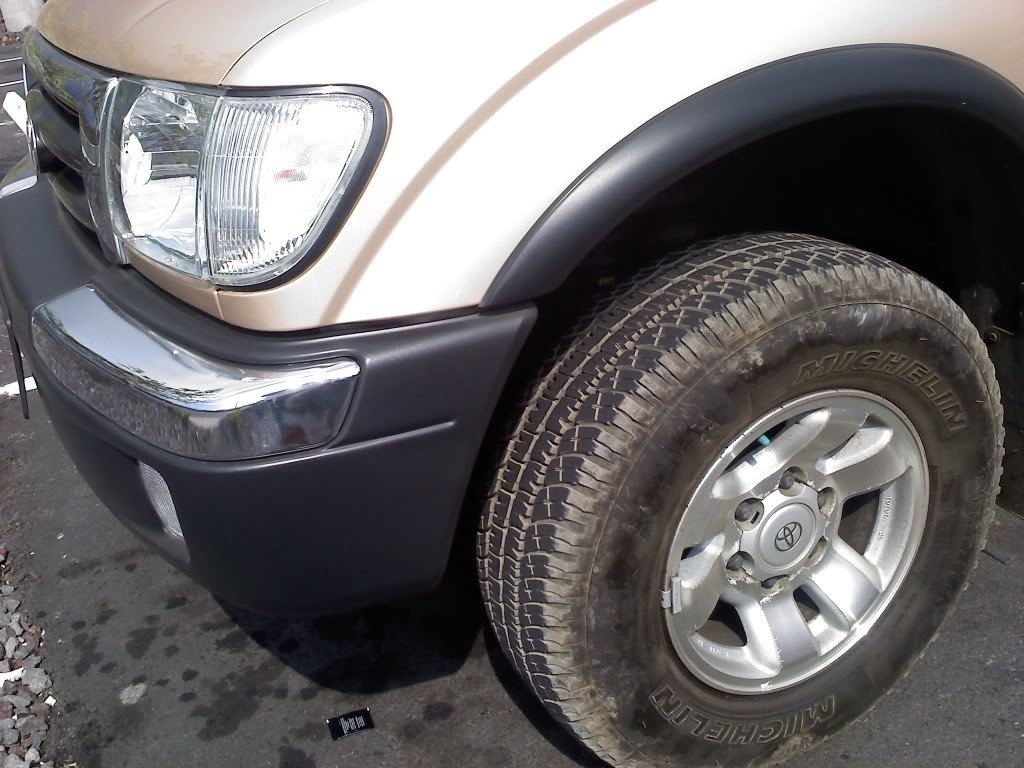

    As an added mention... Michelin LTX AT2 tires are great all terrain tires.

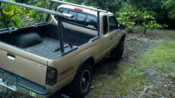

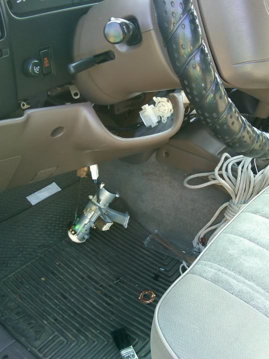

    Went to a halloween block party, and when I came back... Stopped all mods for awhile to make sure everything was put back together. "Like a good neighbor, state farm is there! With a new ignition!"
    75374_1687912963601_1410998042_1765426_3_60e296d6e780e0a2e396288019170e22669e78ad.jpg
    I wasn't really ready for suspension upgrades yet, I just wanted to make her look "unique"

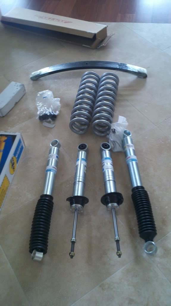

    Suspension time:
    Bilstein 5100 shocks (F/R)
    Toytec/Eibach 3" lift coils
    Toytec 2" Add-a-leaf
    Toytec 1" differential drop
    (Thanks DOWNSOUTH MOTORSPORTS and TOYTEC LIFTS!)

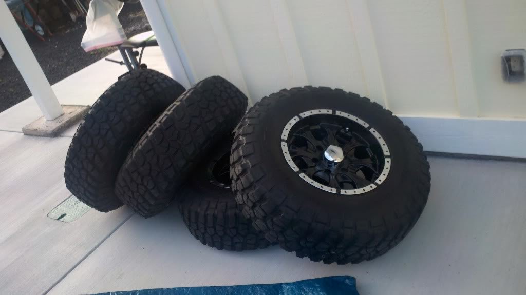

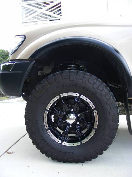

    Had the sudden realization that I was neglecting to add wheels/tires...235/75r15 looks small stock..and now with a 3" lift...I began the search for rubber.
    A friend of mine had been trying to sell his tires for awhile. After the lift I decided I needed to go bigger than 235/75r15, so I bought them from him.
    Helo HE791's in gloss black wrapped in 265/75r16 BFG KM2 Mud Terrains
    After a search for lug nuts (Something I neglected) She had some new shoes.

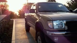

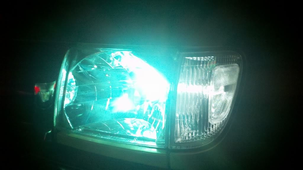

    Added some white LED's in the parking lights. Blinker is still amber for safer turning (looks more legal).
    Also added a 5% tint strip up top, TW decal, and 35% tint on the sides

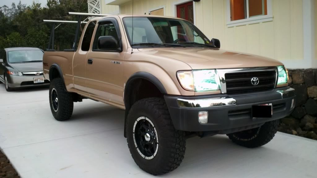

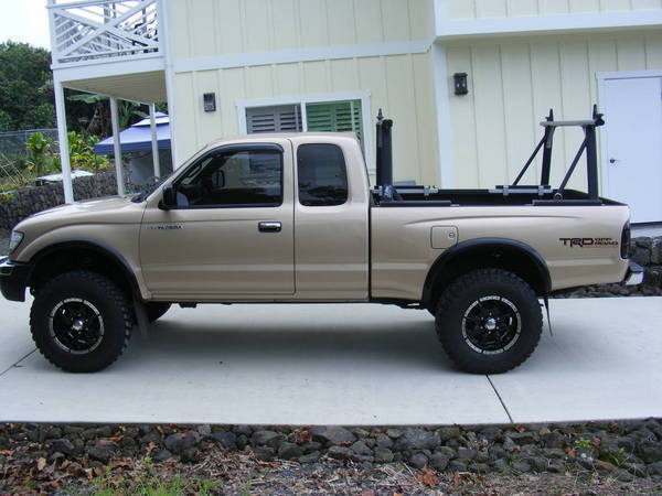

    How she sits now (12/10/11):
    Wheeled like that for awhile, then

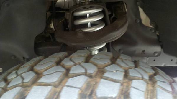

    I loved my toytec AAL, but with the amount of wheeling that I do, an AAL on an already-sagging stock leaf pack wasn't the best idea.
    I was also running the original 5100's from DSM, before the bottom-out incident, so mine were stock length.
    They needed to be switched out
    as of 6/12/12

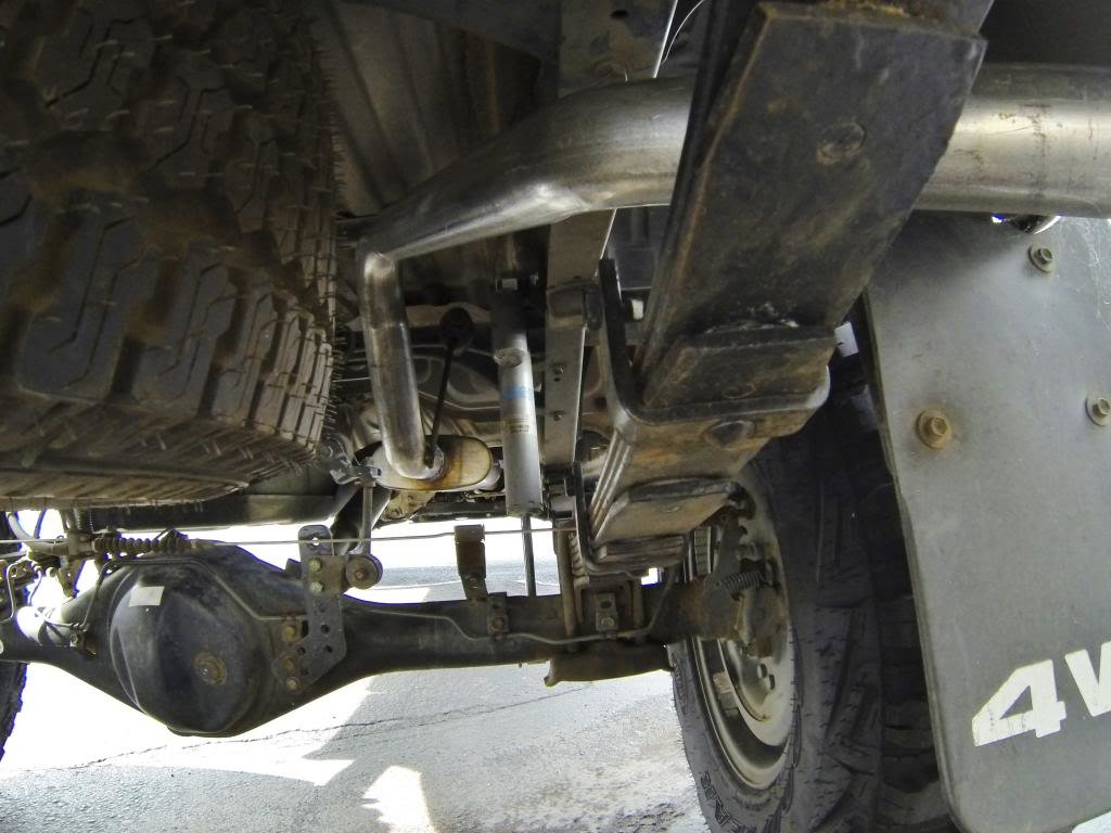

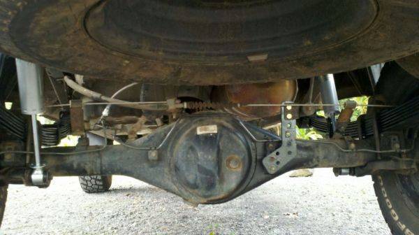

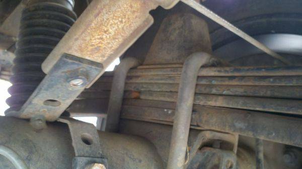

    Swapped the rear suspension.
    All pro Expo leaf springs
    All Pro extended SS brake lines
    10" bilstein 5150's

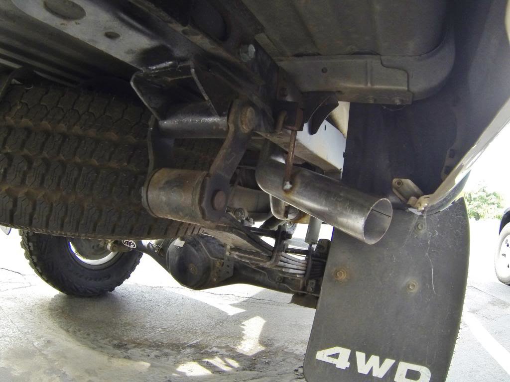

    OME Exhaust relocate
    B.A.M.F 5.5" BPV relocate

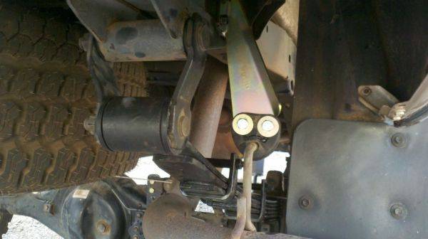

    Waiting on a Beefed Taco Carrier Bearing drop to install All Pro 1.5" shackles.

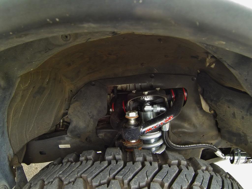

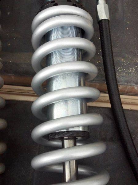

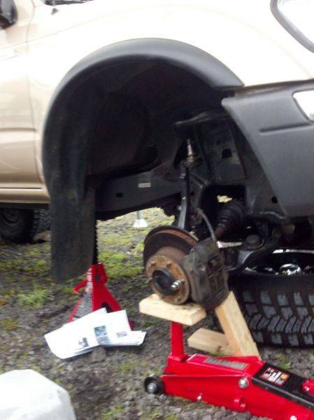

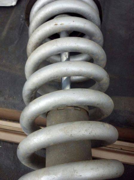

    Then I decided that I had the money... I was going full mid travel.
    Installed:
    All pro tubular chromoly upper control arms w/1" uniballs
    Fox extended travel coilovers w/ 14" 600lb eibach coils
    Did all the work myself, to start learning how to wrench...
    If you swap the front joints...GET A PULLER. What three hours of hammering couldn't do, a puller did in less than two minutes
    Old: bilstein 5100 w/eibach/toytec coils
    New: Fox 2.5" body extended travel remote resi coilover

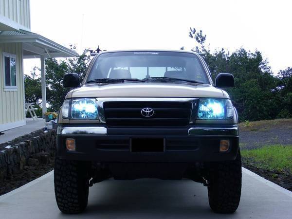

    Lighting:
    Headlights I've used:
    PIAA Xtreme Whites
    8000k HID
    Morimoto Mini H1 w/6000k HID (Current)
    8000k HIDs
    Morimoto mini H1's with 6000k HIDs

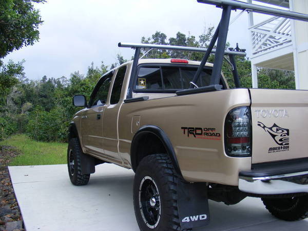

    These ones are 31.5x10.5, so they're exactly in the middle of what you have and what you asked :cool: So far, I'm loving these KM2s. Quieter than the Yoko M/T's I used to have.

    Where did you pick up those headlights?? Mine are starting to yellow badly, and I like the look of those!!! Good looking truck.

    I am sooo glad to see pics of a truck with 31X10.5 on a 3'' lift! i just bought my KM2s and then decided to get a lift...:facepalm:stupid choice..lol but i love the KM2s as well and now i have faith i can just get spacers for a more aggressive look and be happy!
    keep it up man

    I got these on Ebay, searched for a quality one..When I was doing aesthetic mods I was short on cash, so most of the things I got came from ebay.. Just search for clear/diamond headlights and a ton'll pop up. I've had these on for almost a year, and as long as you keep em waxed they wont yellow.
    Driving around with 235/75s on a 3" lift drove me crazy! haha
    I like these KM2's way better than my old Yoko M/Ts. I can actually have a conversation in the cab without yelling.
    Spacers might make the ride a little stiff, but it should look great! :proposetoast:
    Since the install, there hasn't been any sag from the AAL, I'll keep measuring in the coming weeks for you; and as far as the diff drop, theyre a pretty simple install. Shouldnt take more than an hour with the right tools
