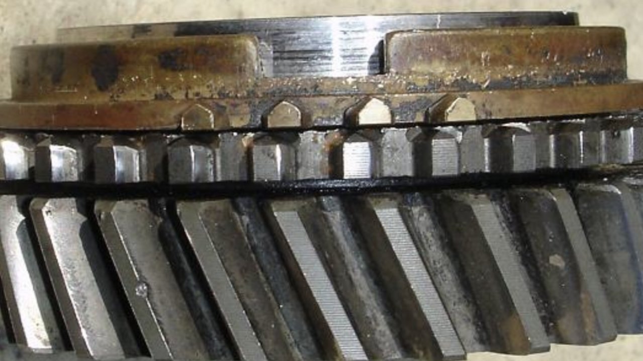

    That is correct GL-5 trashes yellow metal the Toyota synchronizer pictured below has worn so much it bottoms out and no longer grabs.

    So can this oil sit in the transmission for a few days without damaging it too much? Would driving it accelerate the damage caused?

    It will be fine for a few days, change it as soon as you can to a proper MT fluid.
