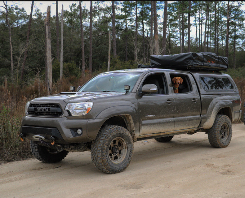

    I have the medium Dakars leafs with a topper, prinsu toprac with a RTT that is on occasionally, the mediums seem to support this just fine, although any more weight and I’d be front end high. I decided to get a HC rear bumper with a tire carrier and I don’t think the mediums will be able to support the weight over time. Is adding a leaf to the mediums recommend and my best option for this? I plan to install bumper and see what it looks like first, then placing the order if needed. 8A3445F6-E949-4012-803C-A31A057090CF.jpg

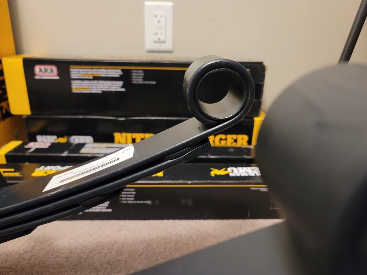

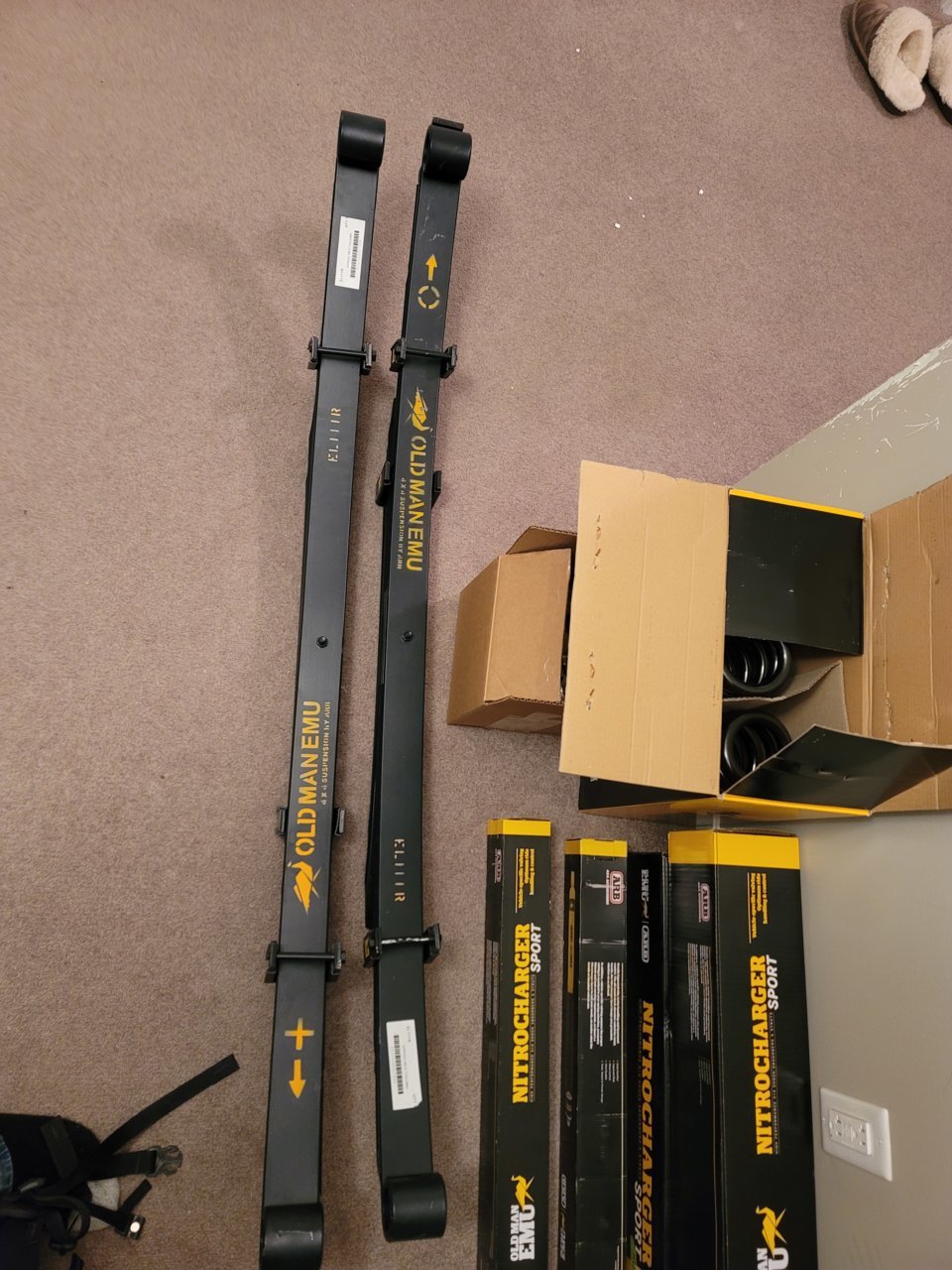

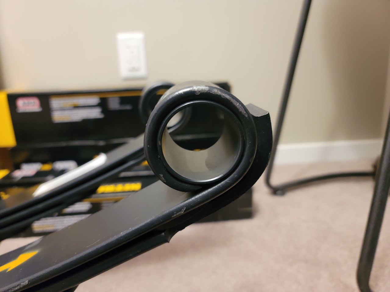

    Hey folks. Sorry in advanced for the dumb questions. I'm about to install my OME lift next Friday and just wanted some clarification one some things.
    1. Should the arrows on the leaf packs be facing the driver side or the rear end? I heard that the heavier wrapped end should be facing the rear and arrows pointing to the front of the vehicle but it looks like I have the arrows the other way around. Maybe I'm wrong..
    2. Is there anything I should cut/trim off the leaf pack?
    3. Should I add the spacer right of the bat for the taco Lean or not even bother?
    Thanks in advance folks!
    Also am I wrong for thinking the end with the little extra curl is the heavy end and should be put on the rear and the lighter wrap on the front?

    Wrapped end forward, + on drivers O on passenger. Yes on spacer.
