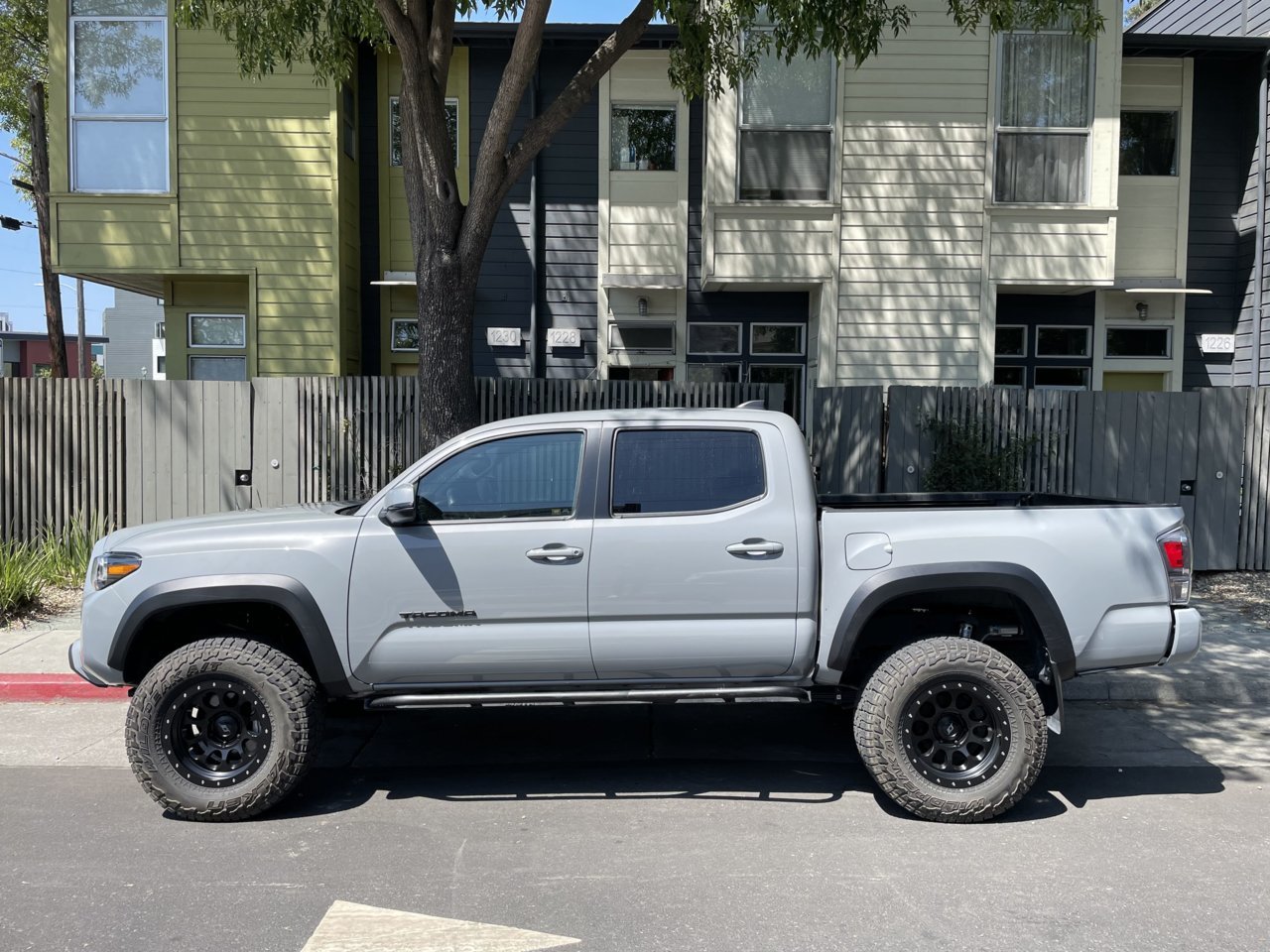

    Has anyone with the HD Dakar pack converted it to the medium? I currently have the HD but have removed my shell and rtt so no longer need it. From what I've read, I just need to remove the third leaf from the top to convert my set into a medium. Has anyone moved one of the bottom two overload leafs as well?? I feel like I might need to as I have crazy rake now and a really stiff ride.

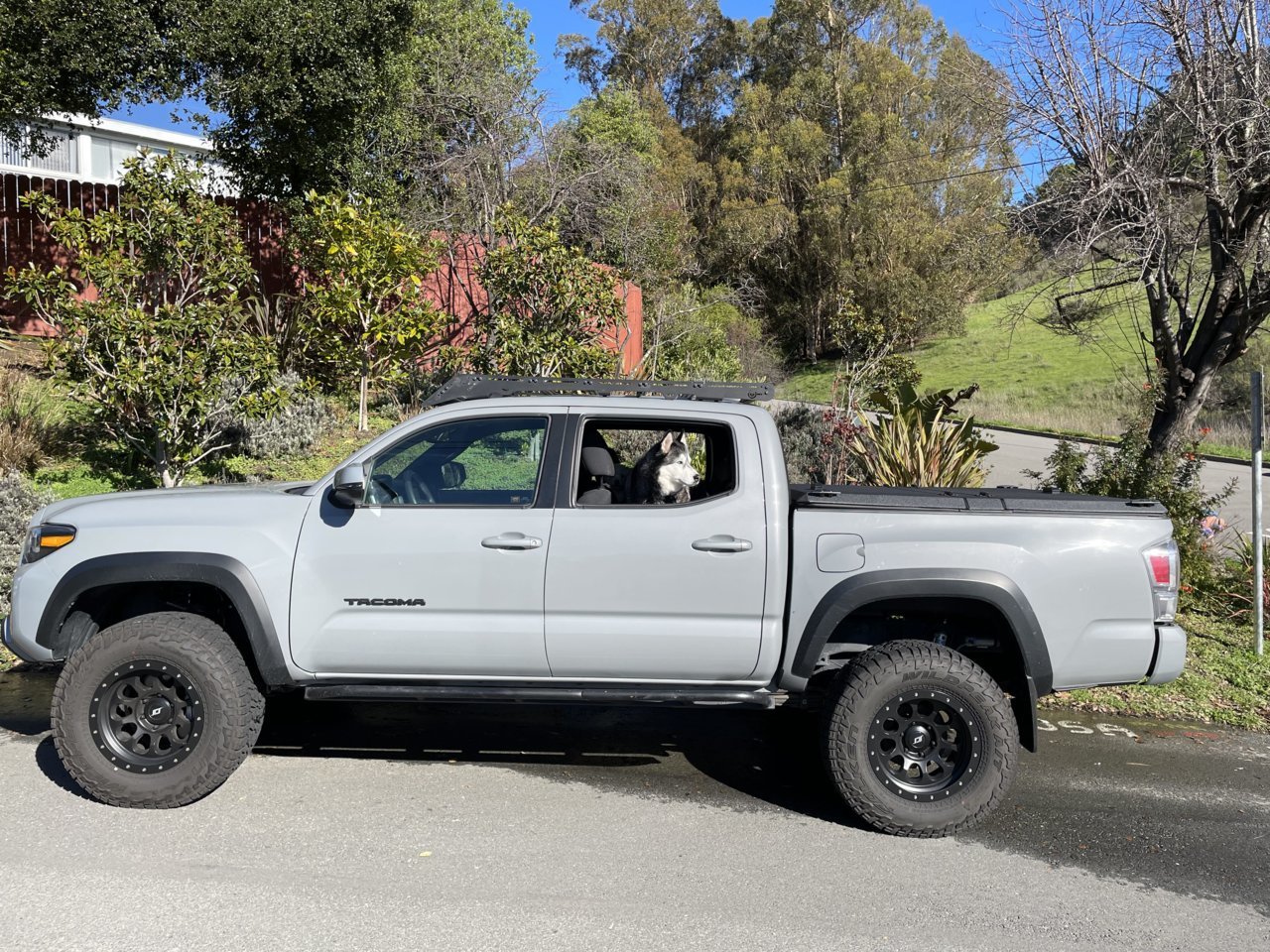

    Damn really? That sounds crazy, here is how mine is sitting now. Pic 2 is with the DB cover that's about 70 pounds, other than that there's nothing else in the bed. It's a little deceiving as I'm parked on a slight incline in that pic. Just from looking at the rear wheel well I feel like I could lose a good 2 inches before hitting bro lean territory.

    Jus the shell nothing in my bed. My MDs were shaped like a big saggy W

    I did this on my Tacoma. Pretty sure it was the 3rd leaf I took out. Left the overloads though. Put in a small block to maintain ride height. Ride comfort improved DRAMATICALLY.
