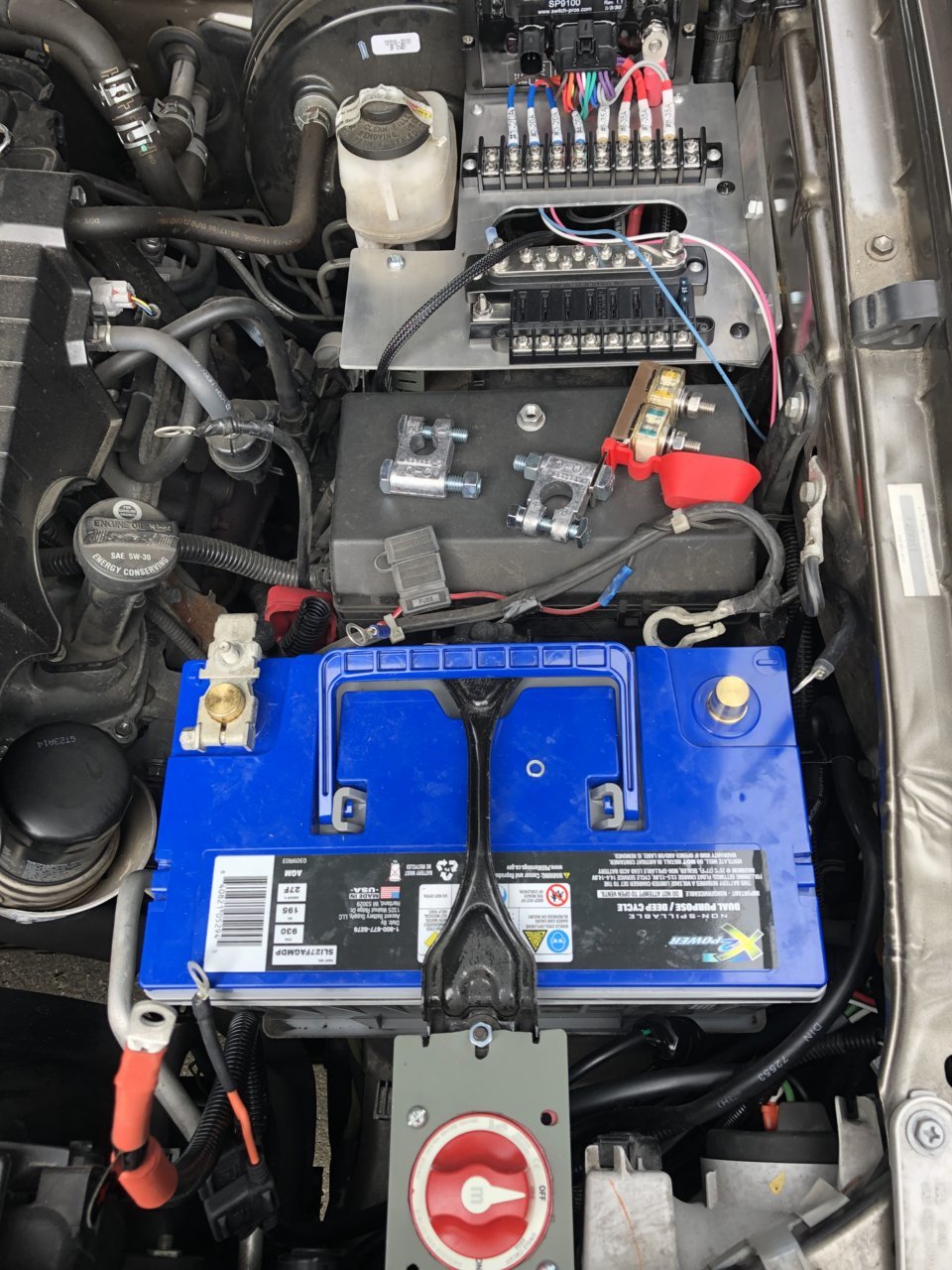

    Hey OP, just wondering if you have a pic of the tie down system you used, I made a new rear bar but am working on a battery design for my truck, Here is what I have right now, Going to do a tray though and some other stuff. Group 31 X2Power

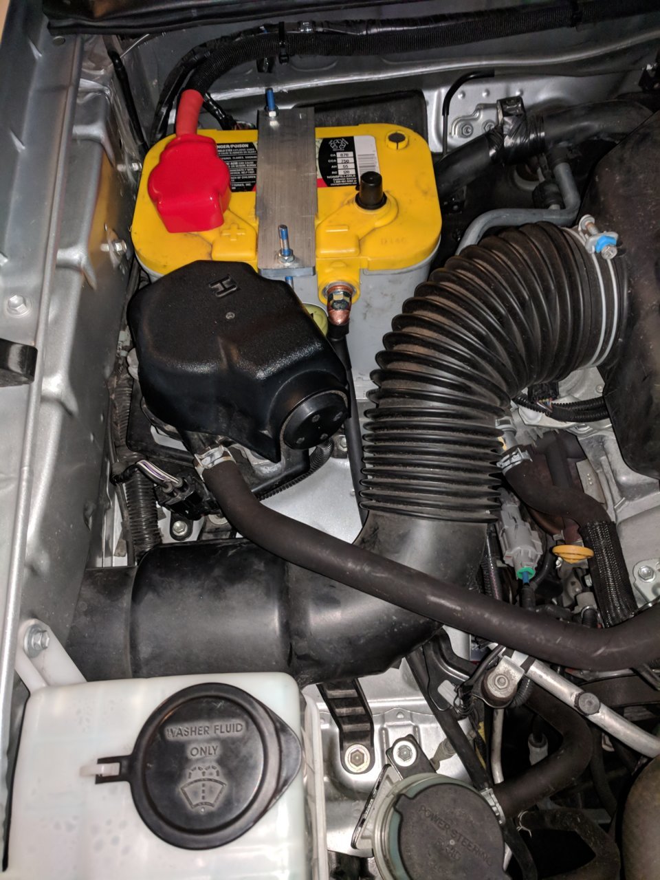

    About halfway done...
    Gee looks like I'm late to the party. I was planning on getting a voltage booster but didn't want to pay for the shipping...:anonymous:
    Guess I’ll post some battery photos
    This is a 27f in a 2gen
    ca08tacoma, ricco333, Aws123 and 3 others like this.

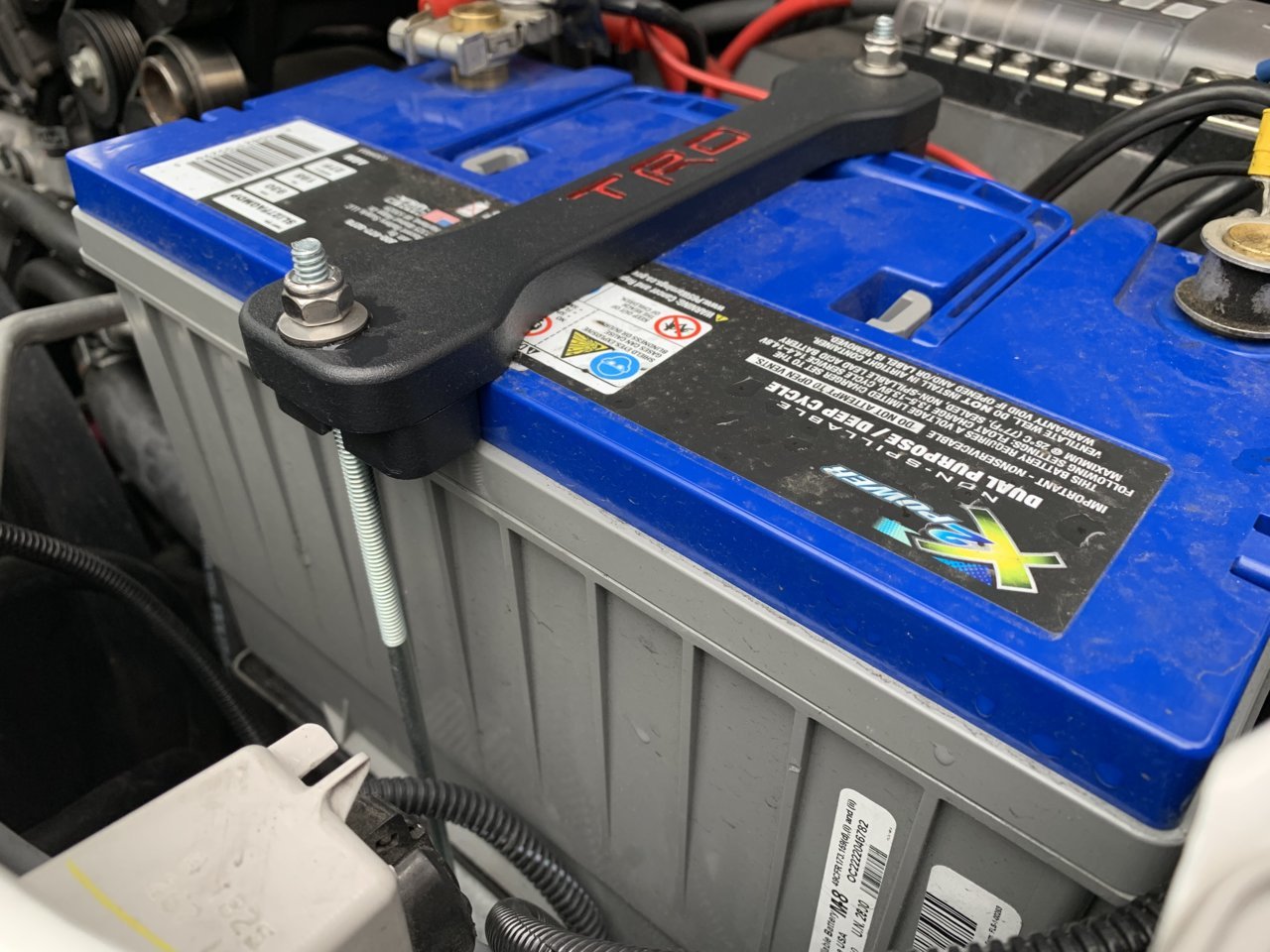

    I was going to pick up one of these for my 27F. They are adjustable for the NorthStars top to provide a snug fit.
    Edit: here is the link:
    https://www.tacomaworld.com/threads/3rd-gen-trd-battery-hold-downs.574494/

    How did you determine the C/B Amperage? or was it a kit?

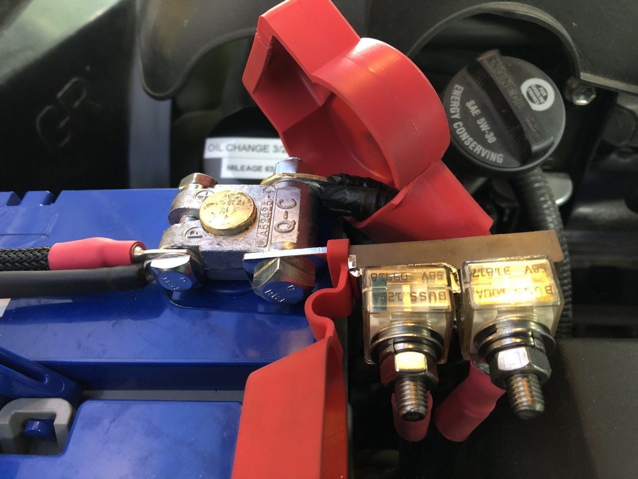

    Here is what I set up but took it out, don't like the setup, I am adding a disconnect for the winch and want something different for lights and power

    After reading I was freaked out, quickly disconnected everything and am re thinking my plan.

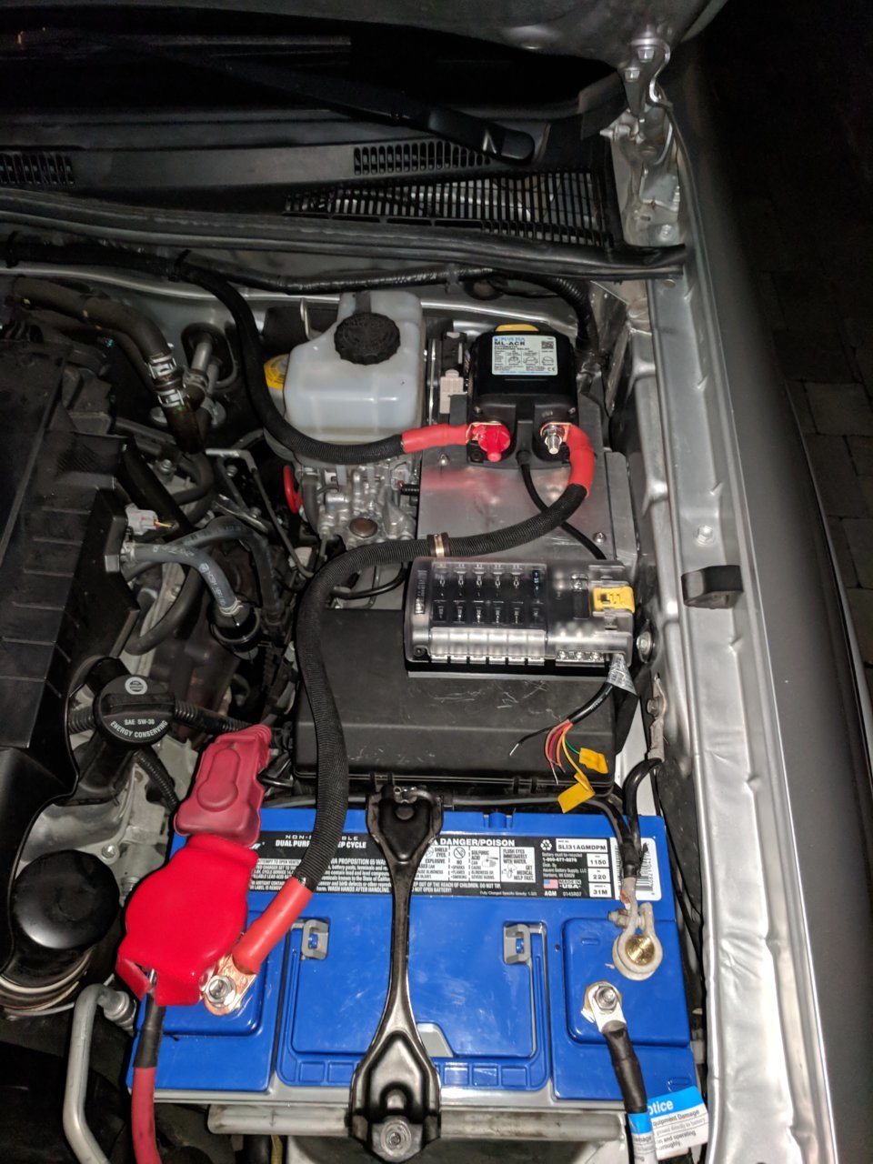

    Are you asking about the fuse blocks on the battery terminal? They are there to protect the positive lines. One is for my switch pro (125amp) other is a blue sea fuse block (100amp) I got most of the stuff from Amazon. The amperage was determined from the max allowed.
    I researched and borrowed ideas from tons of other builds.
    https://www.tacomaworld.com/threads...s-for-electrical-accessories-and-more.518174/
    I did use @Mr.PowerTrays to make my custom length battery cables. Which was great because I have 4 different stud sizes...

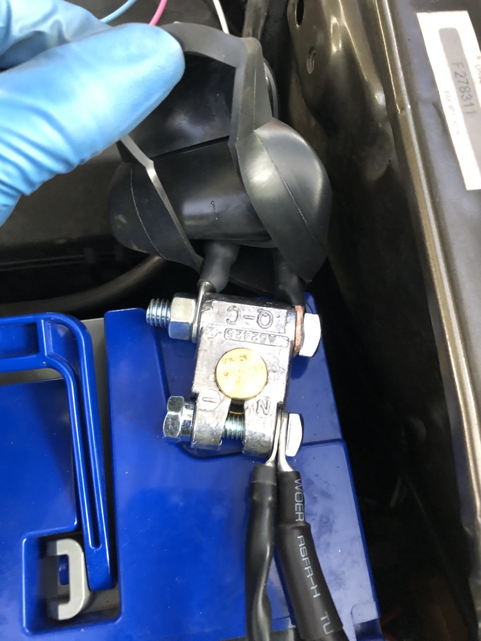

  20. Apr 14, 2019 at 11:11 PM
    #40
    TireFire
    TireFire Superunknown Member
    Feb 6, 2016
    #177349
    7,666
    Olympic Peninsula
    WTF happened there? Cables rubbed thru and shorted??
    Regarding the voltage booster I found a diode from a GM at O’Reilly for about $4 that fits into the Alt-S slot and raises voltage about 0.6V.
    My truck isn’t driven daily. I pop that sucker in after camping, wheeling, winching etc. and switch back when I get home. I also have a Duralast so if that ever goes belly up autozone will gimme a new one for free
