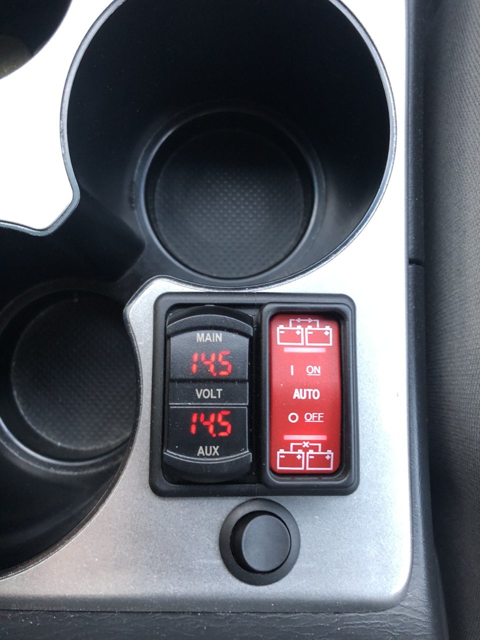

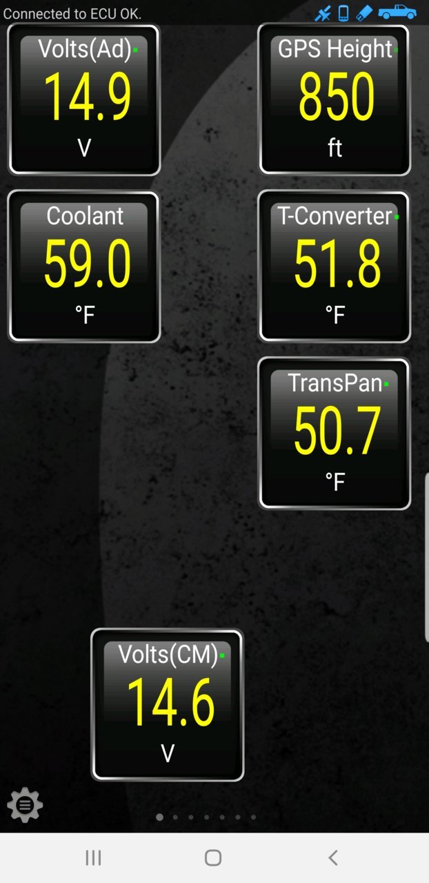

    This morning at first startup. Outside temperature was 41°.

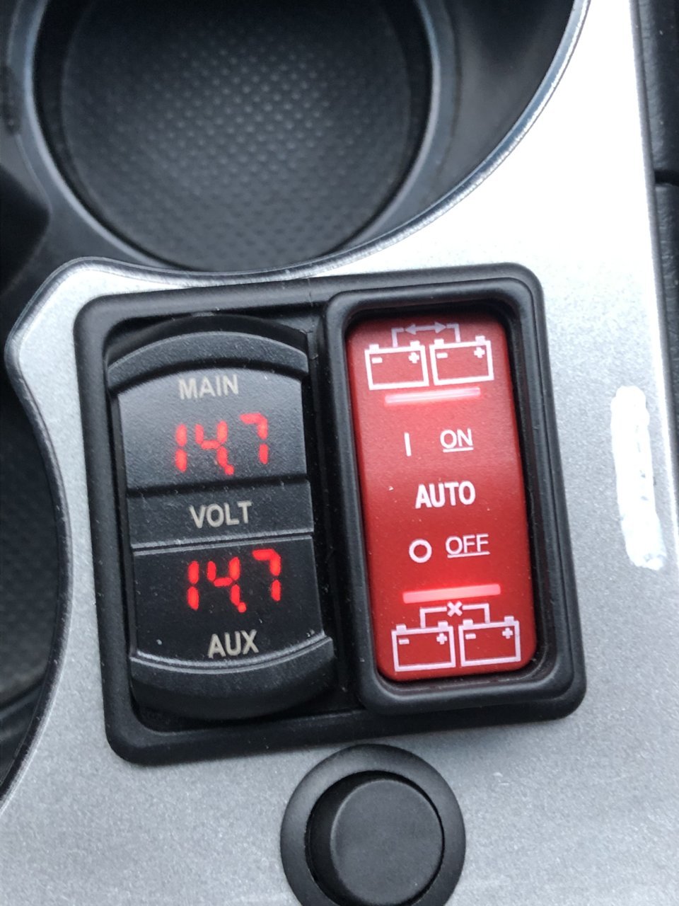

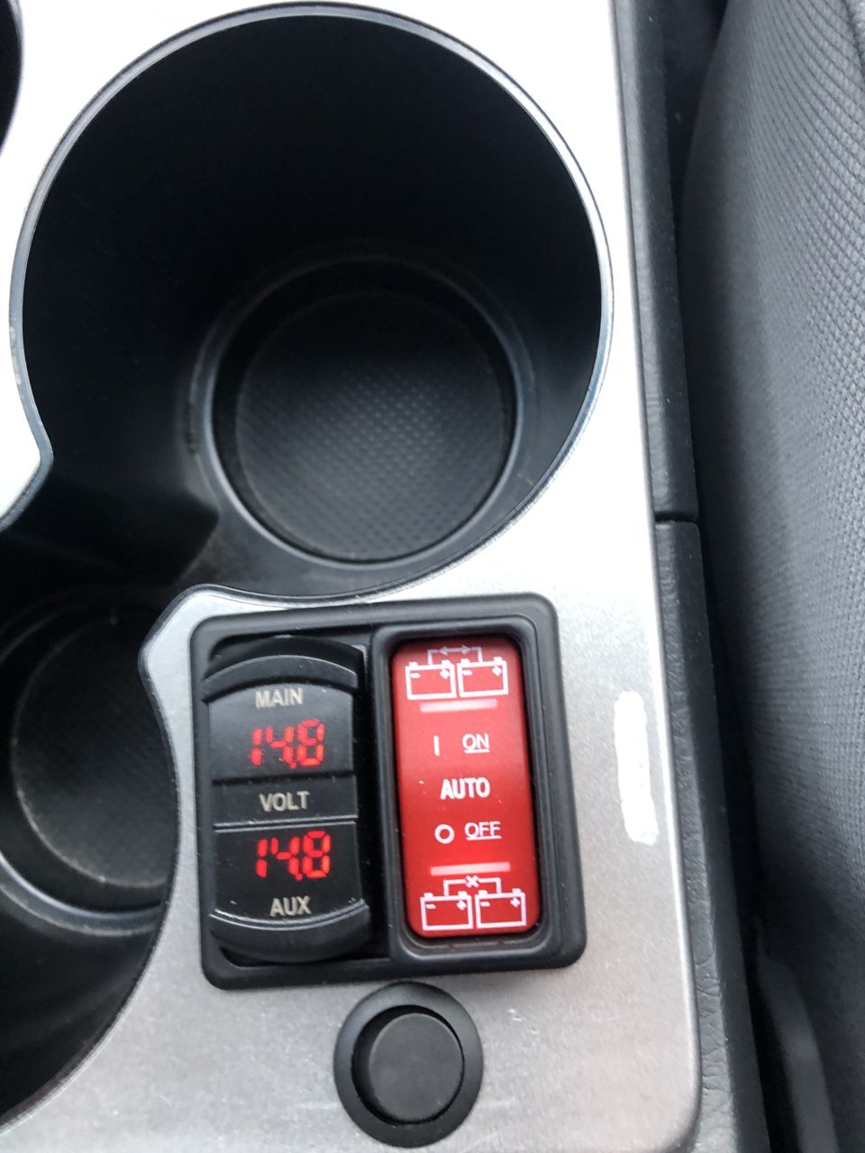

    Got my 0.5v booster put in. Seems to have done the trick. Here are some pictures of the increased voltage. I hope everything seems to be in the appropriate range. I have 2 Odyssey group 35 (35-PC1400) batteries. I can’t see the cycle service on the top of the batteries so I hope it’s like the one in your OP.
    Initial cold start up- 14.7v
    Cruising on the highway- 14.8v
    Idling in parking lot 20mins later- 14.5v

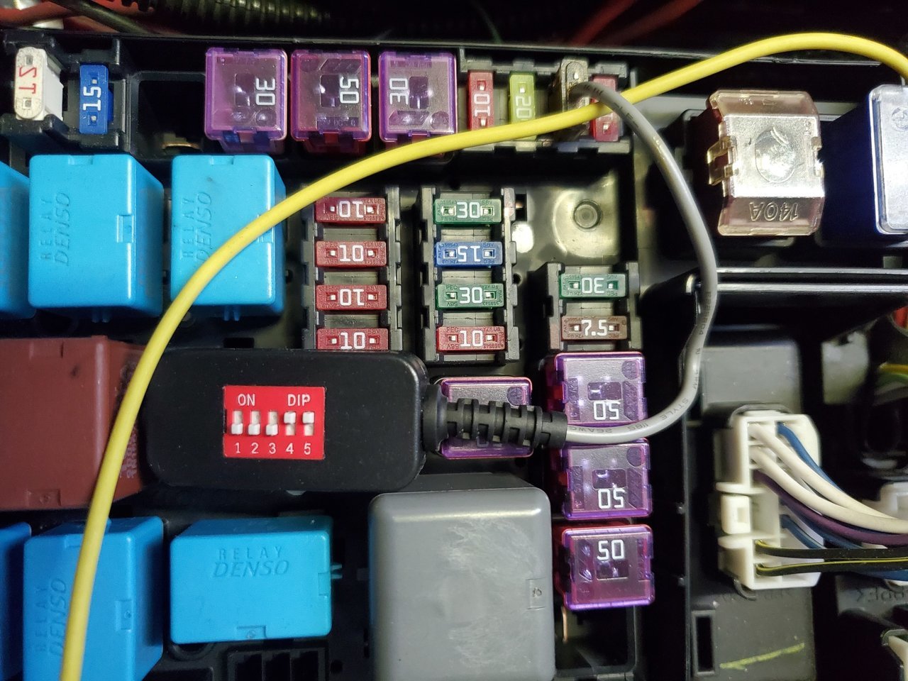

    As pictured in the first post (1, 2, & 3 Down, 4 & 5 Up).

    Thanks, so that setting would increase charging by .6 volts?

    The charging voltage would be the same regardless of the battery correct? I was thinking of putting the bluetooth monitor on my current battery so I could get the right booster ordered and install it with a new AGM.

    I belive that's correct but, what I can say with certainty is voltage ranges from ~14.7V (on cold start) to ~13.6V (when warmed-up).

    That is correct. I'd likely opt for the 0.5v booster, the 0.6v is pushing it right to the edge.
