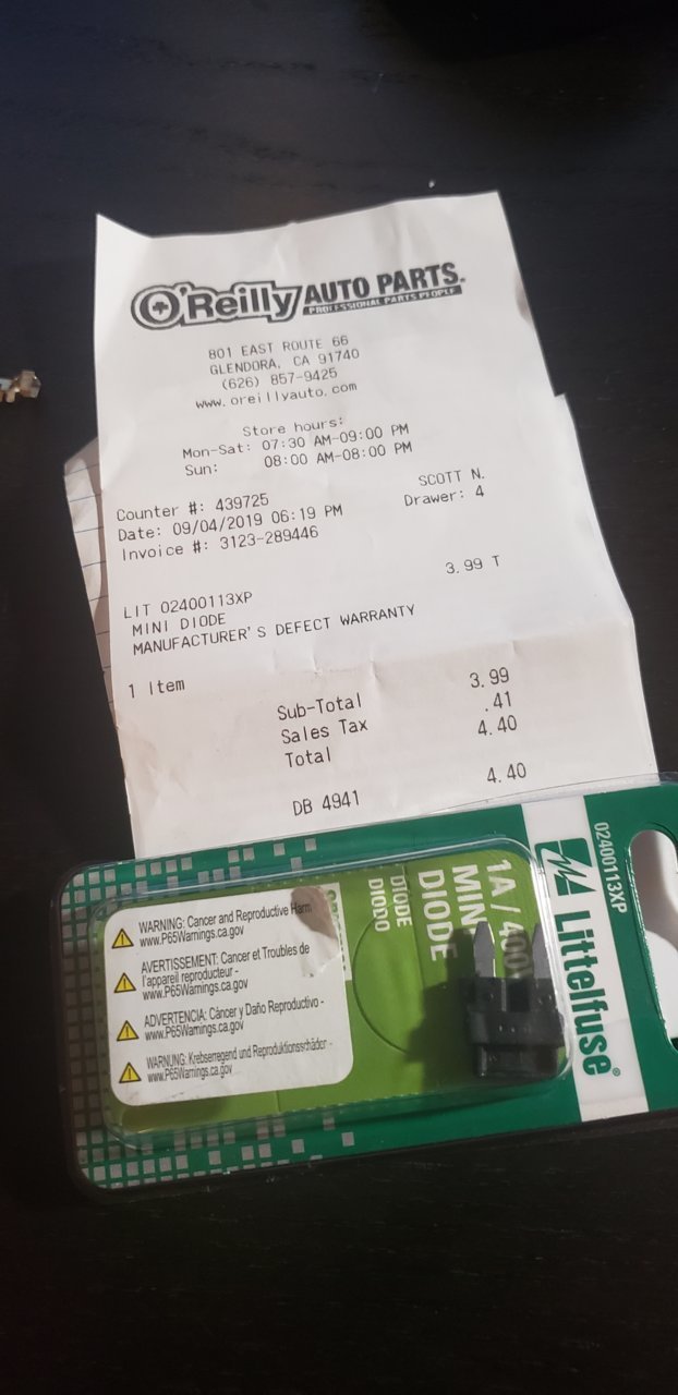

    O’Reilly’s sells them for like $4 each. You can order online and pick up in store. I bought 2 that way so I have a spare that I can tuck away in case it fails on the road.

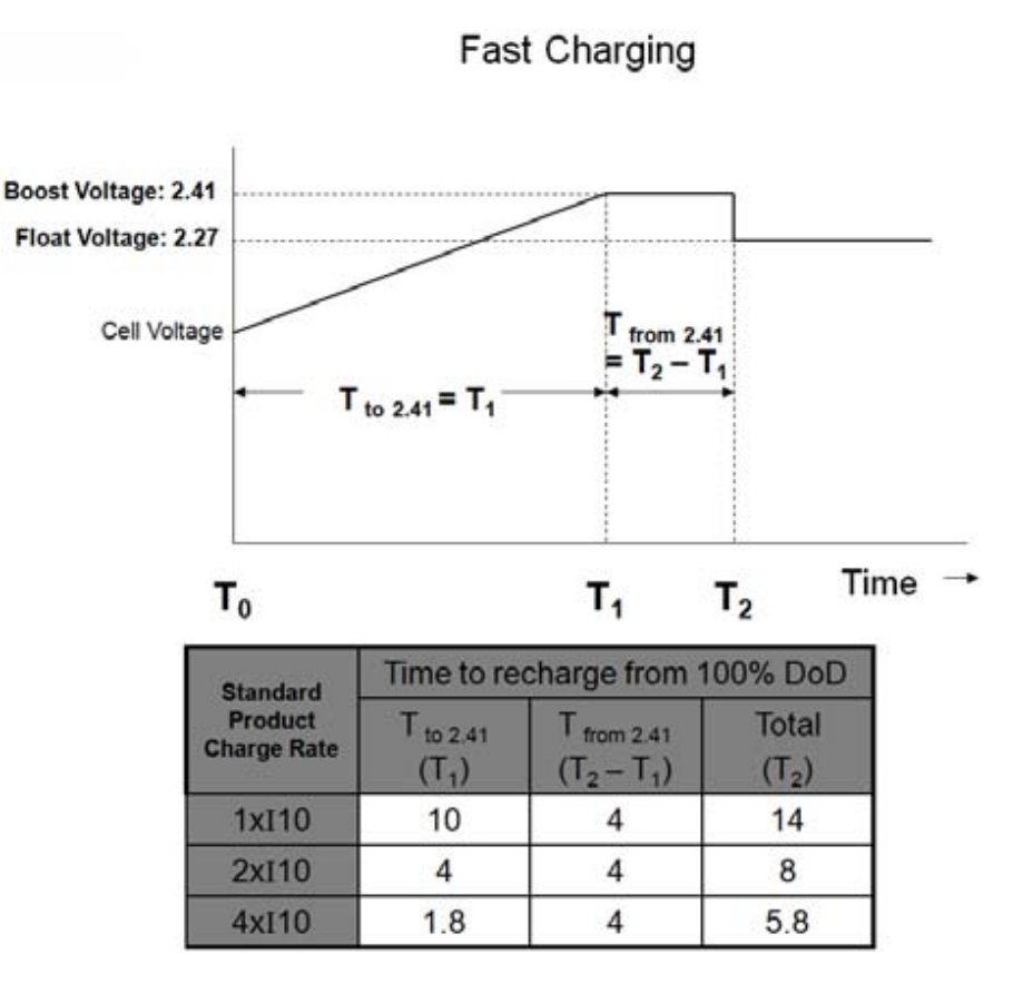

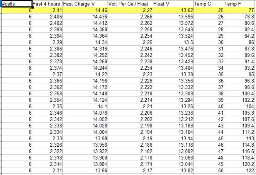

    Worked out a solution of charging at the 14.4v (diode engaged for a duration of time (programmable to whatever I want it to be), then falling back to the stock voltage for trickle charging for the longer duration trip or until I start my vehicle again. For now I have the charge at 14.4v for 30 minutes, then cut out the diode for the lower 13.7v
    Have a question about how much time would need to be at 14.4 volts to recover the energy required to start the vehicle, guessing at the 30 minutes for now would be ok?
    also going to use an electric cooler on the second battery overnight or use it on both batteries at the same time, and have the LVD disconnect the always on fuse box at 12.2v though if I can trick the LVD to cut the always on circuits at 12.4/12.5v it would be better as I had a problem starting my truck at 12.4v a few weeks back but it was because I was not using my truck as much. Now I am going to keep it on a trickle or solar panel it when I get a roof rack.

    I've been using this guy for a few years now without issue.
    $3.99 at the autoparts store.
