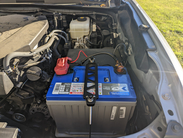

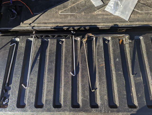

    Added an aftermarket battery tie down since the OEM one doesn't fit quite right.
    ARANOVA Battery tie down with 1x 8" J hook & 1x 10" J hook. You could probably just get 2x 10" J hooks and cut one down or leave it.
