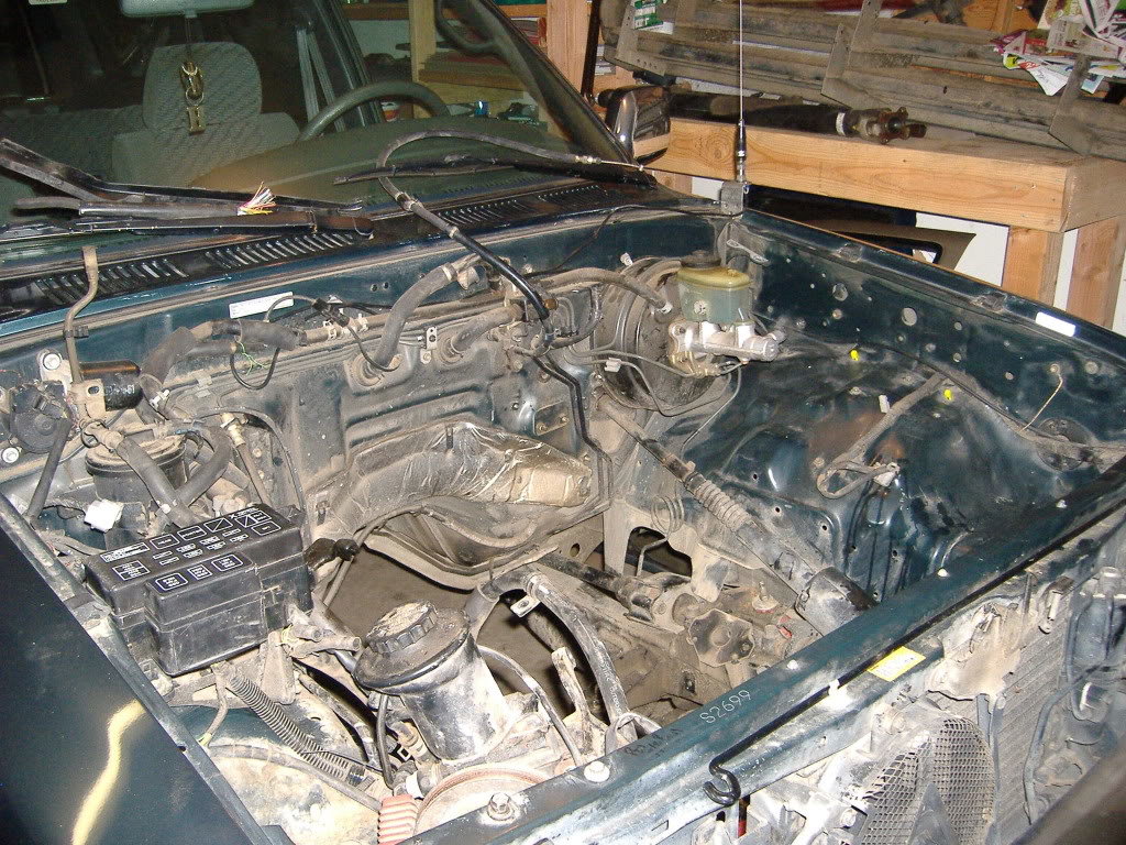

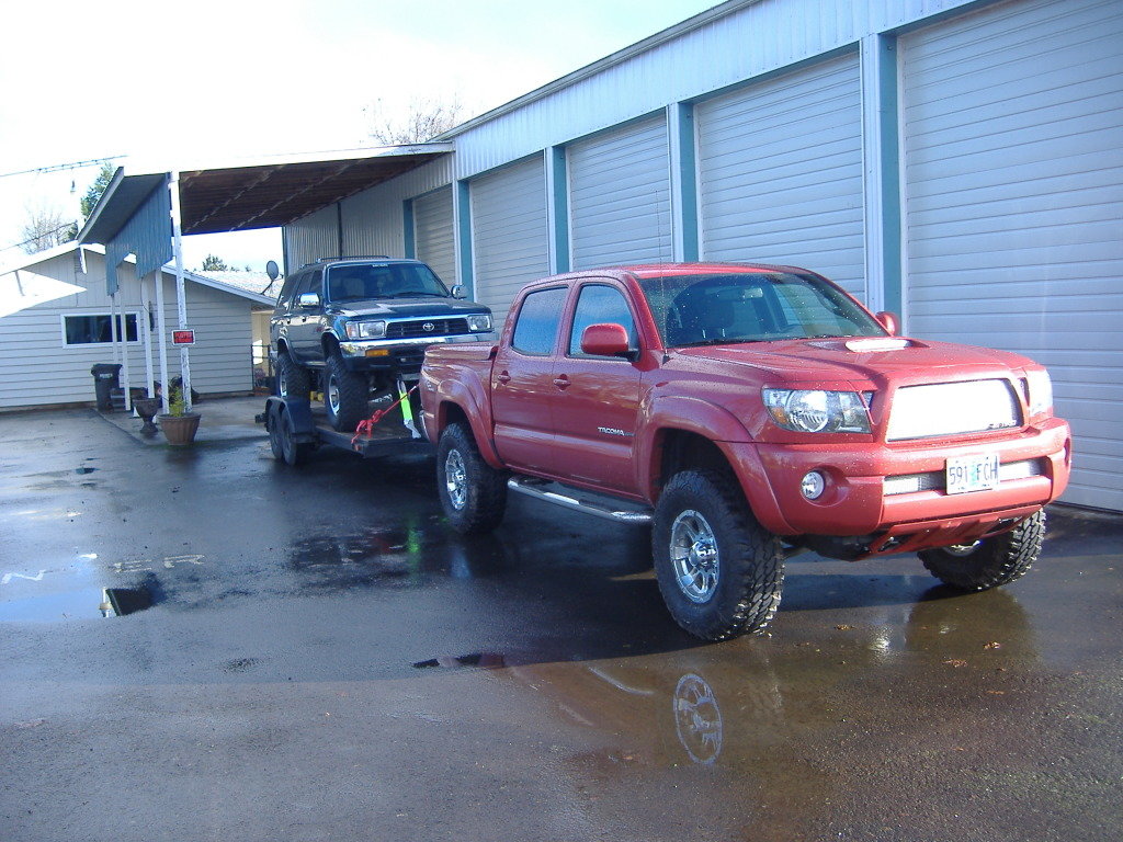

    Started with this kinda. It was all stock when I actually got it. I added the lift and tires.
    Then blew the 3.0 up!!!!

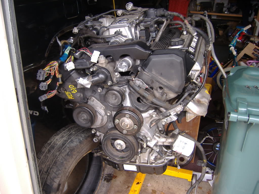

    Decided I didn't want to go back with another pathetic excuse of an engine. So I bought this

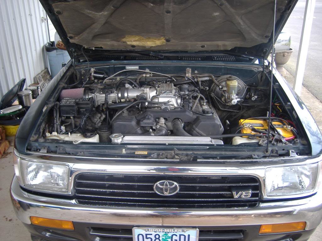

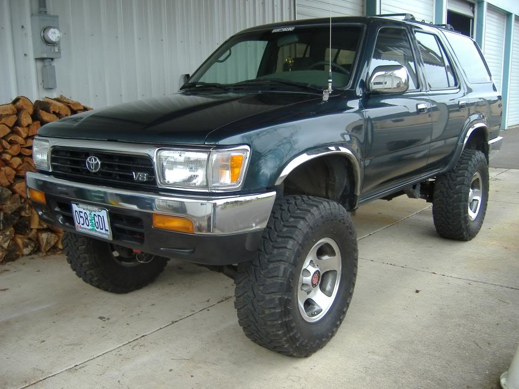

    All is done now. It is all wired up to factory cluster. Alum radiator with flex a lite fan. duel exhaust so it can breath. Kept the R150F 5 speed.

    Forgot to add that its got an 85 straight axle sitting on the shop floor waiting to go under it too!

    Thats bad ass man. Don't see this everyday. Looks sweet.
    Can't wait to see this.

    ^^^ x2 nice truck. I'd love to swap a v8 in mine...someday maybe.

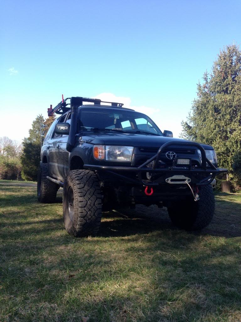

    So after a very very long wait and two different fabricators, I finally have my bumper finished!
    Anb Custom Fabrication did a killer job on it and I am impressed! Plus he had it finished in no time! Here are the specs on it... 1-3/4DOM sides, 1-1/4DOM braces, 1-1/2" ERW over the grill. 3/8" winch plate, clevis and bumper mount made on one piece of 1/2" Steel, 3/16" on the rest. It weighs almost 80lbs.

    Very unique, definitely have not seen anything like this before.

    That is funny cause I actually just saw that the other day when I was butting around the interweb. Cool ass design for sure though
