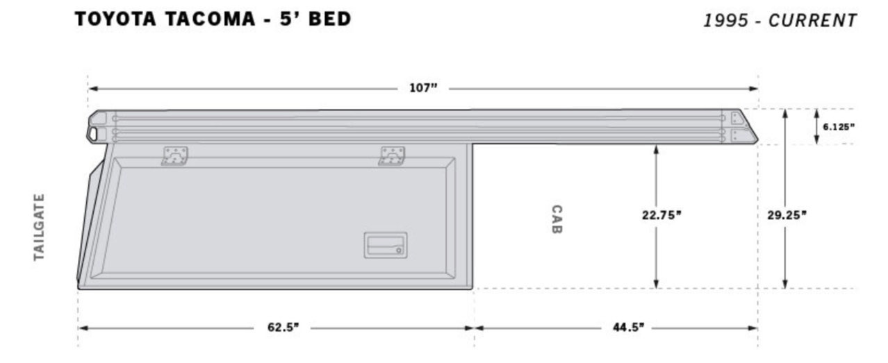

    Just got the notice production has started on my X1, woo hoo! I've got a 2nd gen short bed 4 door Tacoma with a Front Runner Slimline II low profile rack installed. It's about 3" above the roof (measured at the rear center). Will the X1 clear this ok?
    I've Googled and searched this thread, I see others have modified racks to accommodate the X1 but not seen this particular rack addressed.
    I also asked Super Pacific, they want me to remove the rack before install. I'd rather not unless it is really necessary.
    Thoughts?

    Personally I would want 1 1/2-2” of clearance (refer to the 22.75” dimension). JMO

    ridgewalker, thanks for the drawing. Looks like it isn't even close to being high enough. I measure about 24" from the bed rail to the top of the rack.
    I'll take the rack off and see if I can modify it to keep just the front part after the the X1 is installed.

    Doubt it. That will have to come off. With a Prinsu for example it’s 1/2” off and we trimmed off 1 1/2” for most folks. Not as easy with the front runner. even if it squeezes on it will certainly hit. If you to keep that style then looking at a shortened one of they make it for one of the other wedge setups

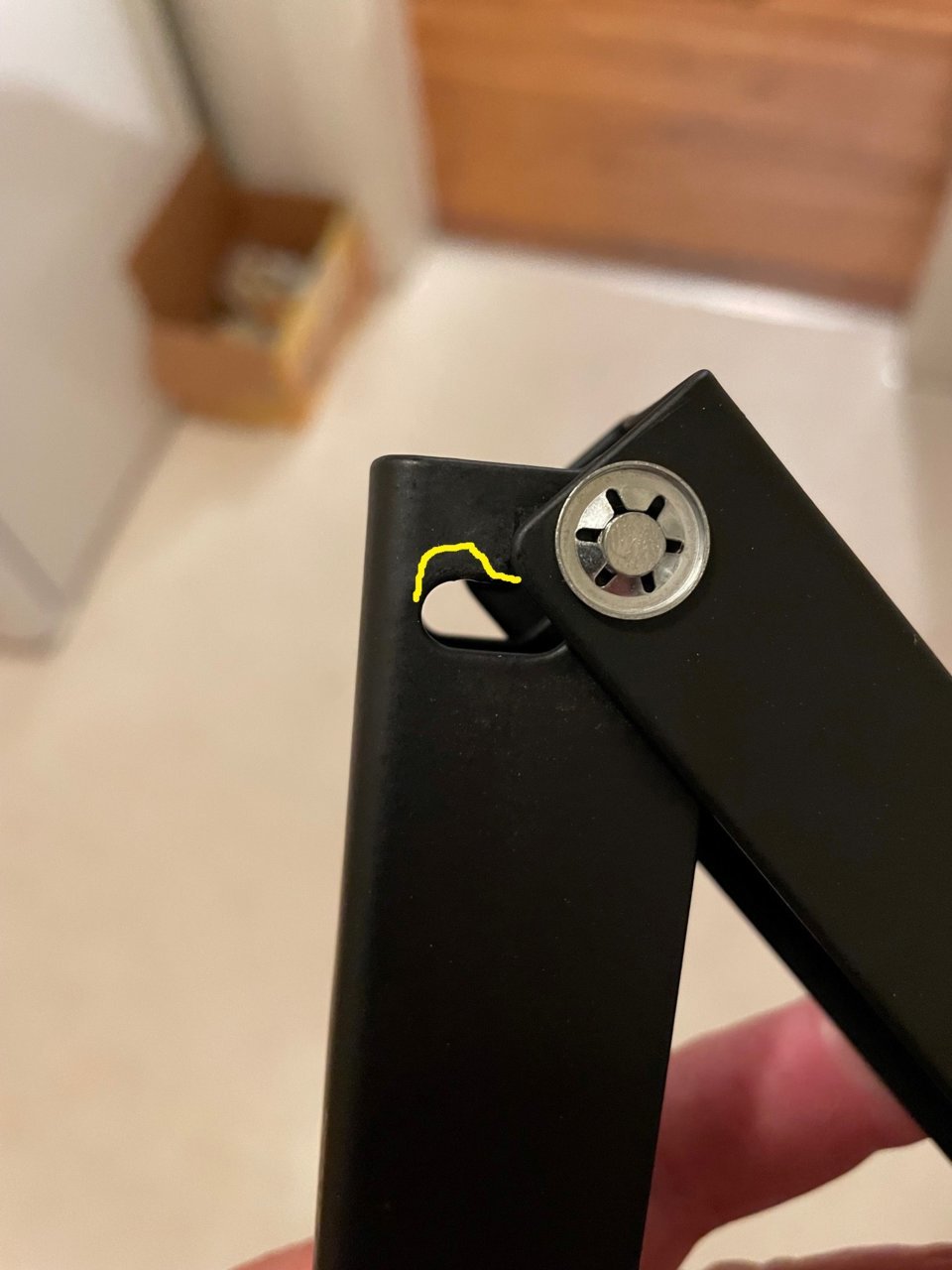

    @DavidS Got a set of those Welland brackets. Seems like if you file out a bit of the top portion of the slide section you could get it to sit at a 90. See yellow line on pic. shelf bracket.jpg

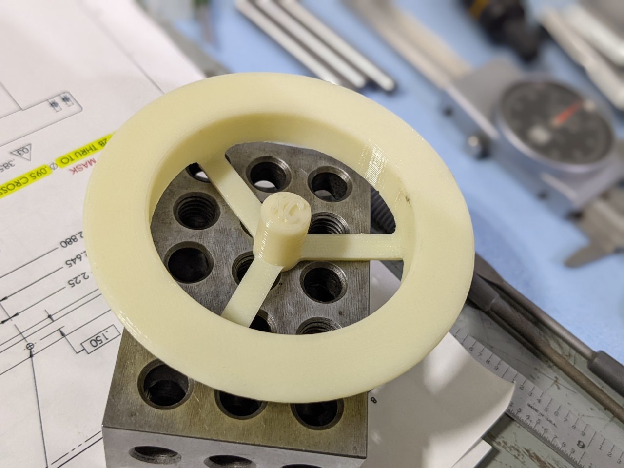

    @gnardoggie I came up with these years ago when the Cyclones first came out. Obviously for the v1 design. Kinda lost interest in them and never actually ran any Cyclones.. but I have the files for them still if you or anyone is interested. They are flush mounts. I'd be curious what you come up with. I think I'm just going to run some S2's out back.. but always like to see other stuff. :thumbsup:

    Will do - I have a bunch of flat cut stuff on order then i plan on tinkering with the optimal bend/positioning for both an inside and outside option if all goes as planned.

    That would definitely work, but if you messed up, you are only out $10. Aren't they a lot stouter than you imagined?

    Much stronger than I anticipated. If I go this route I may change out that crappy pin with a true bolt n nut setup.
