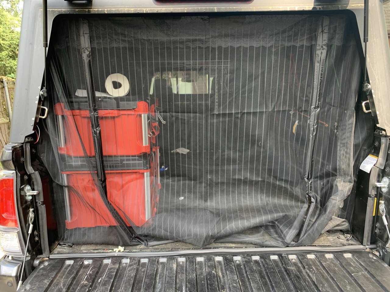

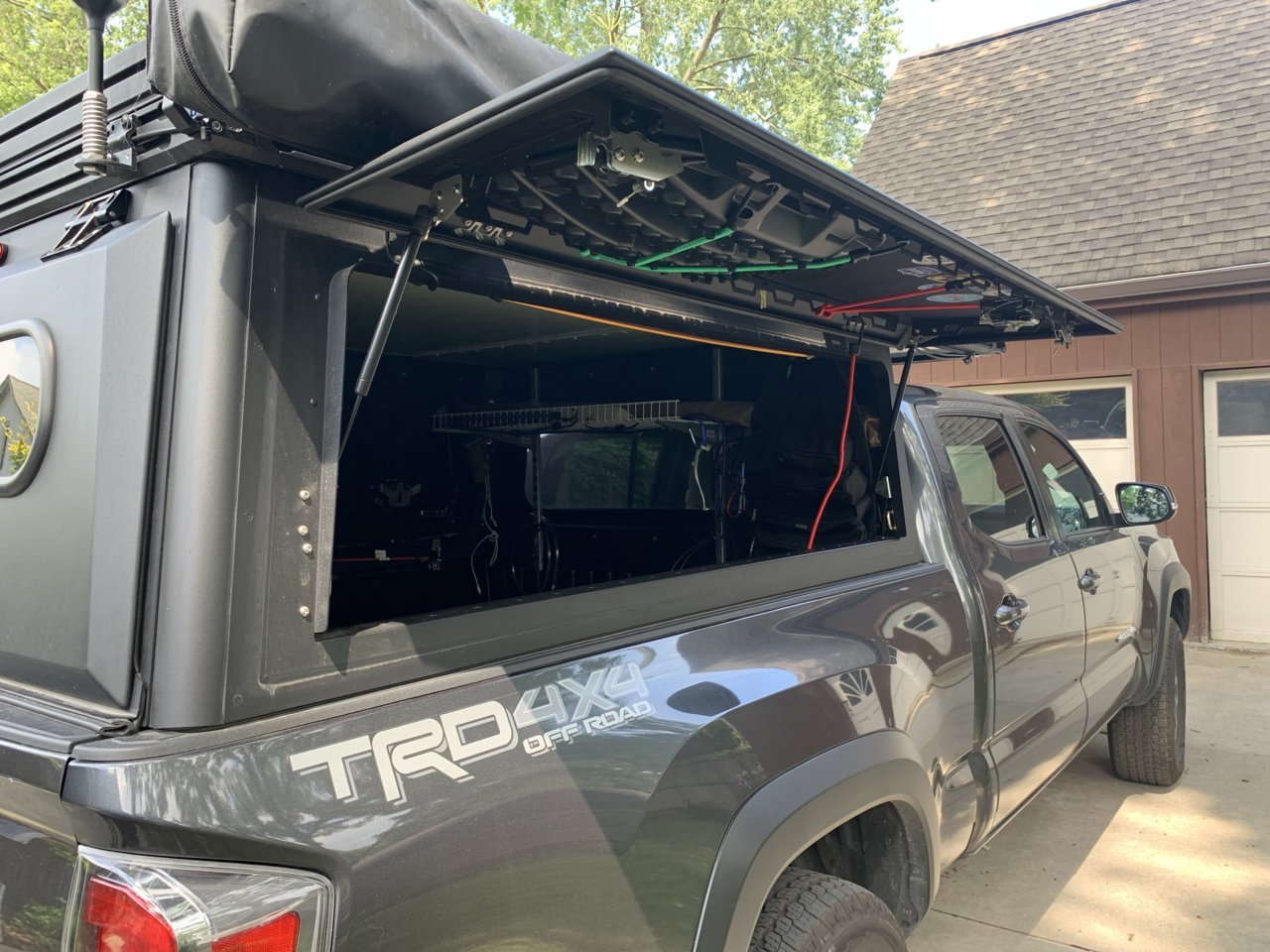

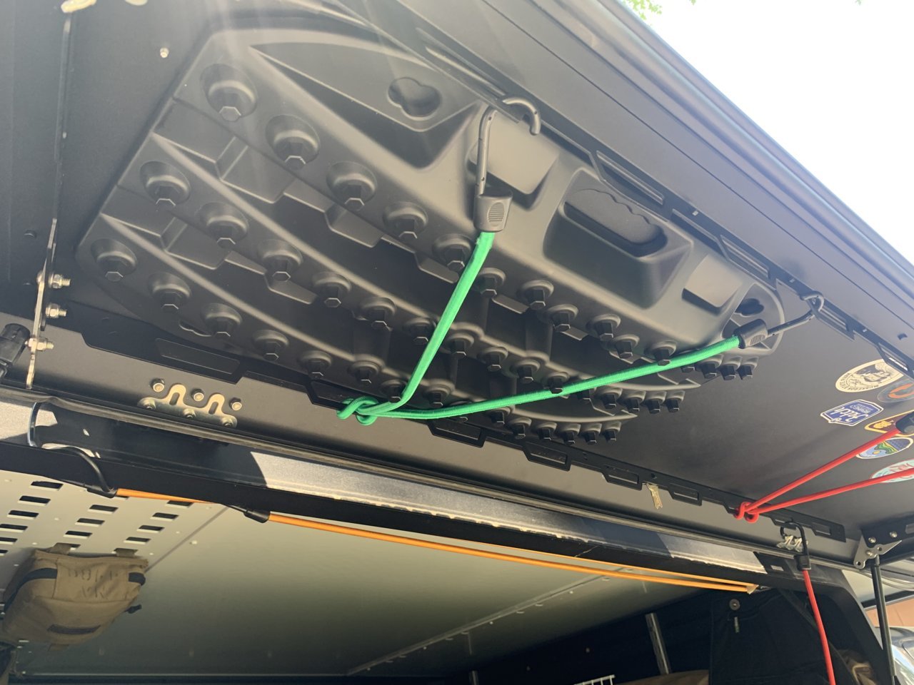

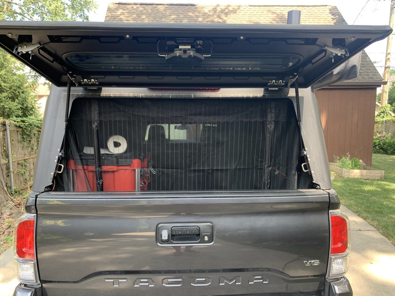

    Heading out for 10 day loop around Lake Superior. Rigged up a screen. It has two magnetic seams which will allow me to get into the fridge and chuck box. It has Velcro around the perimeter and came with a roll of sticky backed Velcro. I just stuck it all around the inside and let it drape down. I cut about 2 feet off the length because it’s for a sliding patio door. I may cut more off. Since it’s wider than the SP I folded it over on race end after attaching the center over the door. I also bungeed up two short traction boards on Det the side doors.

    Just to clarify it’s Velcroed down both sides and loose along the bottom

    I’ve added screens to a 4runner I camped in/hunted out of for a couple seasons. Works great overall, but still got a few bugs around the edges. I read about permethrin treatment to deter/kill bugs on outdoor clothes, and decided to try it in my screens. It made a noticeable difference.

    I have also used permethrin on my outdoor clothes, around outside doors, on screen doors and windows. Seemed to work pretty well. It would certainly be worth a try on your screen Pagan220. Your screen looks like an excellent idea! If it works in the rear, it should work on the sides as well.
    Might give this a try myself! Mosquitoes love me…I HATE THEM!
