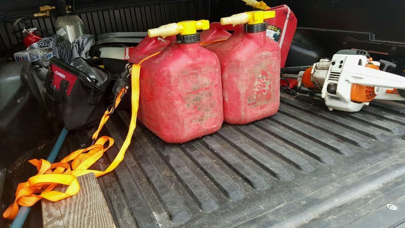

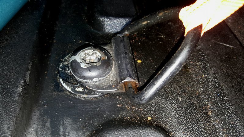

    Install d-rings to to bed bolts on the floor of the bed. The bolts go to the frame and will alow you to crank the bike/atv suspension down to where the bike doesn't move at all during transit.
    https://www.tacomaworld.com/threads/installed-d-rings-in-the-bed-pics.28533/
    Amazon has 10 packs of 1000lb working/ 3klbs break strength rings for <20$, but the dodge van d-rings are plug and play, more expensive.
    https://www.amazon.com/dp/B01CGXSOG0/ref=twister_B01N26ISE6?_encoding=UTF8&psc=1

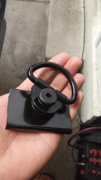

    Toyota Part:pT785-35054

    Thanks for the part number but that is for the black rings at the rear of the bed on the floor. I had considered those at $25/pair but was really just looking for the silver one. Unless I cut my bed mat and install this on the floor, I dont the shape of the front wall will allow for that rear backing plate to install.

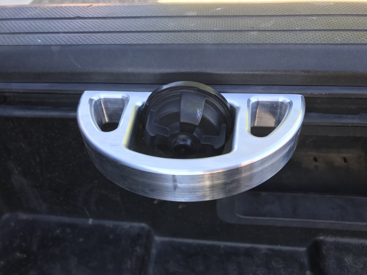

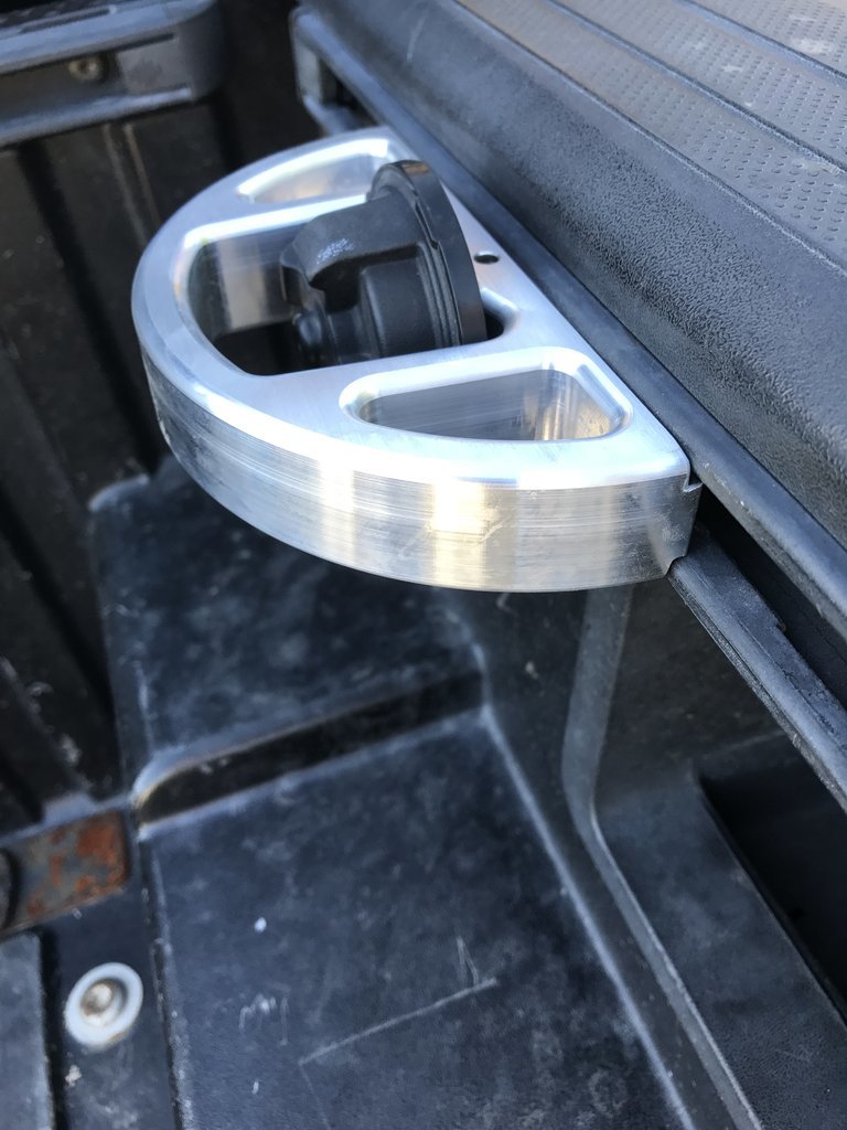

    6061 T6 bed cleats. Upgrade your payload capacity in style. Fits stock railing and hardware

    That's slick looking but the weak point is the flexing of the bed at the front rail. The bed flexes before the cleat.

    the reason i made these is because my dirtbike fell out of my truck twice. Both times the cleat broke. This is a fix for that. Ive heard of cleats breaking not railing pulling out of bedsides.
