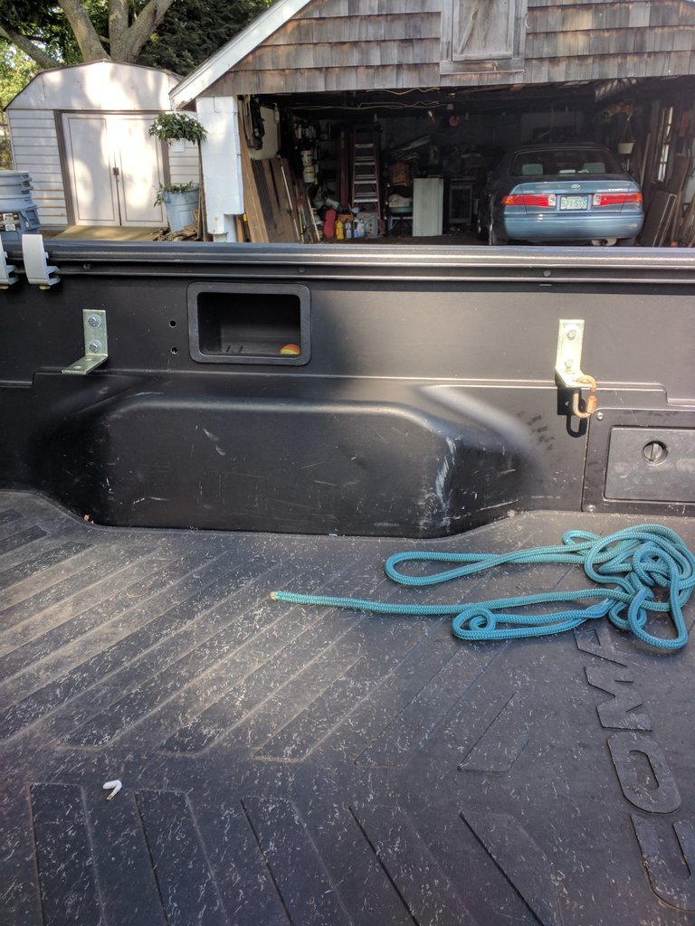

    I'm just saying they are nice. But, no, it's not what I want. The corner tie downs wont help me, i need a tie down in the middle. The one that spans the entire front rail and connects to the side rail is good but a) out of stock and b) prohibitively expensive to ship to Hawaii.
    So does anyone know the part number of the simple cheap D ring I originally asked for :) ?

    Post# 306. Below the 1st pic is the Dodge part number. I just bought them through my local Dodge dealer.

    INNER PANEL HOOK 66312-0C010
    Edit: the picture shows the D-ring but it's the right part number. The oem d-rings are referred to as 'rope hook', this one is referred to as 'inner panel hook'.

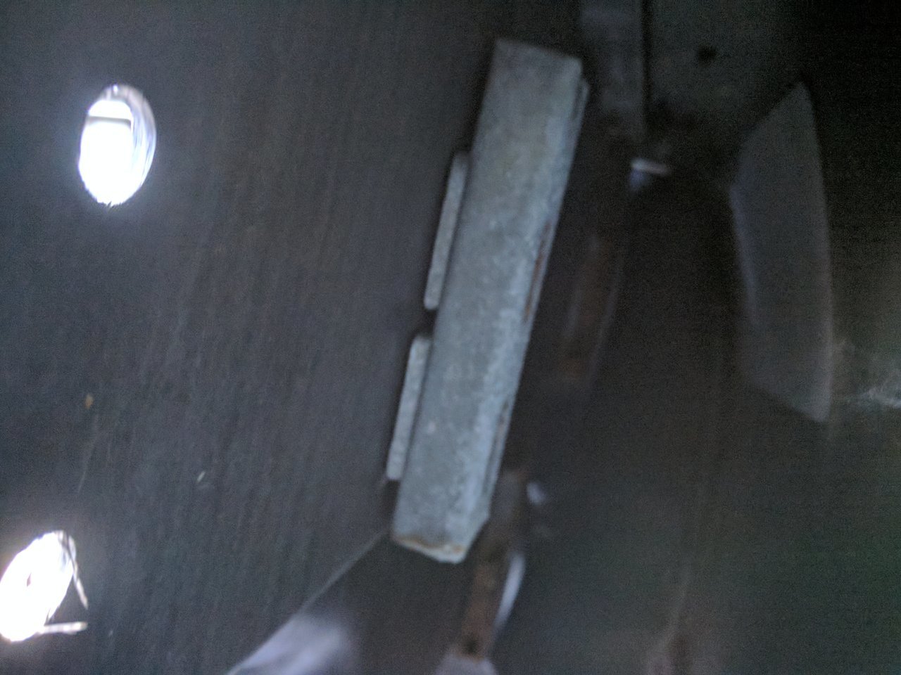

    in reference to that plate that comes with the oem d-rings
    see below

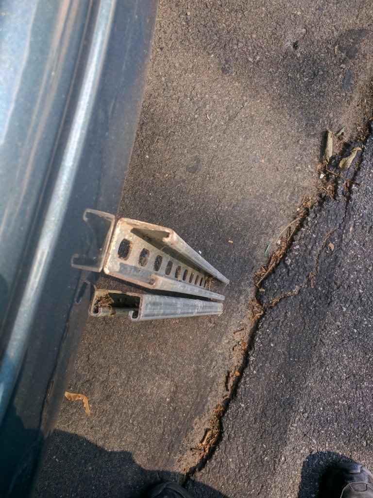

    Take some of this stuff and put it side to side under the bed. Those holes are on 2"center and you could install several d rings and bolt to that. Being long, it also distributes the tension across a greater surface area.
    Kindorf, unistrut, it has several names. It is usually, 7/8"or 1 5/8"x 1 5/8" in 10 foot lengths. They make nuts with springs that fit in the strut too. I have pieces behind these L brackets.
