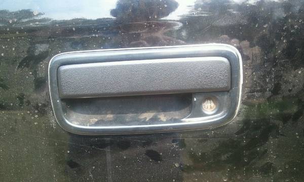

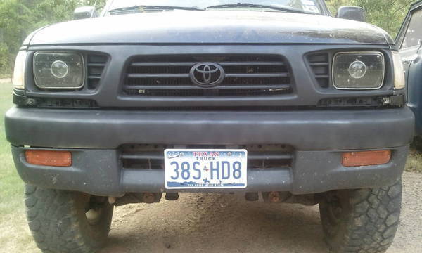

    Here are some pics
    Also you can see that the passenger side handle came out smooth, while the driver side cam out rough. So always make sure you shake the can for a looong time cause I apparently I didn't lol

    Yeah I did both bumpers and grille in two hours :eek: so there's my problem! I think I'll do some touch up and the mirrors Saturday and see how it goes. Plus I was painting the grille and emblem on the ground, so it was hard to see all the angles I had missed.
